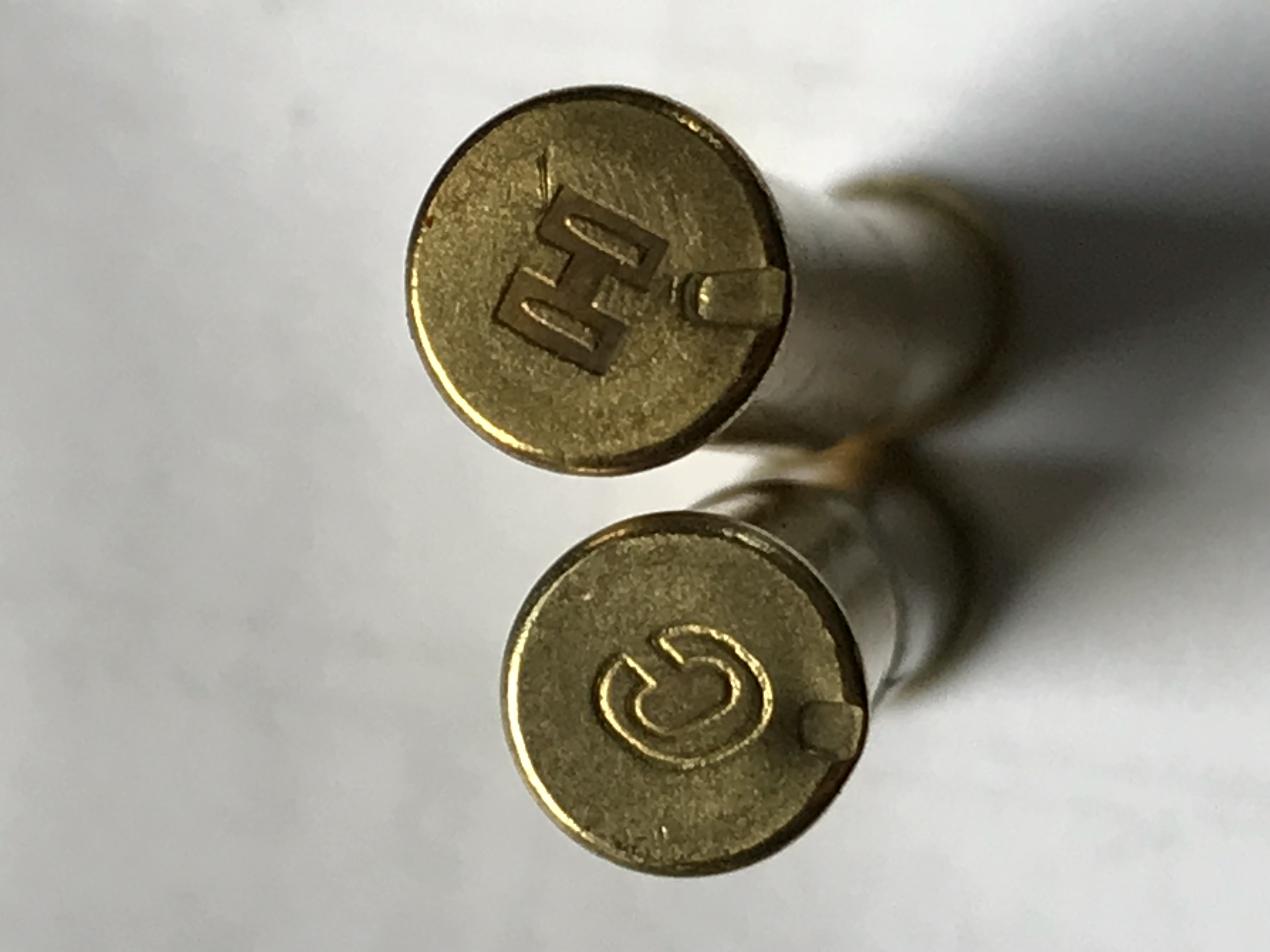

Post by Cooper » 08 Feb 2018, 6:16 pm
Left cci 22lr case out of cz452, right cz455 Hornady 17hmr case. Can clearly see larger (longer) firing pin striker indent.
Apollo wrote:Sorry but Off Topic...
Firing pin difference for a 22LR/22 Mag/17 HMR... Never heard of it. Maybe someone should tell Sako and CZ with their Switch Barrel Rimfire Rifles... :unknown:
Can confirm that the cz452 and cz455 do have different firing pins. Have no idea if it for 22mag or 17hmr use. Or they just changed the design.
