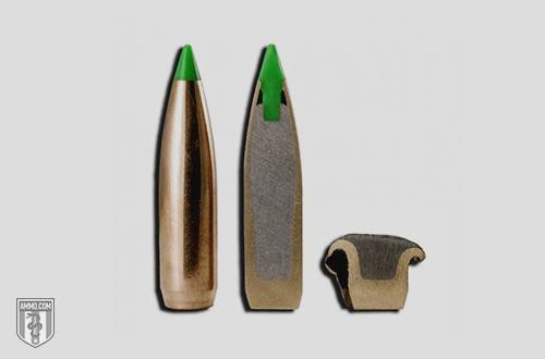

The nosler 140gr ballistic tip from a 7mm-08 at just over 2800 FPS has been the business for fallow (heart/lung shots).
Am I safe assuming they'll be just as good on the larger rusa for side on heart/lung shots?

I see no reason why they wouldn't work. But no personal experience.
140 bal tip.jpg (9.42 KiB) Viewed 3539 times
