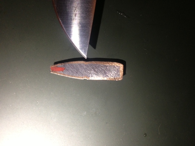

Post by Timb0 » 16 Sep 2014, 7:33 pm
There are quiet a few ballistic tipped projectiles that are neither for target shooting or for varminting.
The Barnes TTSX are a 99% copper projectile ( besides the tip). They have an internal cavity that is about 1/3 of the bullets length, that along with the ballistic tip helps expansion. The bullet usually stops expanding close to the end of the cavity (depending on velocity). The base of the bullet is usually left intact and helps push the expanded bullet though the animals organs. I think due to being made of copper that helps retain a lot of their mass and that helps with penetration.
Noslers ballistic tipped hunting bullets have a thicker jacket then varmint bullets and they go on about how they have bonded the jacket to the lead to control the expansion. I haven't used these much but plenty of people say they are a good thing.
SST's have an copper ring that locks the jacket to the lead and slows down the expansion, shown where the tip of the knife points in the photo. I find them good for general shooting in my .270- pigs, dogs, goats, small and medium deer. They usually punch through goats and smaller sized animals. I have heard of people saying they expand too quick but I think its usually a case of poor shot placement. Gut shooting animals has that messy looking slow death effect.
Although I don't load the Noslers or SST for large deer I would quiet happily use them. Bullets need to expand to do their job efficiently and deer are fairly light skinned.

Post by Octane » 17 Sep 2014, 1:47 pm
Nice job on bisecting the bullet there Timbo.
That knife must have some edge on it :D

Post by Lorgar » 19 Sep 2014, 10:19 am
Timb0 wrote:Noslers ballistic tipped hunting bullets have a thicker jacket then varmint bullets and they go on about how they have bonded the jacket to the lead to control the expansion. I haven't used these much but plenty of people say they are a good thing.
You're confusing Ballistic Tips with Accubonds there. Accubonds have the bonded core and jacket.
