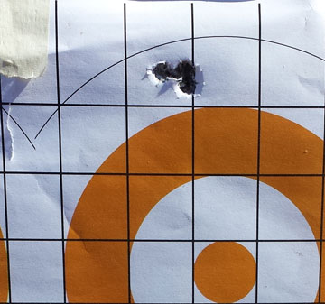

Late to the party on this one. I have just completed my first round of testing with Speer 130grn SPBT part# 1624 this weekend.
Best group of three shots is 0.3" @100m with 40.45 grns of ADI AH2208 COAL 2.730"
Still more work to do but a promising start after changing from Hornady 139grn SST bullets where the best was a 1.0" group, but not consistent.

Late_Starter wrote:Late to the party on this one. I have just completed my first round of testing with Speer 130grn SPBT part# 1624 this weekend.
my t3 was the same , hated 139 sst's , shot the 130 speers into bug holes :thumbsup:
