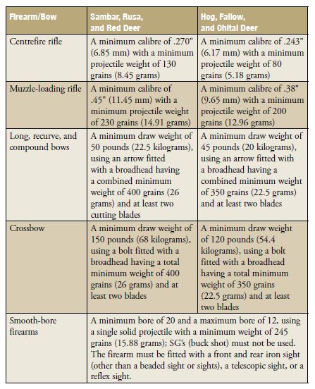

Min Deer Cartridges.JPG (78.3 KiB) Viewed 6679 times
Sooo, the requirement for sambar really locks you into 308. But 30-30 would be legal. But really only a close up round.

My appologies. Just noticed your in NSW. The image i uploaded is for VIc and doesnt apply in NSW. Ithink 243 is ok for NSW.
