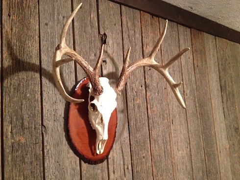

A completed trophy on a plaque that I bought at a local hobby shop
photo (12).JPG (95.55 KiB) Viewed 6914 times

Post by greyghost » 22 Nov 2013, 3:04 pm
keg wrote:Image
Awesome trophy mate.
Jealous... :mrgreen:

Post by The Brass » 27 Nov 2013, 7:47 am
keg wrote:A completed trophy on a plaque that I bought at a local hobby shop.
Kudos mate, that's a great trophy.

Post by brand » 16 Apr 2014, 8:49 am
Thanks for the photos keg.
Gratz on the awesome trophy too :D
