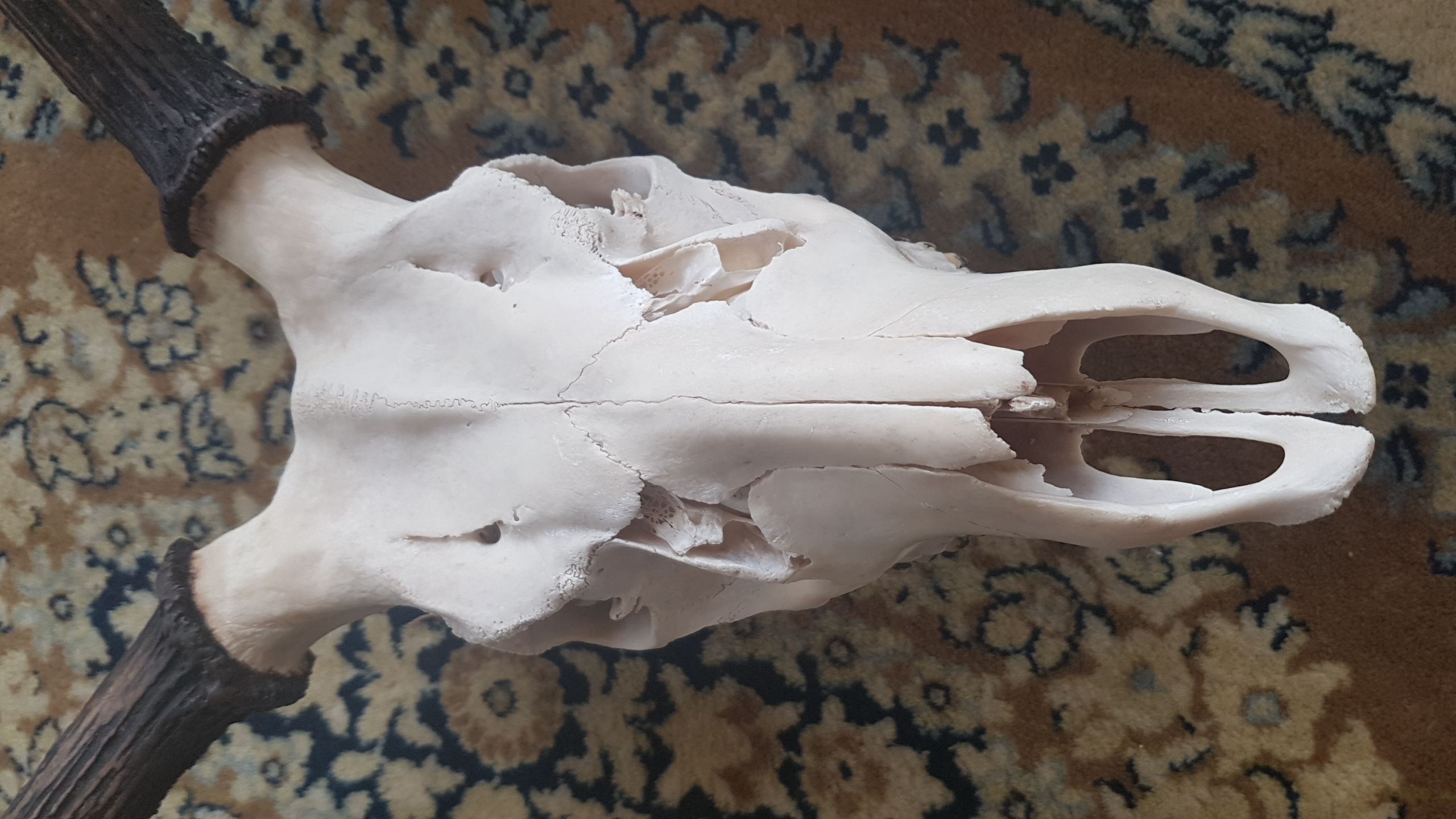

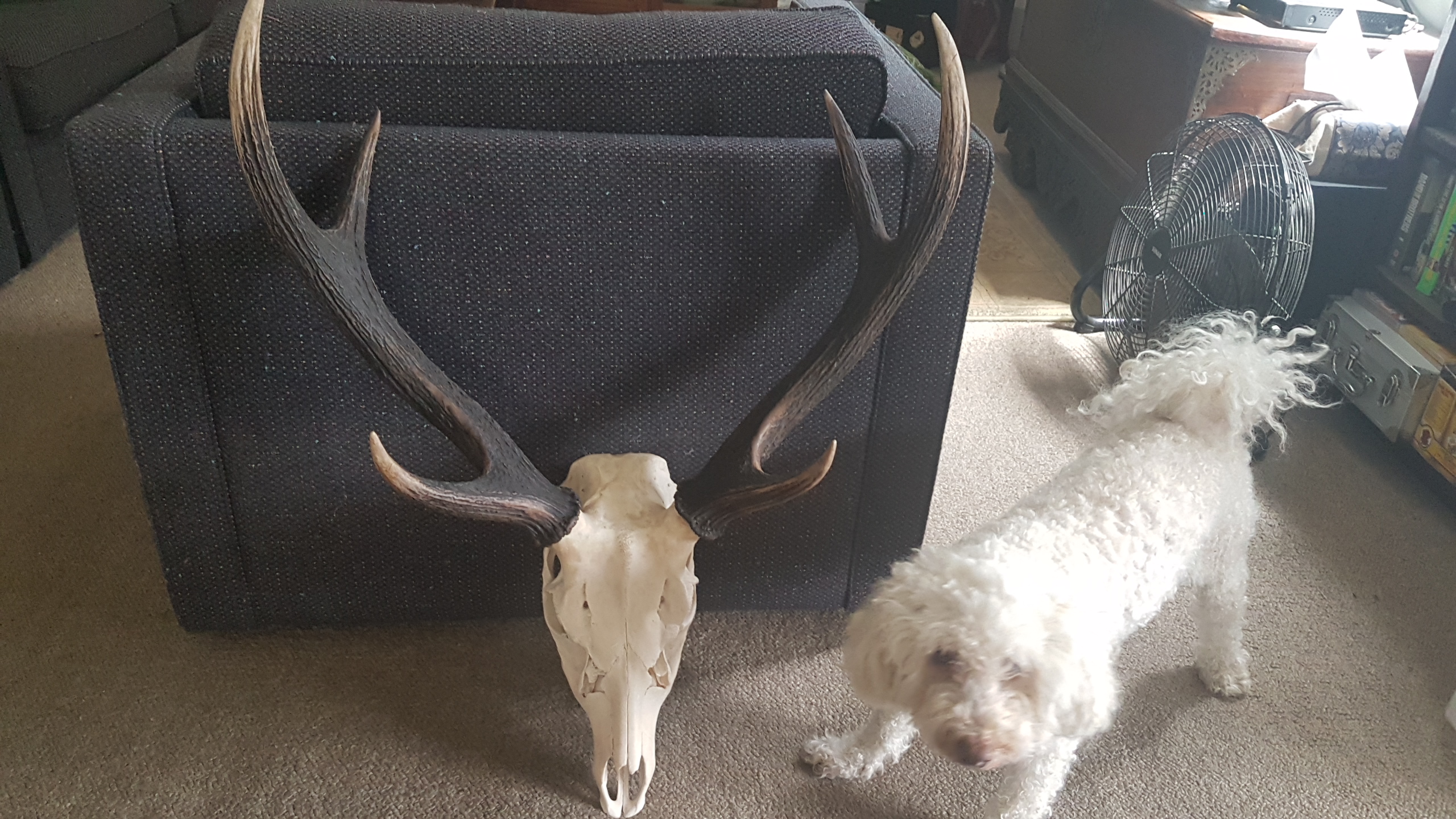

Post by Bigjobss » 11 Dec 2017, 3:59 pm
Lots of stuffing around but worth it, didnt bleach it, dont like the fake looking super white bone.
Used a combo of napisan oxy clean and finish dishwashing detergent. I have a drain cleaning high pressure attachment for normal taps which worked well for the brain etc.
"Hunting" dog for scale!

sungazer wrote:Really nice set. Really symmetrical and well proportioned, looks the goods. Just need a man cave were you will be allowed to put it now :)
Yeh tell me about it! No suprise that the guy with the toy poodle doesnt have a man cave :lol:

:lol: :lol: . It came up nice!!! Like you I don't like that polished white look and hate it when they are sealef and get that yellow thru'em!!
Might have to try the napisan next time :thumbsup: :drinks:
