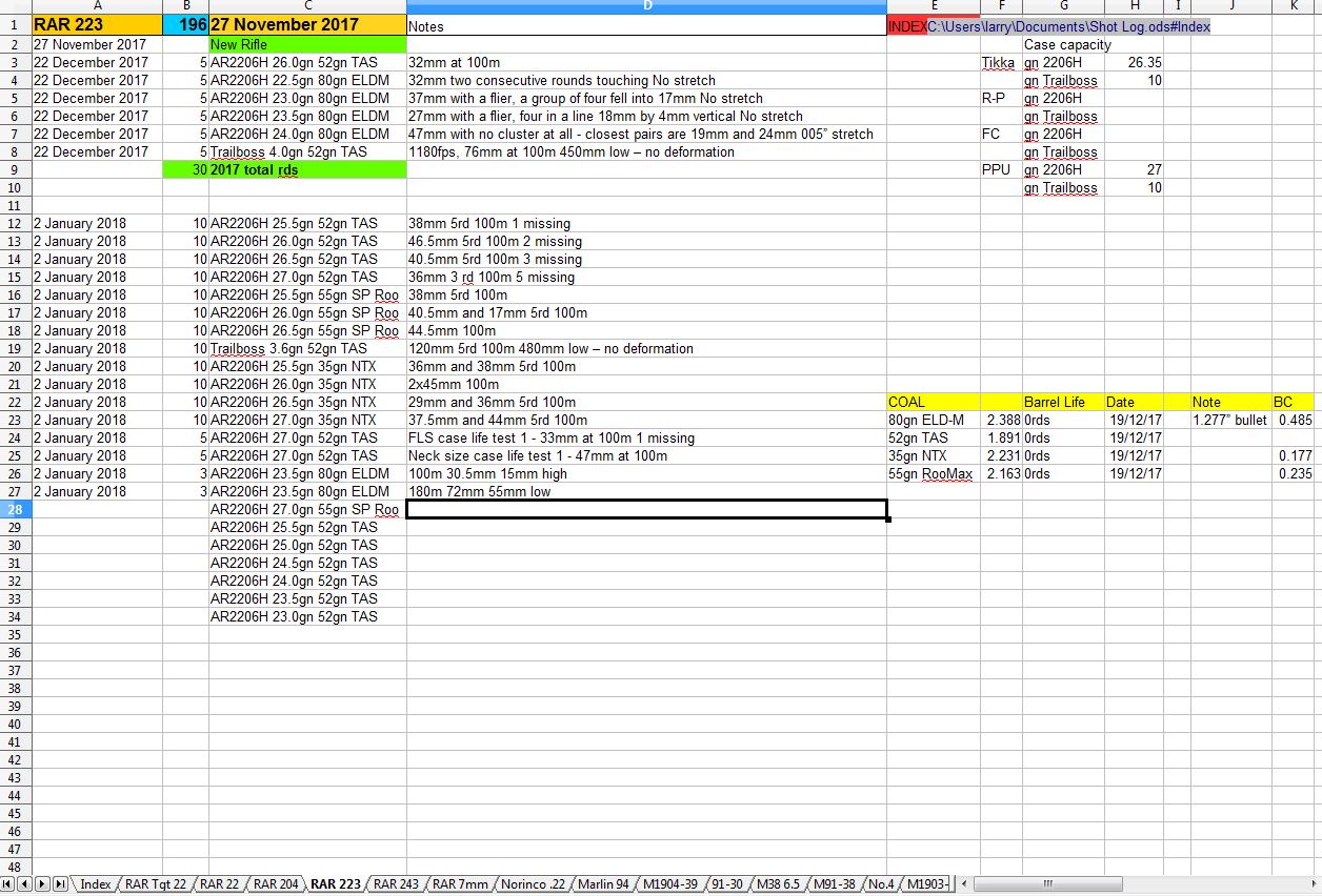

AusTac wrote:If i had my time again id begin a log of the rifle with every shot since i took possession of it, both rifle details and personal/weather details, that data is extremely valuable
That's exactly what I do for every firearm I own.
223 log.JPG (271.17 KiB) Viewed 6913 times
