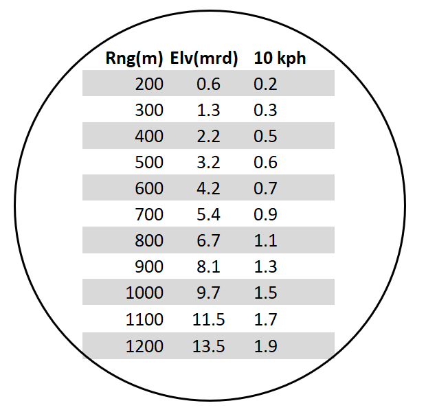

I would zero an "up to 300m" rilfe at 200m. You will find this is very close to the 50 meter zero due to the external ballistics of a .223. Have a look.....
As Tassie mentioned, a Ballistic app will help you dial in the scope to the other distances from this zero. Hornady's 4DOF calculator is worth a look -it is free. I - made up a backup that is stuck to the inside of my flip up scope cover for when I forget to charge my iPhone......This one is for a long range rifle, which is zeroed at 100m.

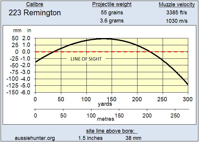

Post by Oldbloke » 16 Aug 2020, 11:13 pm
This is what I keep on my mobile. Calculated on the Hornady balistic calculator. But hardly use it.
