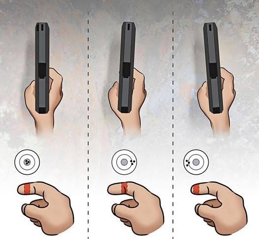

I know this is a handgun but here is a visual aide for finger position.
images (7).jpeg (30.58 KiB) Viewed 7340 times
