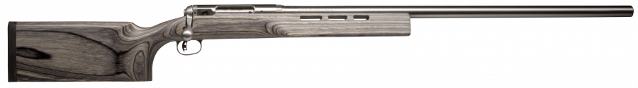

Hi guys,
Like the title says, looking for some feedback on off the shelf F-Class rifles compared to custom jobs (Neither of which I really have any experience with).
Currently looking at either the Savage 12 F Class or F/TR. These guys...
Savage Model 12 F Class
Savage Model 12 F/TR
They're about $2,000 which seems reasonable given the claims they make. How can they compare to a custom job though?
All else being equal, if the same skilled shooter used one of the above and his custom job, could the Savage really be competitive compared to the custom or would it always get edged out?
