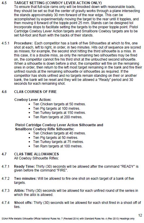

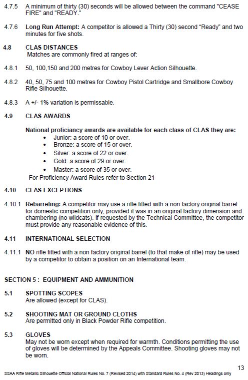

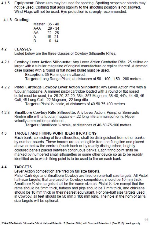

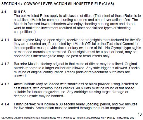

Okay, I'm thinking it might be possible to get to the lever action silhouette comp at Little River the first week in May.
I've emailed the club secretary for entry forms and details but thought discussing it here might also be helpful for anybody else interested.
I've never even watched a metallic silhouette shoot and haven't shot a rifle comp since 1983 when I was part of Wesley College ARMY Cadet small-bore team. If I do manage to make it happen I'd most likely go up in the bus and just live there for the duration of the event. So, I'd prefer to do as many events as possible while I'm there. Getting as much range time as possible in addition to the comp shoots would also be a bonus.
From what I've managed to work out so far it looks like there are three disciplines and I should be allowed to enter all three:
CLAS - 40rds, 200m, no scope, full-size MS target. (would likely buy a .30-30 or .45/70 for this)
Pistol Cartridge CLAS - 40rds, 100m, no scope, half-size 10mm MS target. (Marlin 1894 .44 Magnum)
Smallbore CLAS - .22LR, 40rds, 100m, no scope, half-size MS target but thinner. (Norinco JW21)
Targets are confusing me though.
In the RMS Rulebook it lists three types of MS target:
"Centrefire" Targets are full-size (taken from the templates).
"Rimfire" Targets are one-fifth full-size targets.
"Air Rifle" Targets are one-tenth full-size targets.

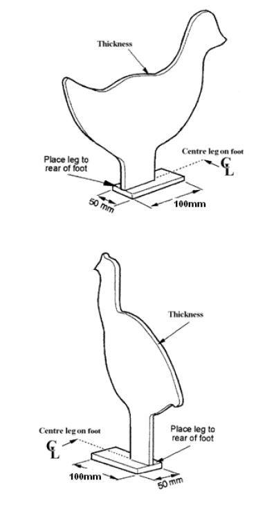

I've been practicing with standard Rimfire MS one-fifth scale silhouettes at 40m, 60m, 77m and 100m.
This CLAS "Smallbore" competition appears to use thinner half-size silhouettes - 5mm ram, 7mm turkey/pig and 10mm chicken - is this correct? A 13" high by 16" wide ram at 100m?
CLAS Rules 1.JPG (78.28 KiB) Viewed 16492 times
CLAS Rules 2.JPG (123.89 KiB) Viewed 16492 times
CLAS Rules 3.JPG (123.03 KiB) Viewed 16492 times
CLAS Rules 4.JPG (92.54 KiB) Viewed 16492 times

Hi Bladeracer
The course of fire for this Nationals will be as follows:
80 shots CLAS Rifle (Rams at 200m, Turkeys at 150m, Pigs at 100m and chickens at 50m) Targets used are full size.
I am not 100% but I am pretty certain this match is happening on the Friday.
80 CLAS Pistol Cartridge (Rams at 100m, Turkeys at 75m, Pigs at 50m and Chickens at 40m) Targets used are half sized 10mm Bisalloy. This match will be on the Saturday.
CLAS Small-bore (Rams at 100m, Turkeys at 75m, Pigs at 50m and Chickens at 40m) Targets used are half sized but are mild steel of varying thickness. This will be on the Sunday.
The Monday will be designated as an overrun day if needed.
If you haven’t shot the matches before you will enter as an ungraded competitor and your scores in the matches (specifically the highest of your 2 -40 shot matches) for each class.
As for rifles, for the rifle match a30-30, 45-70 or 44 Mag are all used successfully others used include 38-55, 35 Remington, 308 Marlin express, 338 Marlin express even 357 Mag to name a few, I personally run a 30-30 using Sierra 130 grain JHP with 32 grains of 2206h on targets out to Turkeys then use 150 grain JRN sierras on rams with the same powder charge and they don’t stand when hit.
For pistol the 44 is a good choice but be mindful that you don’t need a full strength load to take down the targets, a 22 Mag will successfully compete in pistol cal and one of our most successful competitors runs a 25-20 with 63 grain pills so you can keep recoil under control and still compete.
As for smallbore HV ammo is the way to go Federal Auto match is popular.
When it comes to ammo I usually load about 120 rounds for rifle each for myself and the missus, both of us run 30-30’s. I load about 200 rounds for each of our pistol cartridge rifles in case we have to double up, and finally just grab a box of rimfire.
In your case you have a backup available for everything except Smallbore as the 44 will work for rifle and in a pinch you can use a 22LR for pistol cal but it may stand rams.
Hope the info helps, hope to see you there.

I just went and had a practice at these half-size targets, except I shot the pig at 60m not 50m.
So much easier after practicing on the one-fifth scale targets!
I fired fifteen at each target at 40m, 60m, 75m and thirty rounds at 100m getting 8, 6, 5 and 17 hits.
Then I fired fifteen at 100m off the bench to see where they're hitting. Holding about half his height over the ram's back puts the bullets into his left half. I aimed at the feet of the chicken and dead on the pig and turkey.
Then I fired a group of ten off the bench just to see how I'm grouping with the peep sight and dropped them into about a six-inch circle at 105m.
The body is still a bit tender for shooting the .44 I think so I'll just play with the .22 for a while.
I think I'll have to make a smaller aperture for the rear sight and possibly a new front sight and ramp. The ramp encroaches into the sight picture which I think detracts from accuracy. I still need to organise a peep for the Marlin.

The pig is always thought to be the "easiest" target. The correct distance is 50m for the 1/2 sized targets used in small-bore and pistol caliber.
When practicing, it is good to get into the habit of following match rules. Only load 5 rounds. Fire them in the 2 minute time allowed. Stand down, have a break. Then repeat. It is not much use practicing by firing off a whole magazine full at a time, it just creates bad habits. Slow down and take each shot with care and as if it is the only shot you get, make it count. This will develop good habits. Concentrate on sight picture and trigger control, improving on these two things alone do much to increase your ability to hit targets.

Gamerancher wrote:The pig is always thought to be the "easiest" target. The correct distance is 50m for the 1/2 sized targets used in small-bore and pistol caliber.
Wow, I think I'll be hitting the pig 100% pretty soon then :-)
Only five rounds in the tube? I thought these things were shot in strings of ten.
And in two minutes?
That's at least an hour to fire 150rds.
All I'm doing is walking out and shooting two or three 15rd tubes from each firing point, only takes fifteen minutes to have a practice so I hope I can manage it at least once every day.
I'm concentrating on the sight picture primarily but I need to improve the sights. Even off the bench at 100m I'm only making roughly 150mm groups. With the scope the rifle is capable of pretty consistent 40mm groups at 50m and 100mm groups at 100m so I'm sure I can tighten it up a bit more with the peep sight. The front sight is sort of "furry" and too big I think, it completely conceals the turkey. And it is mounted on a ramp which intrudes into the aperture so my sight picture is flattened off across the bottom. I'm going to reduce the aperture first and if that doesn't help I'll have to make a new front sight or modify the ramp.
My breathing and trigger control have improved the most I think and I try to call every shot at the break. If I can fire when the sight post is in the right spot I'm fairly sure it'll be a hit. The trigger is not great but it's not bad. Pretty good feel and a reasonably crisp break, though quite heavy. I stripped the rifle to clean all the junk out of the action and all the parts are very poorly finished, even where they move against each other. I think I need to do some polishing and clean up all the flash and dags.
I intended to use Eley Edge for the actual comp but the CCI SV is accurate enough for practicing. The Eley will tighten up the groups as well. I want to try some supersonic stuff to see if I can find something that hits point of aim at 100m but still lets me shoot the subsonic CCI SV and Eley at 40m, 50m and 75m to point of aim.

Targets are shot in banks of 5. 2 banks for your 10. In CLAS you will be called to the line, where you bring your rifle etc up to your position and put it down, no further handling of firearms. You will then get a 30 sec "ready" call, you may now load 5 rounds, adjust your sights etc. A "fire" command will be given and you have 2 minutes to fire your five shots. A "cease-fire" command will then be given, you clear your action and place you gun down on the bench. A second set of the same commands then follows for your next bank of 5 targets. All up you will be on the line for about 6 minutes per 10 "animals". Depending on the number of shooters and banks of targets, there will be a number of "details" to get all of the shooters through the match. You won't necessarily start at chickens, each shooter is allocated a starting position/ animal so that all positions are filled. You will rotate through the positions / animals throughout the day so that at the end you will have completed the full match / matches. (40 or 80 shots )
At large events such as the Nationals, there can be 4 or more details, so you spend some time away from the line. Most folks will spot for at least one other shooter so you may be on the line at least 16 times a day. With target resetting plus shooting time it makes for a long day to get everyone through. Even though it doesn't sound like much shooting, trust me, after an 80 shot match, you will be tired. It is very hard work to stand still for 80 shots. :thumbsup:

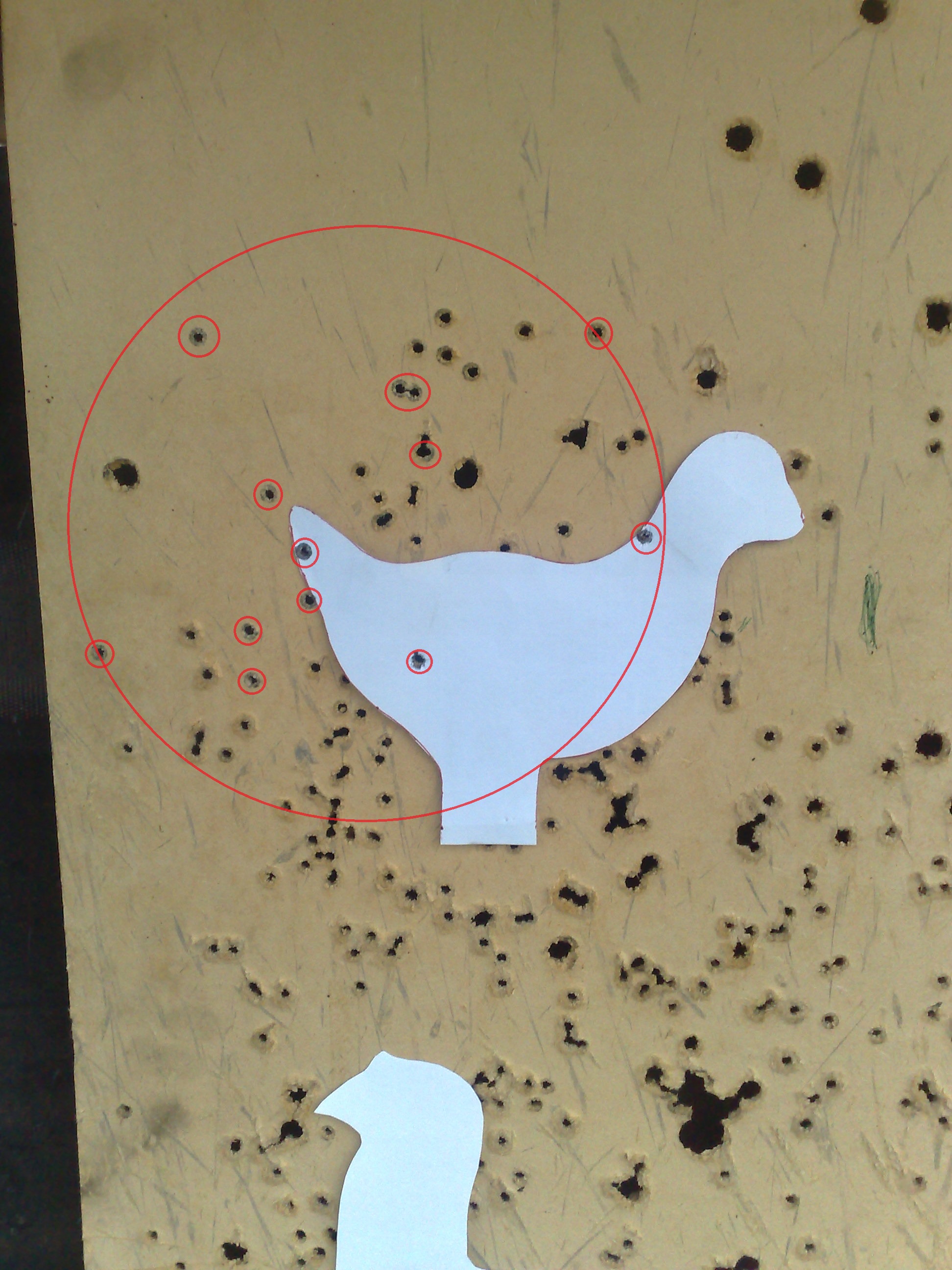

I traced out some paper silhouettes to see where my groups are hitting but it occurred to me that that'll probably change depending on which way the silhouettes are facing?
I found some video online of Aussie silhouette and it appears to be five facing right and five facing left.
These were all aimed dead on centre mass as I wanted to see elevation and windage so I can make a sight adjustment to suit.
Quite a useful practice I think.
I'll cut out some more tonight including the ram. Two of each facing in opposite directions to see how the shape affects my point of aim.Today's effort on the steels were 6/15 on the chicken, 12/15 on the pig, 9/30 on the turkey and 18/45 on the ram.
The Norinco really started playing up this time. Of 150rds I think about a dozen fell off the loading ramp and one was even ejected along with the empty case. About forty cases failed to eject preferring to stay in the action. And about five cases failed to extract fully. At 1235rds I think it's time to give it a thorough clean :-)

Post by Gamerancher » 08 Jan 2018, 7:26 am
Yep, 5 each way is the usual way it is done. If you are having trouble with the front sight covering the animal, adjust for a lower hold. Say, aim the leg of the turkey and have the bullet printing centre mass. In pistol silhouette matches it is usual to hold "rail" with the target "standing" on the front post. Or, you could try a smaller post/bead if your eyesight is good enough.
Above all, it is best practice to get your sight settings off-hand. How your rifle shoots off a bench is not a good indication of how it will off-hand.
Your above groups also show a left of centre bias, that could be sight adjustment or a natural tendency of your follow through.
