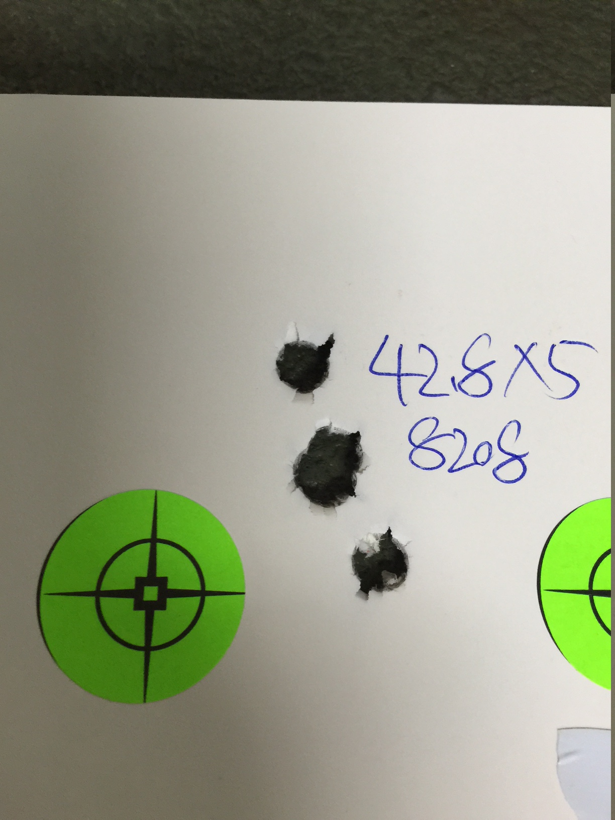

Post by SHV » 26 Jul 2017, 9:31 pm
thank you guys for your replies, they are really helpful, just came back from St Mary's interesting resort, first 5 shot Hornady steel case match, not good but constantly separate about the same distance as aways

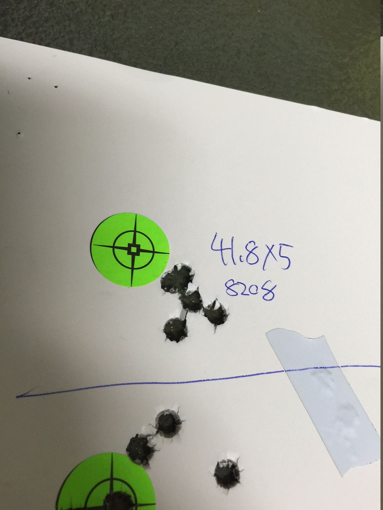

Post by SHV » 26 Jul 2017, 9:35 pm
second 5 shot, 41.8 gr 8208

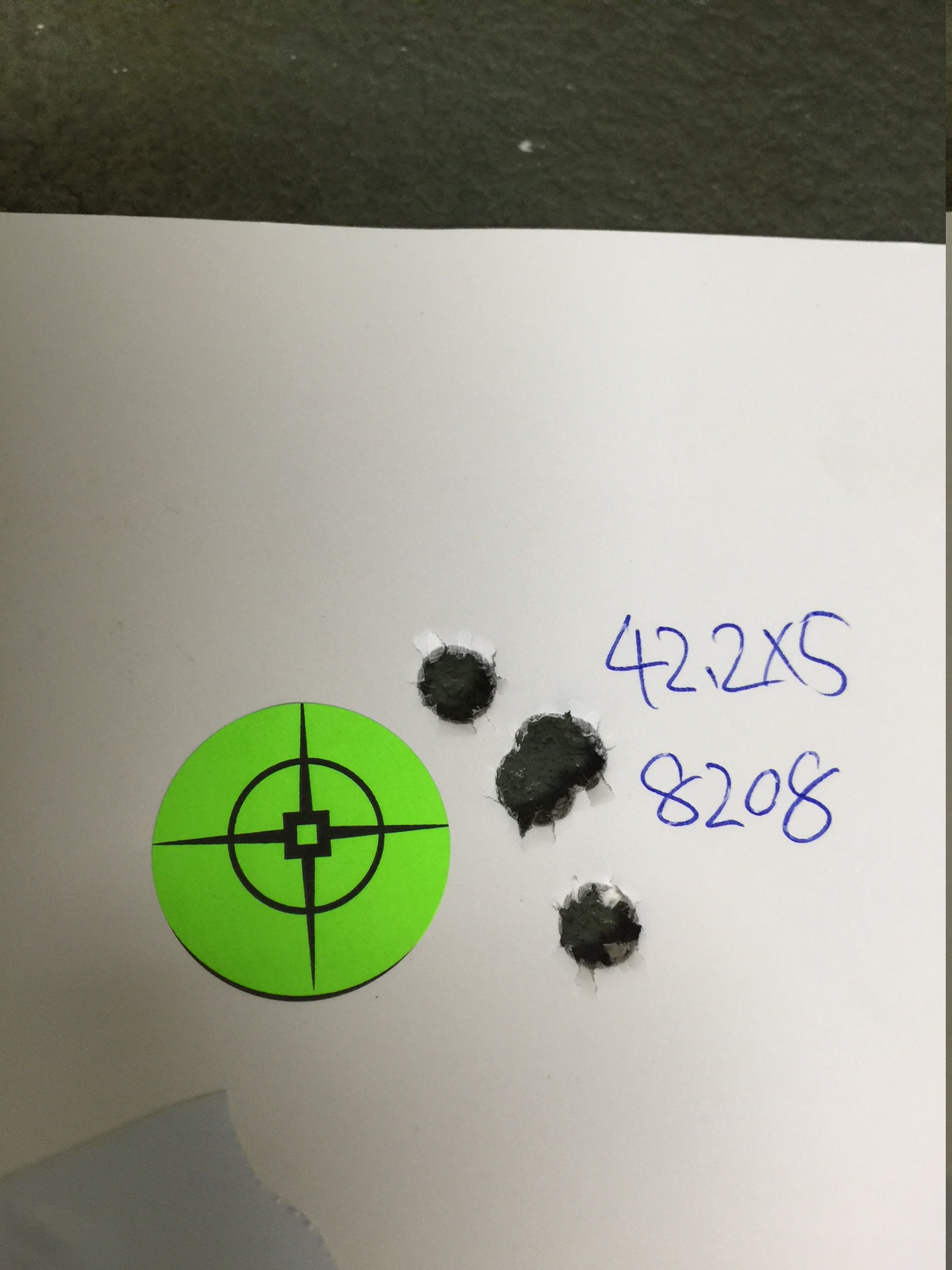

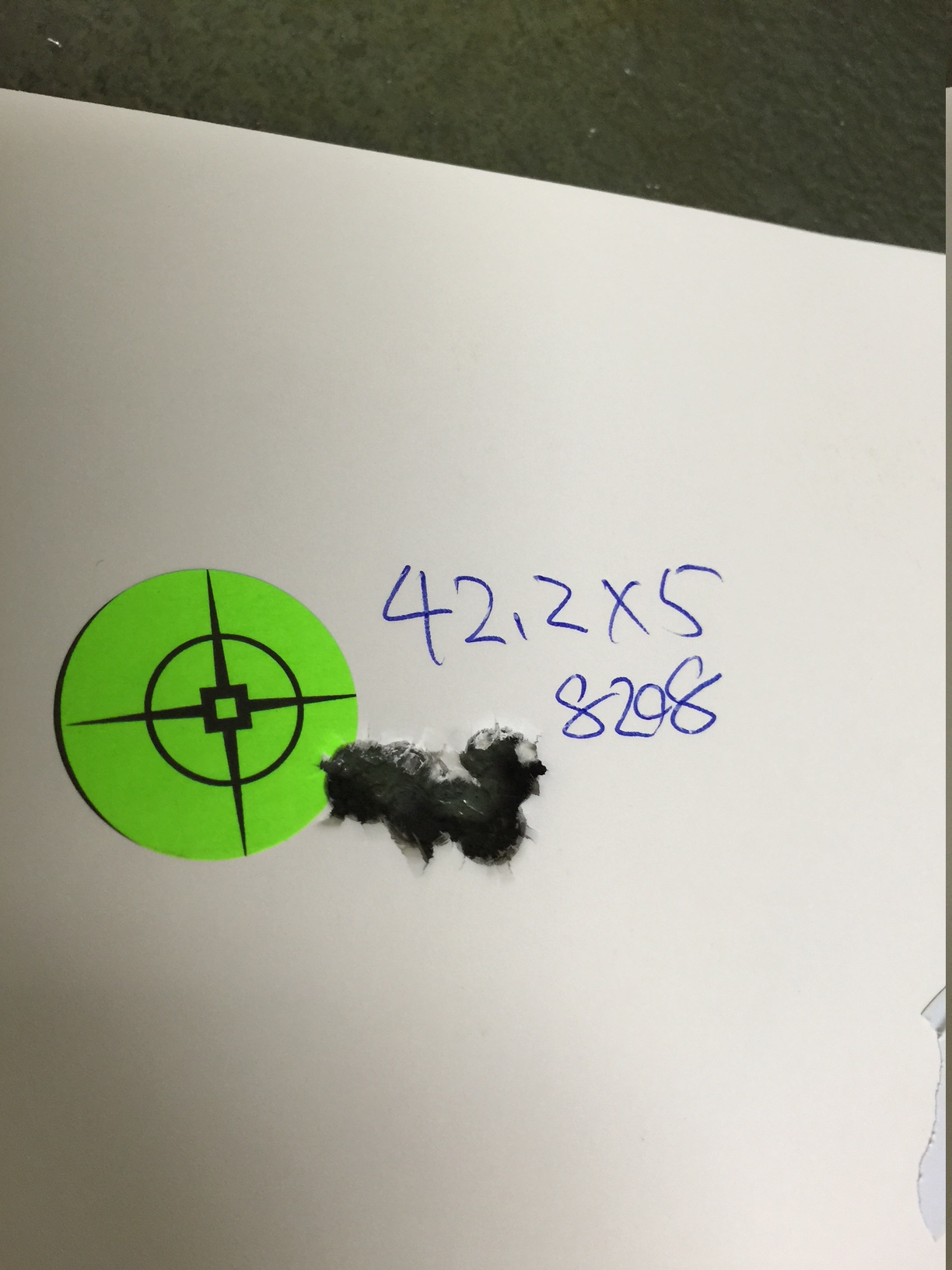

Re: SAKO A7 and range report
Post by SHV » 26 Jul 2017, 9:42 pm
the 3rd 5 shot, 42.2gr I thought I found it

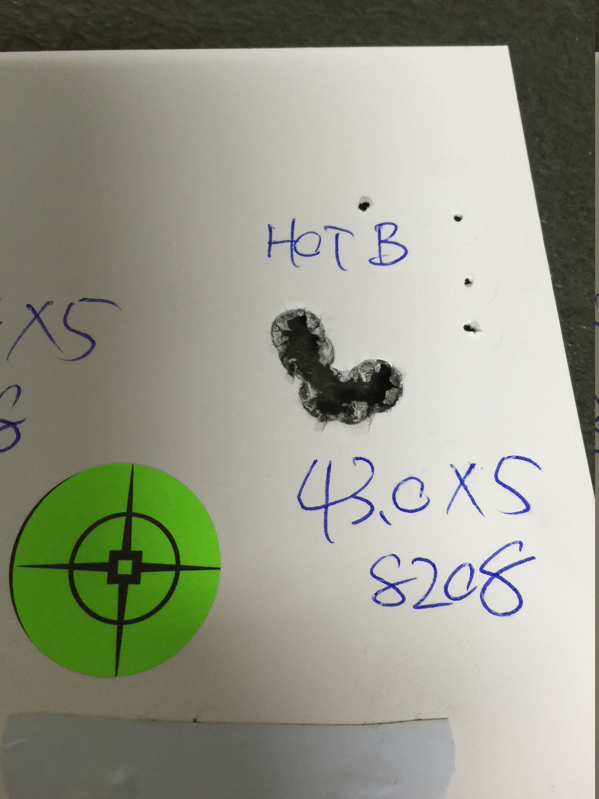

Post by SHV » 26 Jul 2017, 10:26 pm
the last 5 shot group this evening, 43.0 gr

Post by Gwion » 27 Jul 2017, 6:42 am
Personally, I'd stop testing so many different charges. You have already had some good results. Pick a good one and load 15 rounds. Confirm the load by shooting 5x 3 round groups, allowing the barrel to cool completely between groups (take your 22 to the range). Take special note of where the first round from the group impacts and sight the rifle to that bullet strike. Take the rifle hunting. Set up a target in the field at 100yd/m. Shoot one shot at the target, adjust your turrets so you are 1" above bull. Fire one shot to confirm and then go hunting.
Buy a heavy barrel rifle for range use or stick to the 22 if you are heading to a 50yd range.

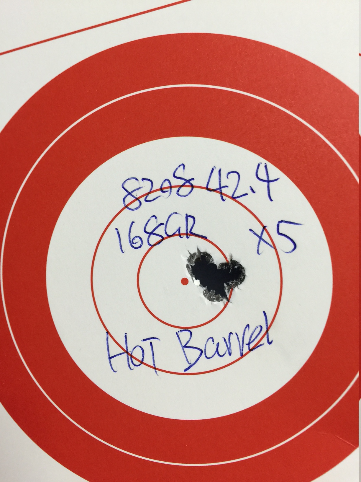

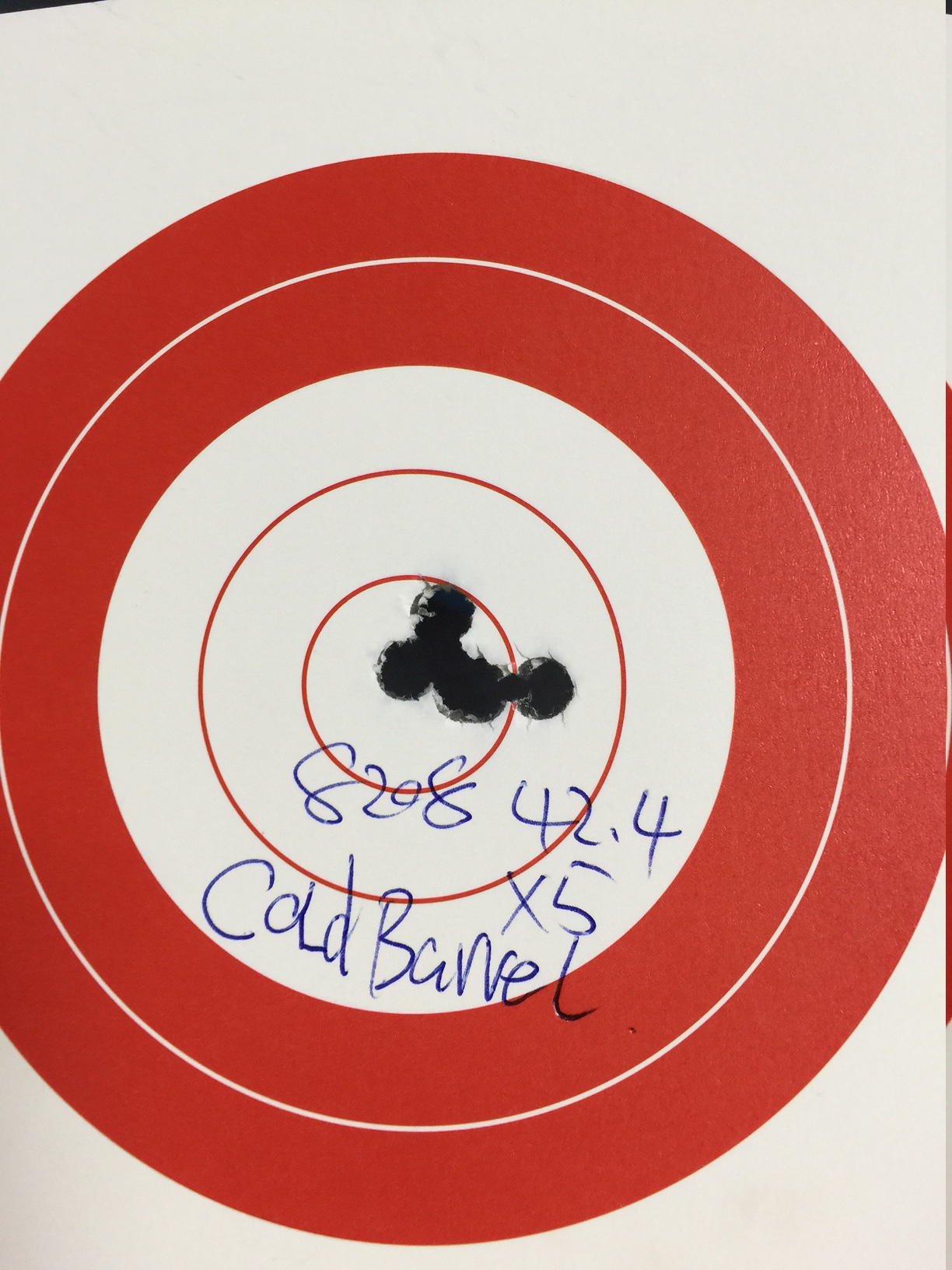

Post by SHV » 09 Aug 2017, 10:15 pm
tried 2 x 5 shot groups, cold barrel and hot barrel, 168gr zmax, 42.4gr 8208 50 meter indoor shooting range(St Mary's)
cold barrel 5 shoot got one fly(it could be my fault), otherwise not too bad
Post by SHV » 09 Aug 2017, 10:17 pm
hot barrel one is ok, for hunting should be good enough anyway...
