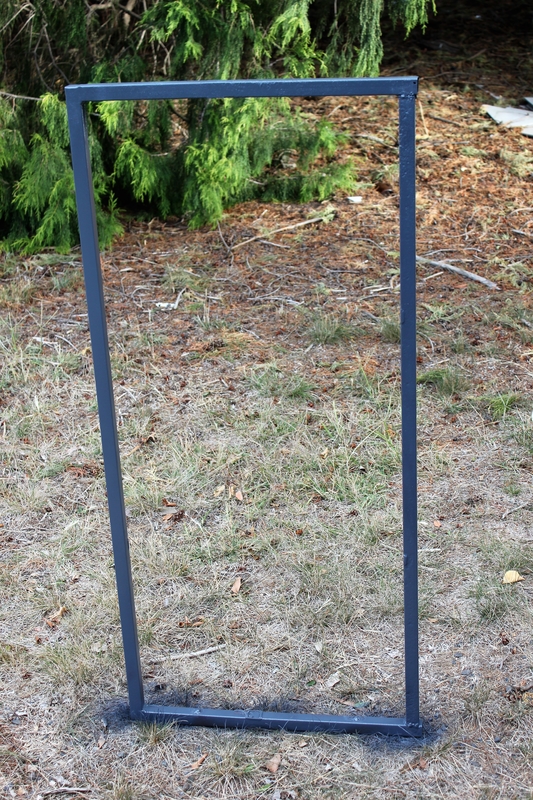

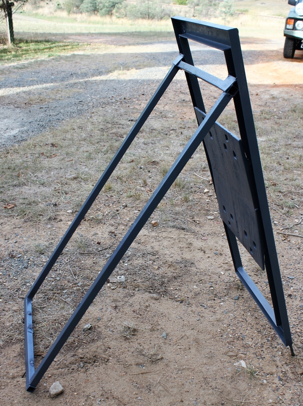

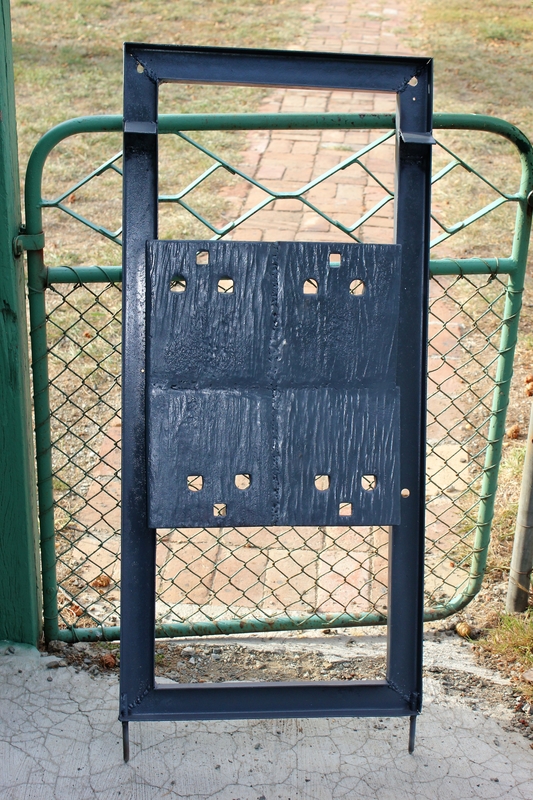

Post by Gaznazdiak » 10 Apr 2018, 5:24 pm

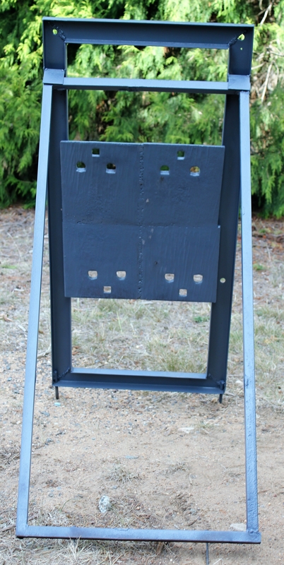

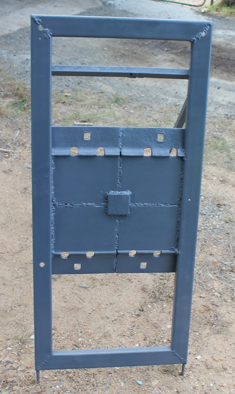

I finally finished the deflector for my target frame. Weighs 36kg so it should take any hit.
The plate frame has 90mm spikes to push into the ground for stability and the legs have smaller spikes to prevent sliding.
The target frame is the high tensile wire rod frame from an old Sealy mattress with the middle removed, over which I slap some corrugated cardboard to tape the target to.

Re: Homemade steel targets
Post by Member-Deleted » 11 Apr 2018, 9:13 pm
Yeah nothing wrong with that mate all painted up and neat
cheers

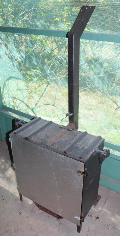

Talking about smokers here's mine I bought way back from a friend after the phone company made it obsolete
back in the 80's :thumbsup: :lol:
Hot or cold smoke two block partitions underneath feed the smoke required into the smoker
cheers

Post by Sergeant Hartman » 12 Apr 2018, 4:31 pm
That looks more like an outdoor dunny with that white plastic looking....ummm....poo trap.
Post by Member-Deleted » 12 Apr 2018, 6:22 pm
Yeah when I get too old to smoke stuff I could knock a hole in the floor and use it for a dunny but at the
moment the plastic bucket has a lid on it and is upside down with saw dust in it which I use for smoking

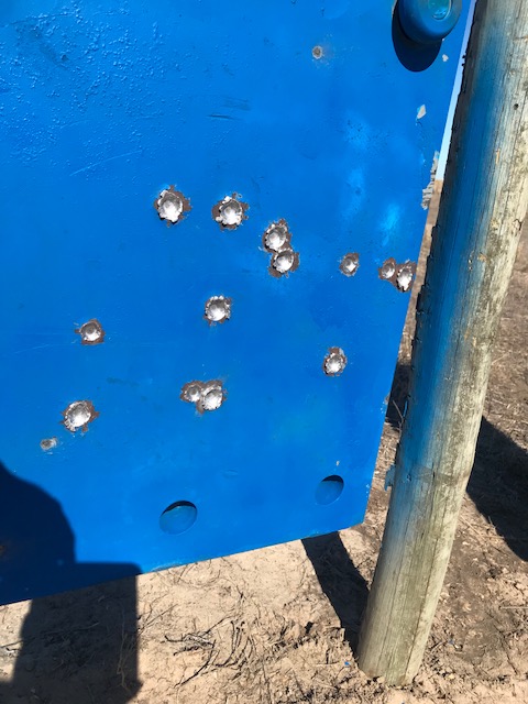

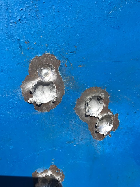

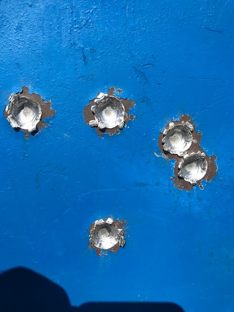

Post by Growler » 22 Apr 2018, 7:03 pm
Got a piece of 550x400x40 mild steel plate that seems to do the trick.
.303, 30-30, and .22lr at 100m
Just the necessity
Growler
Posts: 58
Post by Gaznazdiak » 23 Apr 2018, 9:32 am
Hey Growler, 40mm, outstanding, stop .50 with that!
fideles usque ad mortem
Gaznazdiak
Posts: 1366
Post by Growler » 23 Apr 2018, 5:03 pm
Gaznazdiak wrote:Hey Growler, 40mm, outstanding, stop .50 with that!
Heavy bastard of a thing, its got me n ol mates backs chalked up for the win. Penetration looks to be 3-5mm max so reckon it'll last us a while
Just the necessity
Growler
Posts: 58
