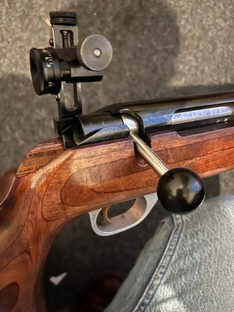

Post by Vince24 » 27 Jan 2023, 10:01 pm
I had a chance to shoot an OMARK 44 in 308W which is in the family.
Beautiful and Interesting rifle :) .
IMG_4789 reduced.jpg (56.93 KiB) Viewed 42514 times
IMG_4791 reduced.jpg (55.08 KiB) Viewed 42514 times
For a target rifle, I found the bolt is not that smooth, which does not help when you're trying not to change position between shots!
Otherwise, all good.
I shot 37 rounds in total, for sighting in and finding the right insert.
ADI factory 308w ammo 147 gr FMJ.
This is the 3rd and final group of 10, at 100 metres with the dioptre sight:
I am sure it can do even better with a bit of further efforts and handloading. Will get to it one day! :mrgreen:

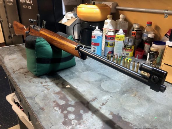

Post by Wyliecoyote » 29 Jan 2023, 12:37 pm
Omarks are probably the most underated action in this country. Remington 700 trigger compatible with a very slight grind of the cocking sear. The existing triggers make one of the best base units for three lever conversion where the sears are made of some very high quality tool steel and the housing is a machined one piece assembly.
As a single shot varmint rifle, there is not a better or more accurate rifle to be had. The actions can easily be milled for either AI or Legacy Rem 700 floorplate conversions.
There are a couple of things to consider though. Because of their age they are often prone to missfires due to aging firing pin springs. Originals are still about but any Rem 700 spring will fit and will alleviate the missfire or soft strike issues common these days..
The next thing to consider is the adapter. Steer clear of Lloyd Neilsons version with the recoil lug milled into it. Not going into detail why, just take my word for it. The early MAB ones Graham Bugden made were afforable and very well made and utilised the original recoil plate. They run 7/8" × 14 TPI tenons which are OK but i have made versions in 1" x 16 TPI and others in 1 1/6" x 16 TPI to use Tikka and Rem 700 take off barrels utilising the plate style recoil lug.
Milling the actions for AI magazines is relatively simple. Other actions have been milled into single shot dual port, left feed right eject versions.
Overall Omark actions are made of very good quality steels where they are probably the most rigid actions out there. If i had a bad thing to say about them it would be the primary extraction is a little so so. I have machined in a roller bearing into the reciever to some actions to recover lost camming from poor fitting adapters. This will recover the camming extraction and slicken them up considerably. Poorly fitted adapters that had to be rotated further around to get the bolt lug timing right contribute to this and soft strikes as the firing pin travel is reduced. If you get one of these actions to build a good rifle on, find someone who makes their own adapters or someone that has had experience with putting fullbore rifles together. Specifically Omarks.
Below is a couple of a few of my Omark conversions i did back when i could be bothered. One is a 6 PPC HV that shoots amazingly small groups and has done well at the Madden and other BR events, and the other is a scrubber in 308 sitting in a Remington PSS stock that has done very well at ridding farmers of deer and hogs.

I note however that Wyliecoyote has made a modification on his that I find 200% useful and that I would love to make on "mine" (my in-law's)
An extended bolt lever. The original bolt is not very smooth, and requires a bit of effort in the lifting phase after the shot, which goes against the necessary focus and serenity for this type of shooting...

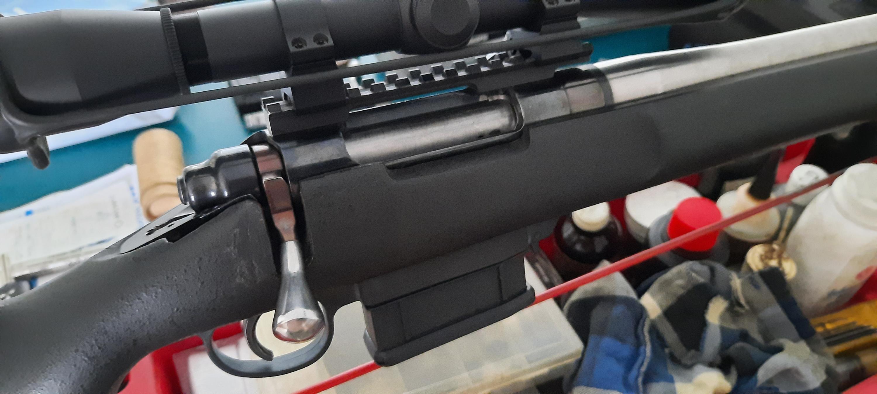

Post by in2anity » 01 Feb 2023, 7:18 am
Yes they are notoriously difficult to unlock; even the derivatives like the Neilsons. Chalk and cheese compared with a Barnard, which is a major criticism. At least the updgraded versions (like the Neilson) have the oversized bolt handle like mine:
Oversized bolt handle on a Neilson MN600
The cheap advice around this is to simply keep your lugs well greased.
I can assure you, with enough experience and dryfire, you get used to the stiffnes though. I unlock mine by placing my thumb just behind the receiver, and then crab pinching together with you index finger around the bolt. So automatic now, I catch my brass with the same hand which goes straight back into the box. Left hand stays strapped up and butt stays in the pocket, for the duration of the stage.
