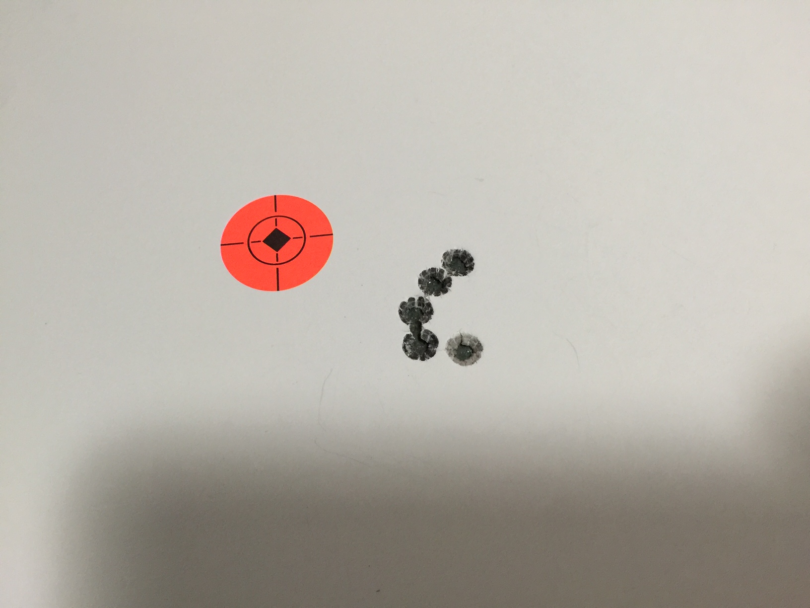

Post by bigrich » 28 Dec 2018, 7:04 pm
i know i've come in late on this topic, i rate my A7 very highly great trigger ,top loading as well as removable mag , shot 1" at 100 with aussie outback 165 game kings . but, it did not like 150 sst's at all in handloading. i tried everything different powders , coal lengths the lot. jumped to a 165 gn speer boat tail sp an d with a bit of fiddling it shoots quite well . i would suggest to anyone with a 308 A7 try working up to this load. it's under the max listed by ADI but i take no responability this load works great in my rifle . norma brass, federal 210M primer , 45.5 gn of ar2208 , 165 gn speer sp bt . i seated out as far as the mag would allow but it's still a fair ways of the lands. the coal i used is 2.870" . hope this comes in handy for someone who's maybe having trouble reloading with 150's
yup the pics sideways, bloody Iphone :lol: :drinks: :drinks: :thumbsup:
165gn load at 100
Posts: 6371
Re: SAKO A7 and range report
Post by bigfellascott » 28 Dec 2018, 7:25 pm
Try taking the pic in the vertical not horizontal position. :D
Nice little group mate, she shoots well. :thumbsup:
Post by bigrich » 28 Dec 2018, 7:34 pm
bigfellascott wrote:Try taking the pic in the vertical not horizontal position. :D
