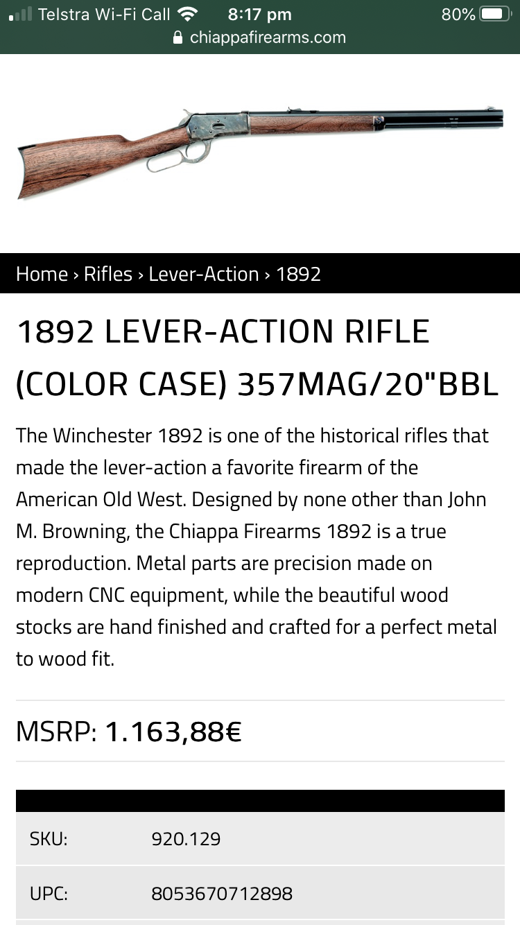

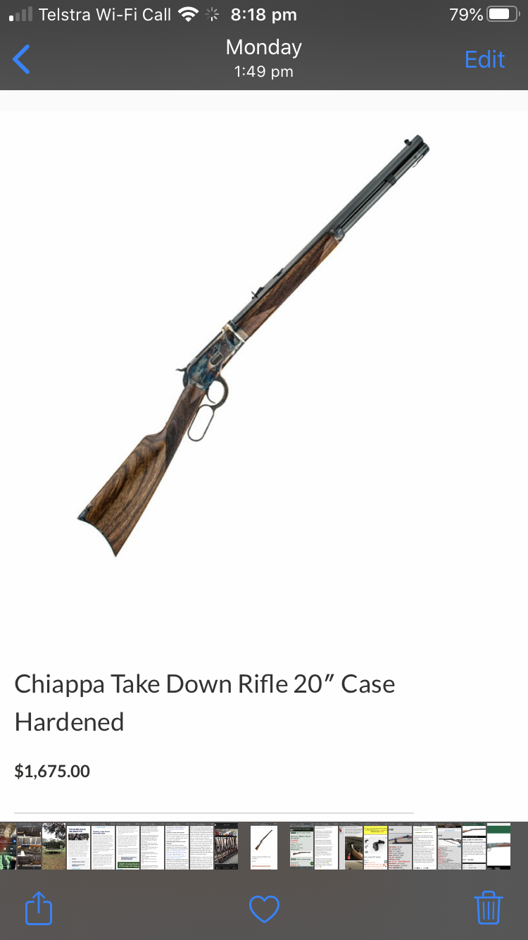

What about Henry rifles? They don’t seem to be too popular in this field. I know they’re not a replica of the models of days gone by, so is that the reason? Or is there another?

A mate has a Henry in .357, I shot it a couple of times, seemed to be a nice gun. Had a 20' heavy octagonal barrel. There's a few people with Henry .22's in the sport.

Post by Shootermick » 14 Apr 2020, 4:22 pm
Gamerancher wrote:A mate has a Henry in .357, I shot it a couple of times, seemed to be a nice gun. Had a 20' heavy octagonal barrel. There's a few people with Henry .22's in the sport.
So there’s no disadvantage to not having a loading gate either then. Do you remember what sort of sights he had fitted on it?

The rifle I speak of had a Marbles tang sight fitted. The Henry's load through a slot in the mag tube and have a tubular follower that houses the spring, similar to most lever action .22's. ( The original 1860 Henry loaded through the top end of the magazine, the loading gate on the side of the action was the "King's improvement" (Pat.) that came out in the 1866 Winchesters )

Gamerancher wrote:The rifle I speak of had a Marbles tang sight fitted. The Henry's load through a slot in the mag tube and have a tubular follower that houses the spring, similar to most lever action .22's. ( The original 1860 Henry loaded through the top end of the magazine, the loading gate on the side of the action was the "King's improvement" (Pat.) that came out in the 1866 Winchesters )
I considered a Henry when I bought my Marlin. They fit a few skinner sights to the Henry’s, on top of the reciever. Are those types of sights any good, or do they lack the adjustments needed for competition shooting?

WRT Henry's, there's a lot of folk in the US who are now using, and liking, the 24" octagon barrel Frontier 22LR for the smallbore match.
And now that Henry has introduced a loading gate variant of their centrefire rifles (and not deleted the forward mag tube loading port), Marlin/Winchester are getting a bit of a nudge from that maker as well.

Post by Shootermick » 16 Apr 2020, 4:04 pm
I’ve seen and handled a few Chiappa firearms, and am thinking I might go for something like this one.

Re: MSRC SSAA National Lever Action Silhouette Championships
Post by Gamerancher » 17 Apr 2020, 9:56 am
I haven't seen any of the current Chiappas, the ones I have seen have been pretty ordinary when it comes to shooting and reliability. I actually had to grab one out of a blokes hands at a comp once, he was about to wrap it around a steel post after it failed for the umpteenth time. They didn't get the nick-name "Crappers" for nothing.
While the colour case does look nice, at those prices I'd probably look at a current Miroku built Winchester instead if you're after a '92 in .357.
Post by Shootermick » 17 Apr 2020, 11:18 am
Gamerancher wrote:I haven't seen any of the current Chiappas, the ones I have seen have been pretty ordinary when it comes to shooting and reliability. I actually had to grab one out of a blokes hands at a comp once, he was about to wrap it around a steel post after it failed for the umpteenth time. They didn't get the nick-name "Crappers" for nothing.
I’ll rule a line through them then. The current Winchester’s are pricey, but I won’t rule them out. I’m still keen on a Henry too, thinking a 20” big boy steel, I really like my single shot Henry. I guess if my rifle of choice didn’t come with the factory drilled holes required for a peep it’s not a big deal to send it to a gunsmith to have the new sights properly fitted.
