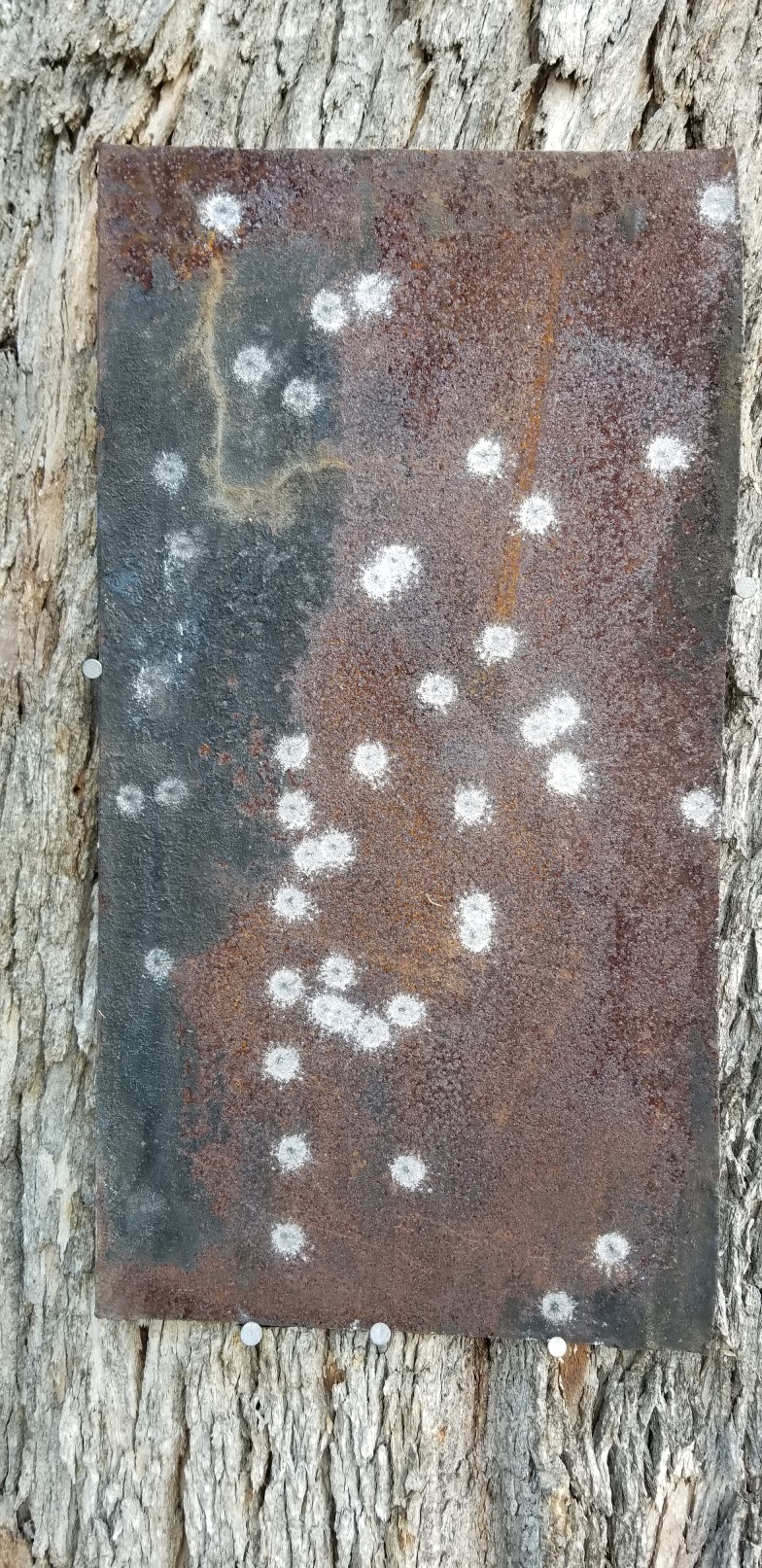

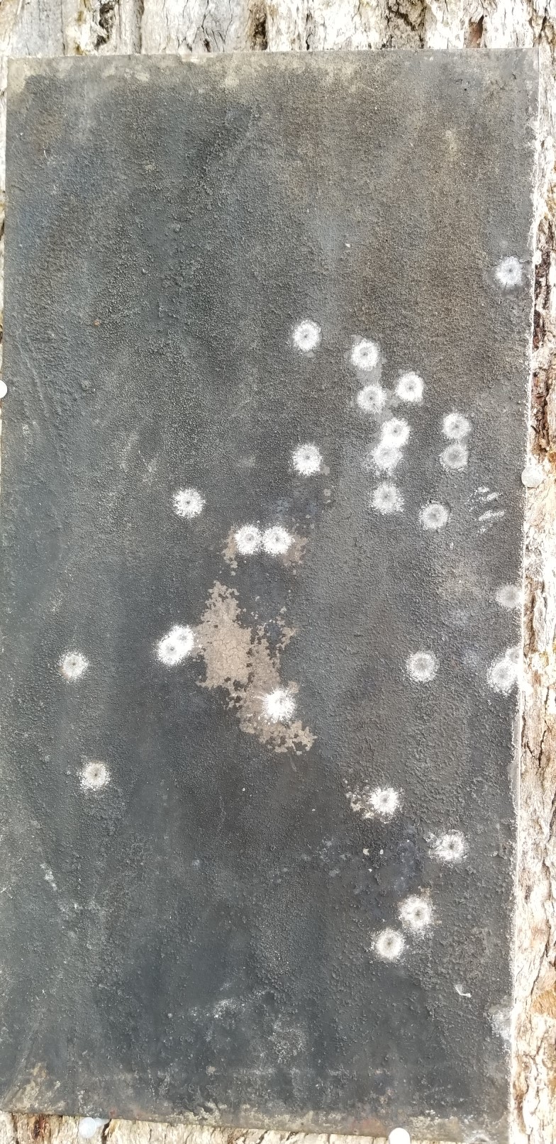

So I dialed it up to 36MoA and tried at 240m at a 5mm steel plate 200mm wide by 400mm tall. The wind was coming from over my left shoulder and messing about a bit, so I was holding between the left edge and three-quarters of the target width (or 150mm) to the left side. The elevation was perfect. My second shot was a hit, but once I found a wind hold, I ran them quick before the wind could shift and was making about seven hits out of a ten-round mag. The last group to finish the box was seven hits from seven rounds. I was surprised to recover the flattened bullets from the ground a couple meters to the left of the target, so I can only guess the wind was turned around between me and the target.

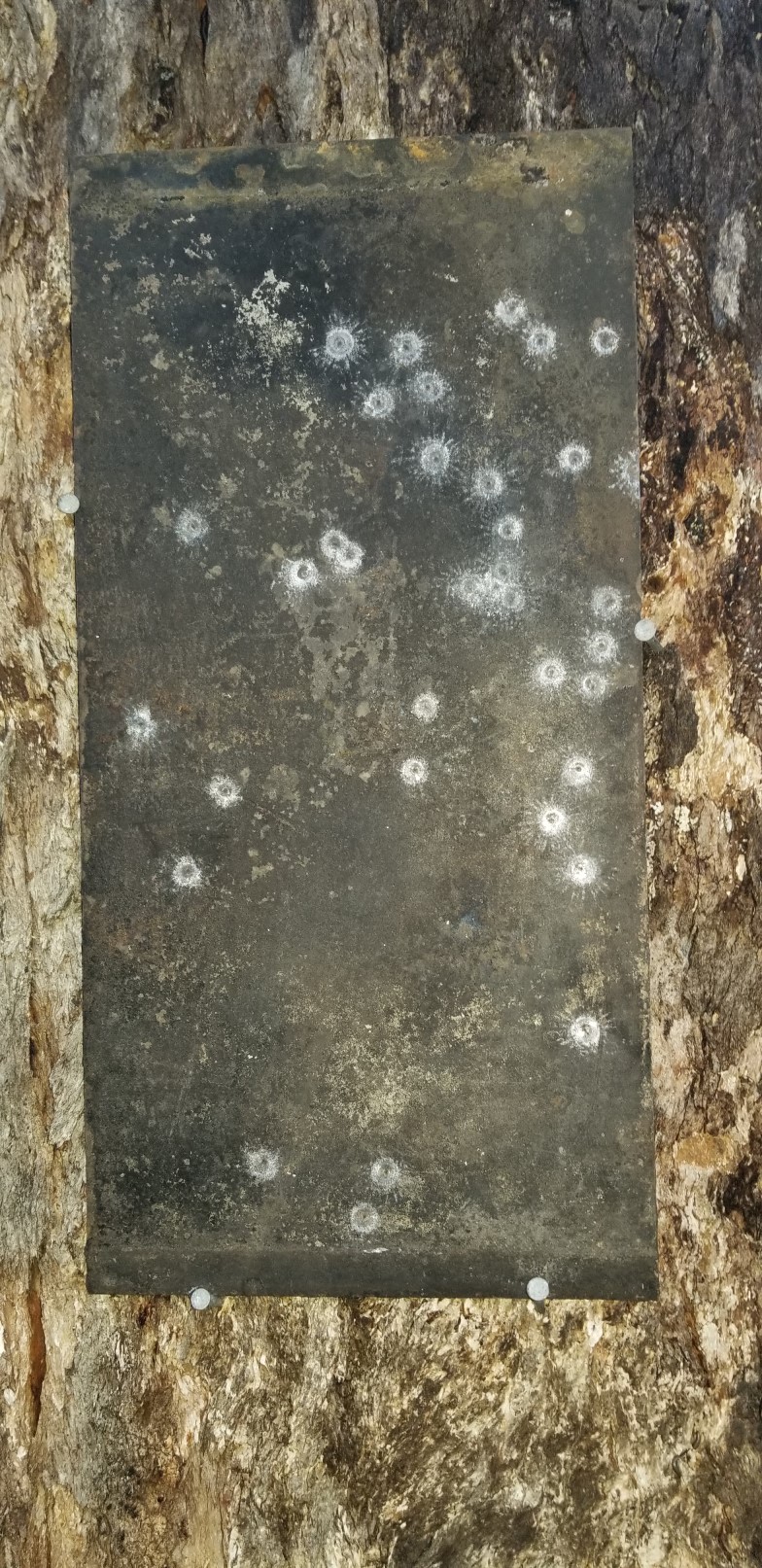

275m plate is 440mm by 240mm
240m (reverse side of plate)

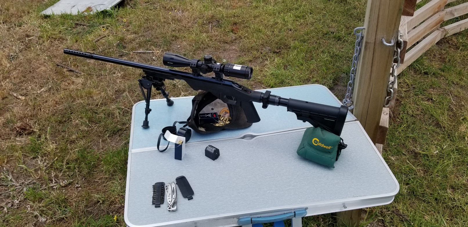

RAR Target .22LR in MDT LSS-22 Chassis

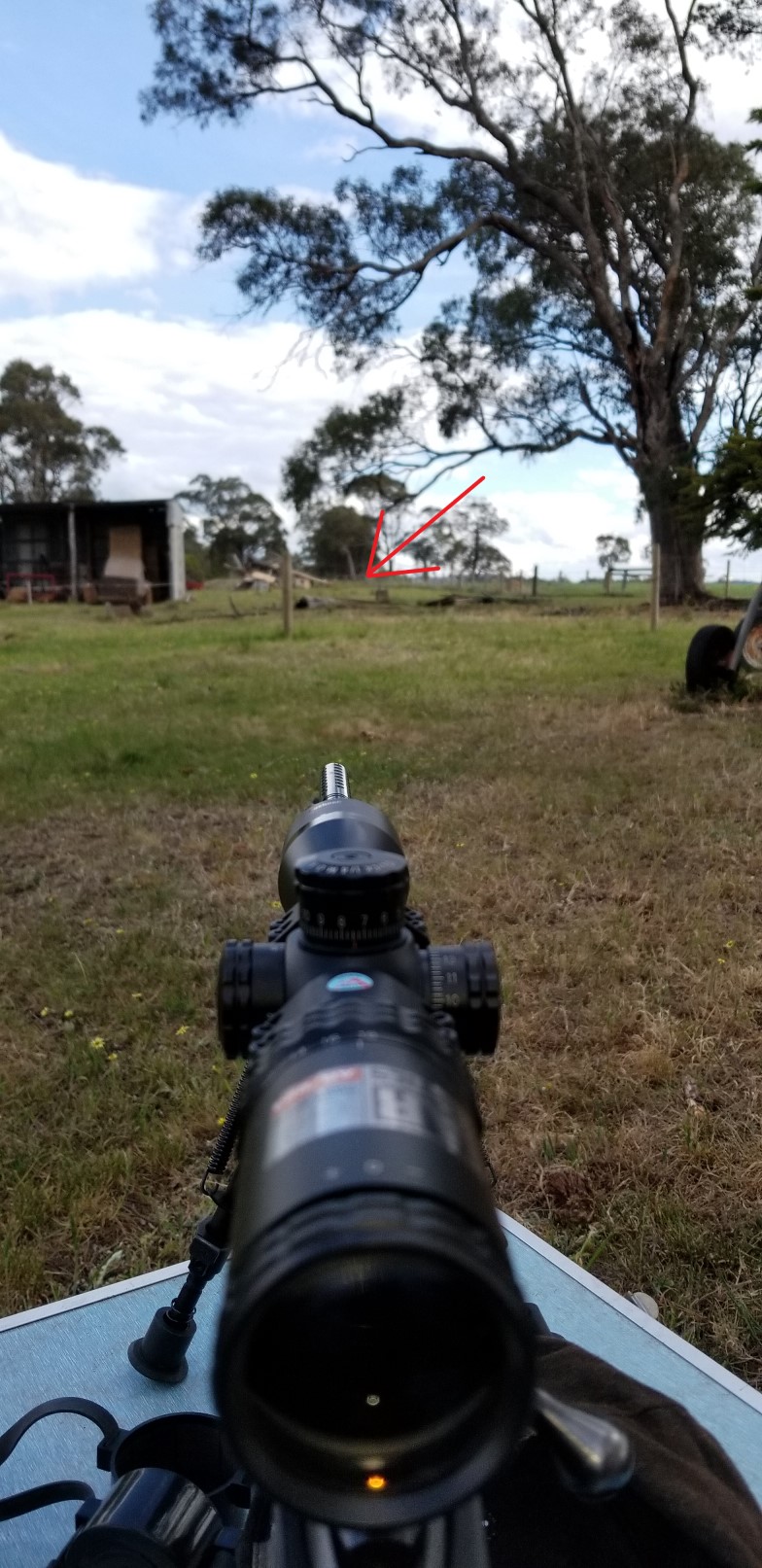

240m and 275m targets attached to dead trees tucked well behind those trees at the dam, with very limited line of sight.

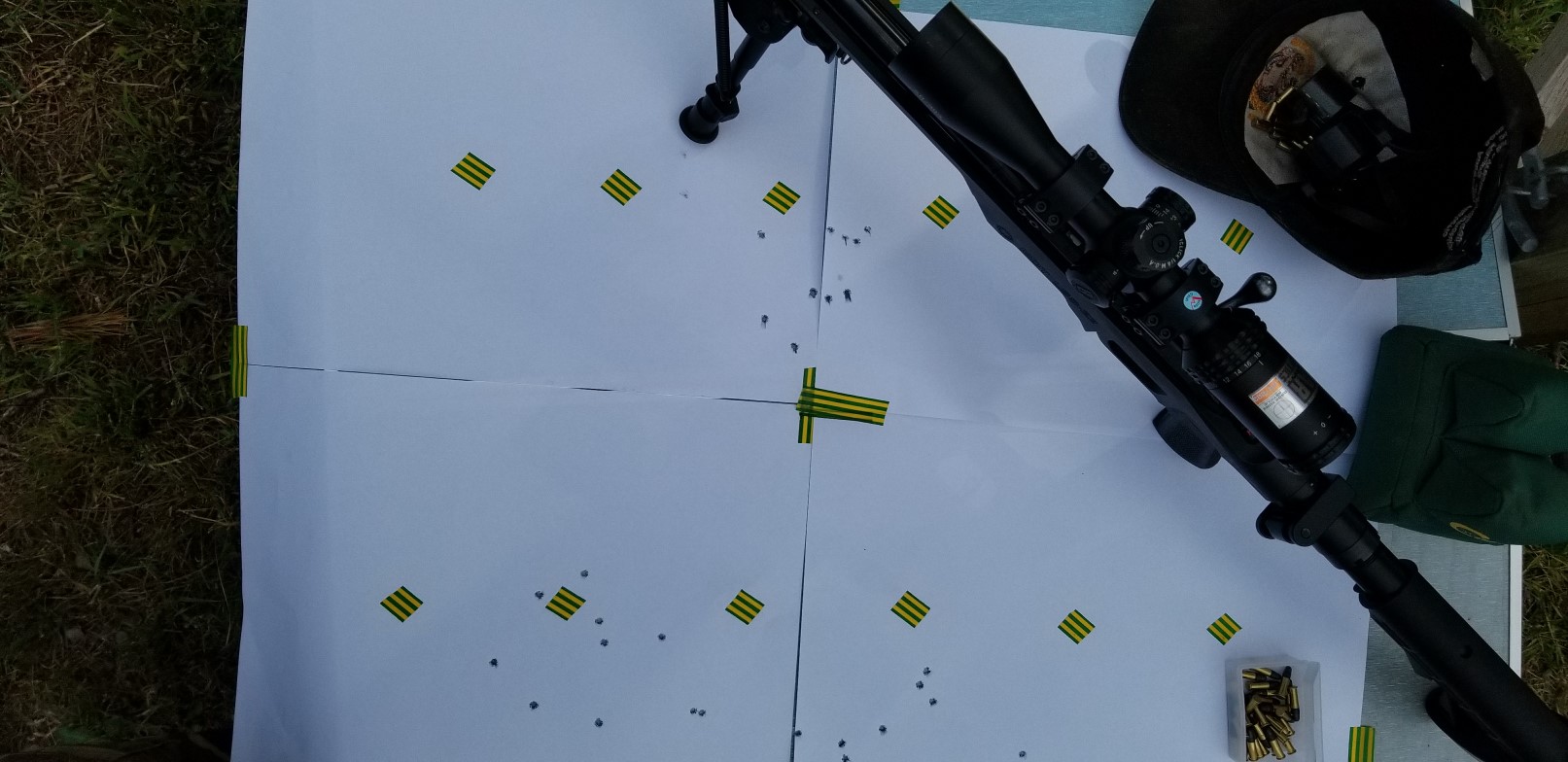

Zeroing at 180m
240m plate is 400mm by 200mm

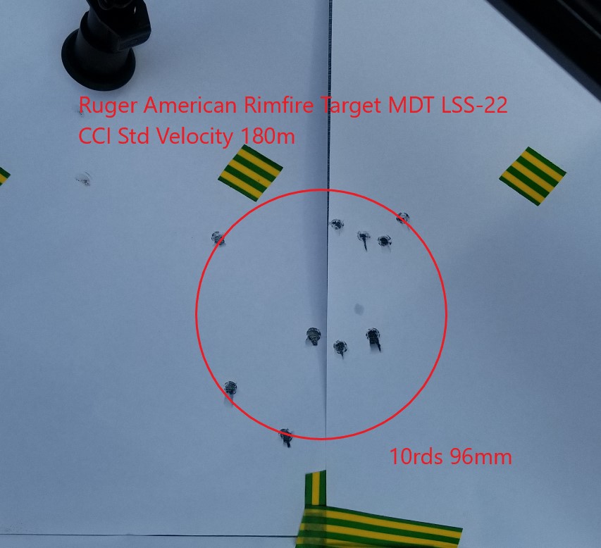

96mm 10rd group at 180m

Had another go yesterday. I fired a box each at 180m and 240m and had to do something stupid to miss the plates. So I dialed the scope up to 45MoA and tried at the 275m plate (250mm wide, 450mm tall). First mag gave me ten hits :-) Fired fifty rounds at that with just a few misses when the wind got silly. I recorded it on my phone and you hear the bullet hit the plate after I cycle a new round into the chamber. You see the spot appear on the plate and then hear the ding :-) Flight time should be 1.34 seconds, plus another second for the sound to travel back the 1163ft to my ear. I checked the wind at 4mph when it was holding steady, coming from seven to eight o'clock.
So I moved it back to 355m and dialed up 65MoA. I'm shooting over the dam at this point so I nailed the plate above head height up a dead tree, the only place I could get line of sight to it. Unfortunately, the bullet is soaring 2100mm above LoS at the top of the arc...and hitting an overhanging tree limb 60m in front of the target :-) Neat little group on the branch but none got through to the plate.

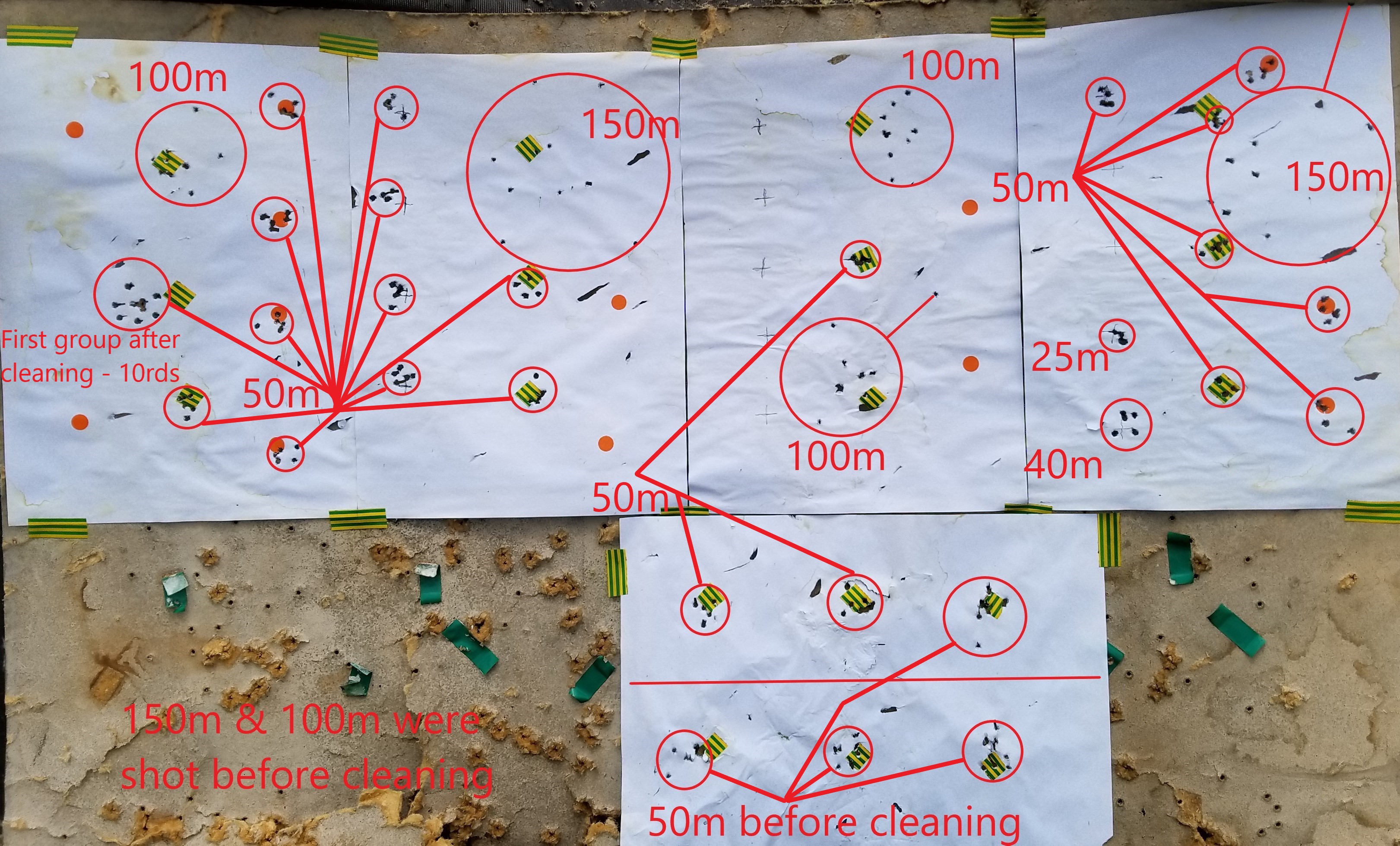

As I have several thousand rounds down the tube since I cleaned the bore, I shot some groups at 50m, 100m and 150m yesterday and then cleaned it. Prone from the bipod without any rear support, and the 100m and 150m groups I was aiming through tall grass so didn't have a great sight picture, although the bullets were lobbing over the grass.
Then I shot 180rds this arvo at 50m to see if there was any improvement. I shot the first "cleaned" groups the same way and didn't see any measurable difference. Then I put a rear bag under it and shot a lot of 5rd groups to see if there was any measureable change as the bore fouled. I finished off with a 40m and 25m group to check point of impact at very close ranges. I also shot some silhouettes nearby which sprayed fragments across my targets.
Ruger Target CCI SV before and after cleaning.jpg (1.39 MiB) Viewed 8289 times
