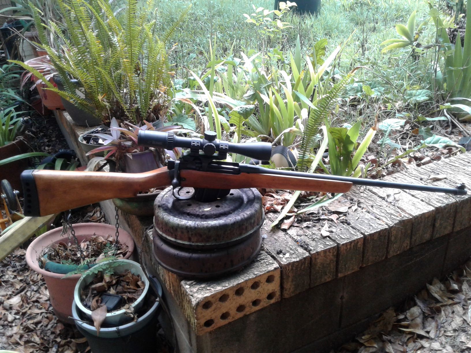

i dunno about those old brake drums in the photo for a shootin rest mate..... :lol: :lol: :drinks: :thumbsup:

bigrich wrote:i dunno about those old brake drums in the photo for a shootin rest mate..... :lol: :lol: :drinks: :thumbsup:
Old HD drums if I am not mistaken :D
