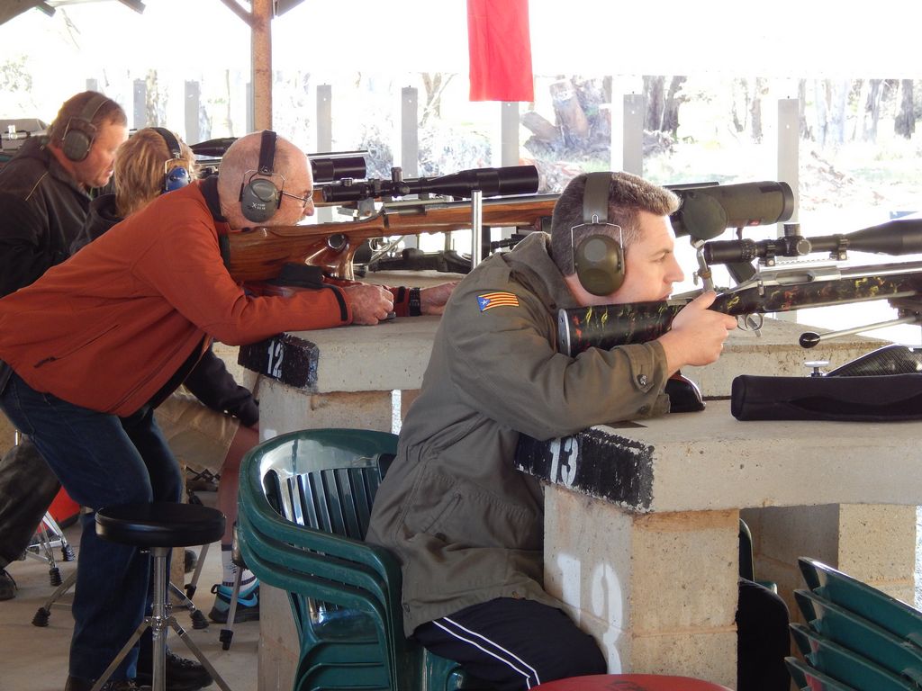

How do benchresters deal with their over-the-head-hearing-protection, inducing horizontal movement in their rifle, by contact with the comb? I have installed high rings to raise the height of the scope, in the hope that my head would be high enough for the OHHP to clear the comb but without success. I avoid any other contact by "pinching" the trigger; thumb contacting the back of the trigger guard, finger pad on trigger.
Short of cutting a piece out of the comb, I don't know what else to do. I wouldn't do that BTW. I would make another, more accommodating stock which is a lot of trouble, so I thought I would ask here first.

The easiest answer is they don't induce any horizontal movement since they don't contact the rifle stock. Next would be what comb as most benchrest rifles don't have a comb as such. High rings, how high and are they mounted on a dovetail or on a rail. How about a photo of the rifle..
Very few I know use the "pinch the trigger" method, a couple raise their head away from the rifle before they fire. I'm not comfortable with either method. My cheek and trigger hand exert very little if any pressure on the rifle, more of a very light touch just enough to know you have contact. Head is upright if the position is correct, no leaning over the stock. Slim line ear muffs and if they aren't enough protection then ear plugs as well.
Photo of a friend sitting at his rifle at a 500m Benchrest Competition.

Thanks Apollo. Every picture tells a story. That's an excellent pic :D :thumbsup: My ear muffs are "industrial grade" Peltor X4A 290. Definitely not slimline; bought to protect what little hearing I have left. Also, mine is a CZ455 with a synthetic sporting stock. Nothing fancy. Rings are on the factory dovetail and maybe I need a rail too, eh? :) Come to think of it, I could have been more upright, So there's something to work on and I don't like the pinch method much anyway, so I'll ditch it now.

Even with my Industrial Peltor muffs I never had much of a problem with any rifle other than if I didn't sit properly and have my stool at the right height they would touch the top of the stock just. Re-position sitting position and solved, mostly stool too high so lower it and sit upright.
