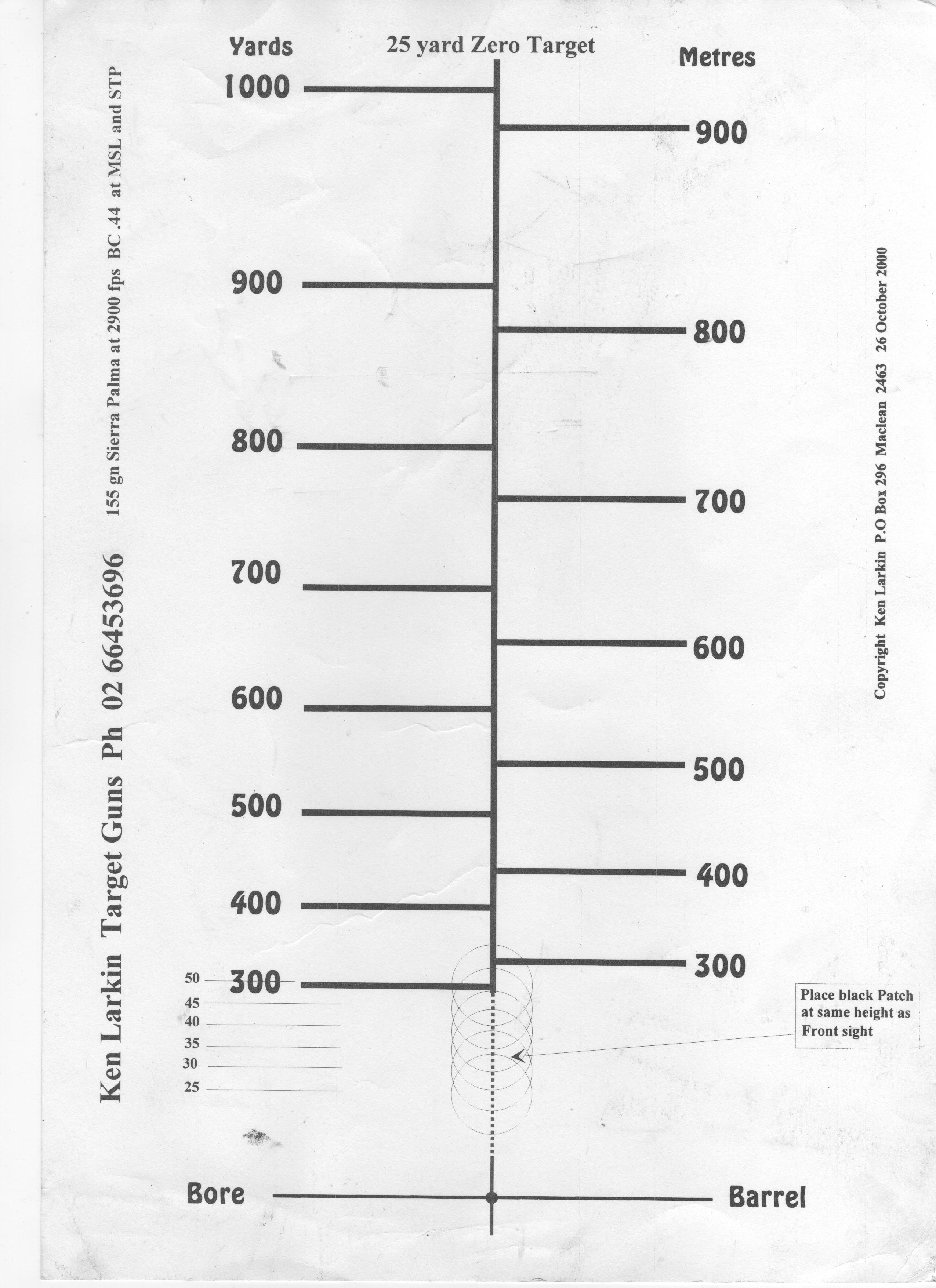

G'day duddley75,
Use a 25m Zero Target, or make on yourself. Bore sight and shoot from a fixed rest with rear bag, measure 55mm up and mark a spot and that is your 300m zero, measure up 170mm from the 300 spot and that is your 800m zero, using 155g projies at 2900fps. A ballistic calculator can refine those numbers for different bullet weight/velocity loads. Or contact the bloke whose details are on this target, Cheers,
Zero target.jpeg (814.2 KiB) Viewed 13506 times

Post by Blr243 » 19 May 2020, 5:43 pm
No 1 mk3. I am very interested in this funky little chart you just posted , I never seen them before. Is there a way I can punch in some details to a computer eg cal, speed , pill weight ballistic cooeficient etc , and it will print out one of these charts on a4 piece of paper ? So it’s all specific to my set up ?
Posts: 4800
Re: 100m range for Centerfire zeroing
Post by No1Mk3 » 19 May 2020, 5:55 pm
G'day Blr243,
I have been told that ballistic calculators can determine rises needed to make your own chart but I don't know if any program inclues the ability to print Zero Targets. i have old Zero Targets for Fullbore 308, as well as a couple of Ken Larkins A5 targets and a few old Parker Hale 303 25 yard Zero Targets which I use to hand make m own now. I think if you called Ken Larkin on the phone number on that target I posted he would be able to answer your question. Hopefully the number is still current, I've had these targets for a while, Cheers.

Post by No1_49er » 20 May 2020, 9:26 am
No1Mk3 wrote:G'day duddley75,
Looks like a great little (?) target, No1.
Can you give us a precise measurement (mm ?) from the bore/barrel spot to the 1000yd mark so that we can scale the pattern correctly, for whatever sized backing paper it is printed on.
49er
No1_49er
Posts: 1013
Post by No1Mk3 » 20 May 2020, 1:24 pm
G'day No1_49er,
On this target, for the ammo specified, the rise from bore to 1000yd is 270mm, When using Zero Targets the vertical line must be set with a plumb bob accurately to avoid windage errors and the distance from muzzle to target must be precise (within an inch). The advantage of 25yd Zero targets is the ability to set up anywhere, to easily see fall of shot without a scope, to pick vertical errors with the sight (remember these are/were used only by fullbore shooters using Central or Parker Hale type sights), or show canting errors by the shooter. Folks reading this should also understand Zero targets are intended to put you on the target at ranges selected, actual POI must be confirmed at that range giving regard to your own rifle/ammo characteristics, elevation above sea level of the range you're shooting on, humidity/temp variations etc. The best 303 shooter I've known was the late Richard McClean who used the Parker Hale Zero Target to set up and check his sights before comps. No matter where he shot, his 1st sighter at 600 was always in the black, often a 5, and then he would adjust for V. Cheers.

Post by George the Greek » 04 Apr 2021, 10:14 pm
Hello to all. Do you might know where can I find zero targets like this one? Preferably in pdf although if there is any online store to ship them internationally it would be ok because I live in Greece.
Thank you in advance
Post by bladeracer » 06 Apr 2021, 6:08 pm
George the Greek wrote:Hello to all. Do you might know where can I find zero targets like this one? Preferably in pdf although if there is any online store to ship them internationally it would be ok because I live in Greece.
That's too blurry to read details but it looks extremely simple to draw it yourself.
Do you have a higher-resolution image?
I would get a roll of newsprint (your local paper should sell part rolls) and draw it yourself.
Posts: 13927
Post by George the Greek » 06 Apr 2021, 7:35 pm
It's that simple. In order to draw something like that i need to have the actual dimensions of the proprietary or else it would be uncalibrated.
George the Greek
Posts: 3
Post by bladeracer » 06 Apr 2021, 7:48 pm
What is it calibrated for though?
If you want to make your own to suit a specific cartridge that would be very easy to do.
George the Greek wrote:It's that simple. In order to draw something like that i need to have the actual dimensions of the proprietary or else it would be uncalibrated.
Posts: 13927
Post by George the Greek » 06 Apr 2021, 7:57 pm
In order to have a 25meter zeroing target i must know the specific elevation of the bullet relative to the center of my aiming. And o don't know that.
bladeracer wrote:What is it calibrated for though?
George the Greek
Posts: 3
Post by bladeracer » 06 Apr 2021, 8:28 pm
You need the bullet's BC, weight and velocity, your zero range, and offset between line of sight and bore axis. From that you (or I) can plot the target dimensions.
Posts: 13927
