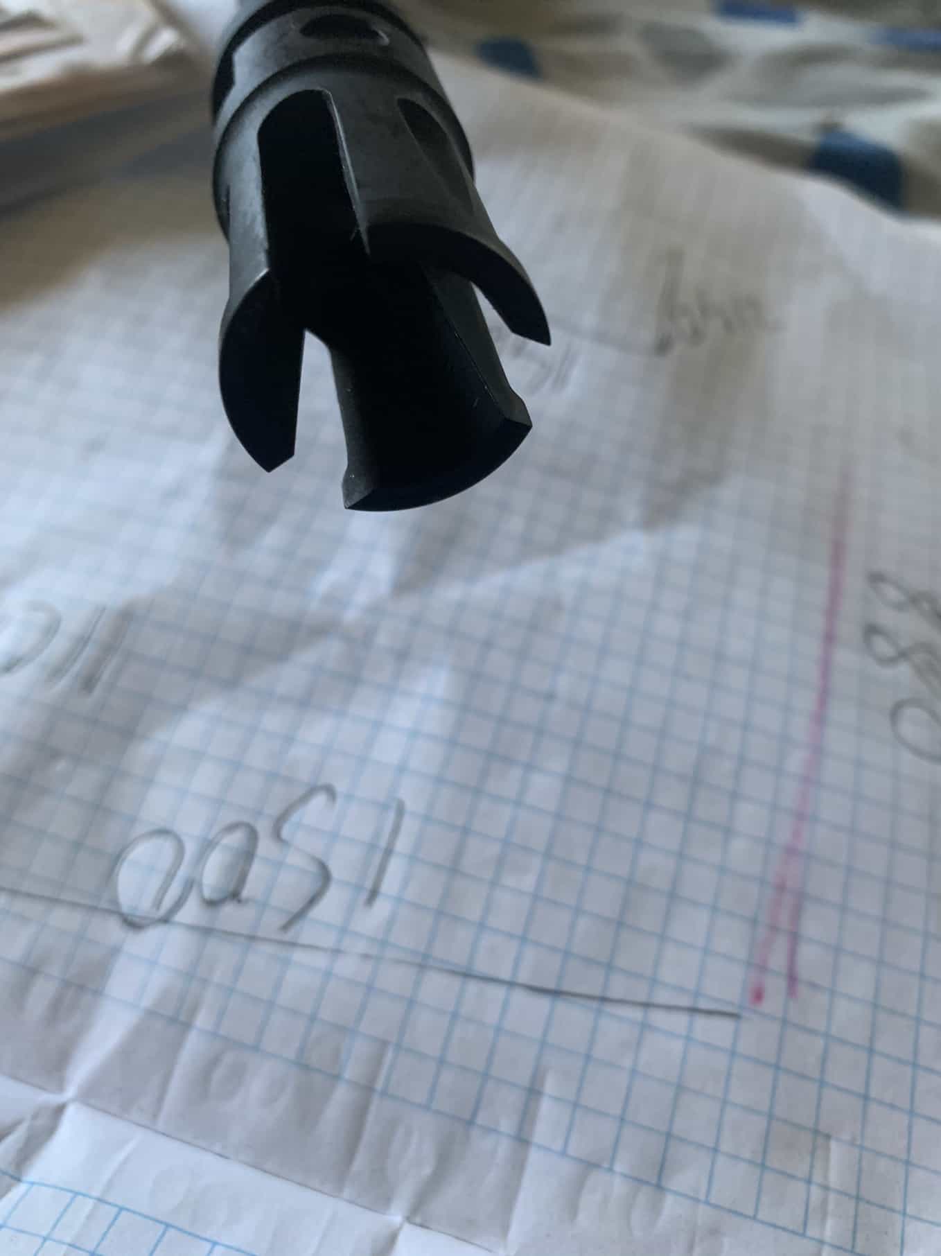

I normally remove them weather I’m range or in the bush but my new 308 is quite lightweight... at least in the early stage as I get comfortable with the recoil I will leave it in place .... it’s a 3 finned 3 slot brake called pws triad. The symmetry looks odd ... I would think that a fin or a slot should be directly above the top centre of the barrel. Does it matter . Would you try to find a washer that results in better alignment ( this could be time consuming). My initial thought is to release it ., coat the thread with loctite and retighten it so one of the slots is in the 12 o’clock position...ie top centre of barrel. I don’t want to be seeing how it goes and then changing it. I don’t really have time to be sighting in at ranges more than necessary

Maybe I’m being too ocd. The pic showing the entire brake is taken by me as I stand looking down on top of the barrel

Not really a brake, more a flash hider, by the looks.

Post by bladeracer » 08 Jul 2020, 10:24 am
I would try shooting it first to see if it is a problem.
With three ports you would ideally want one opening directly upward.
You can order indexing shim packs from Brownells, or put it in a lathe and take off enough for it to index it where you want it.
I don't know how well Loktite will work due to the force not being constant as it would be when tightened down against a shoulder.

trekin wrote:Not really a brake, more a flash hider, by the looks.
I agree, this device has no surfaces for the gas to pull against so it's not going to affect recoil at all.

Yeah, more tacti-cool, barrel bling, than useful. One slot should be facing verticly down so you do not get mirage from hot gases leaving the barrel if you need a fast follow up shot. But watch out for grass fires if firing prone while using hot loads.

Agree with others. This is a flash hider and unlikely to mitigate recoil at all.

If you have enough thread you can also use a locknut to index it.

It's aligned correctly, as others have said it is just a flash hider though. I also own some PWS muzzle devices and the correct alignment for them is for that circular section approximately where the threads are (which has a faint psw logo etched into it) to be facing upwards like it is in your photos.

If you index it with the slot facing vertical, you will then have two slots facing 45 degrees downwards which could blow dust all over you. Do you need anything hanging off the end of a 308?
