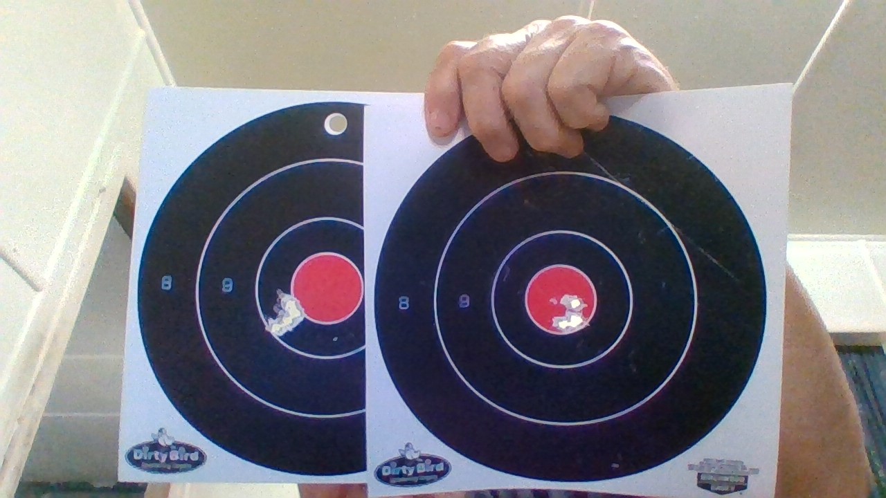

Post by Grandadbushy » 10 Jul 2020, 4:25 pm
Here is the target I settled on it's good enough for what I do :thumbsup: :drinks: one on the left is my 7mm mag :thumbsup:
Grandadbushy
Posts: 391
Re: Secrets of the Houston Warehouse
Post by TassieTiger » 10 Jul 2020, 6:22 pm
That’s very nice shooting GDB - very nice indeed - especially with 7mm - that’s very cool. Well done!!!
