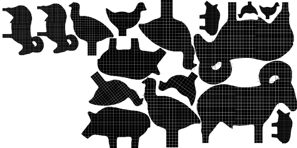

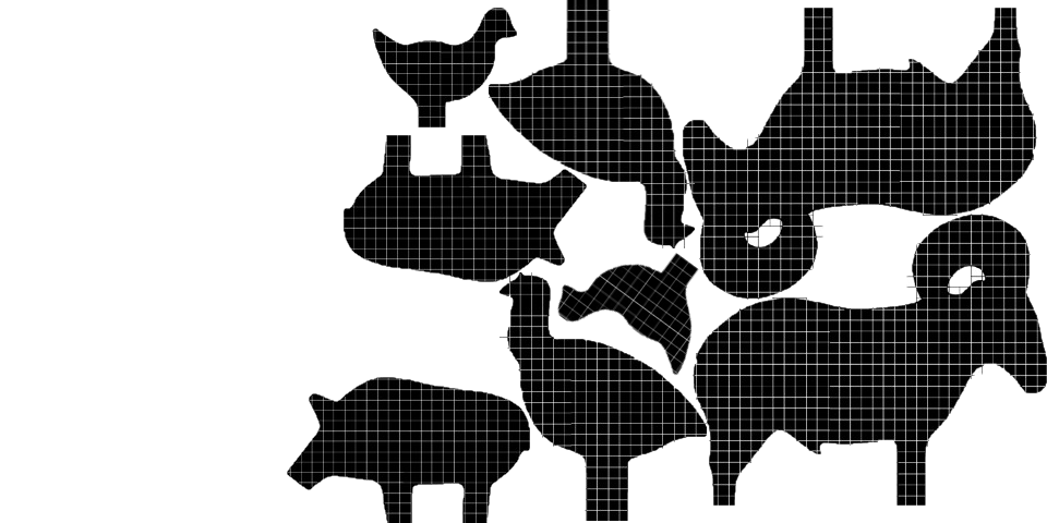

Post by bladeracer » 25 Jan 2022, 4:24 pm
If it helps anybody, I sized the silhouettes to 10px per inch and placed them on a 2400x1200 (960x480px image size) sheet.
One pair (two of each animal so you can set one facing right and one left) at full-scale requires a three-quarter sheet - the offcut is about 750mm by 1200mm.
Silhouettes one pair full scale on 2400x1200mm sheet.png (200.35 KiB) Viewed 4746 times
One pair at full-scale and one pair at half-scale requires almost a full sheet - you have an offcut about 750mm-square.
Silhouettes one pair full scale plus one pair half scale on 2400x1200mm sheet.png
Silhouettes one pair full scale plus one pair half scale on 2400x1200mm sheet.png (274.92 KiB) Viewed 4746 times
I'd expected the shapes would probably have been designed to neatly fit into standard sheets with minimal waste, but I can't work out the puzzle down to that level :-)
