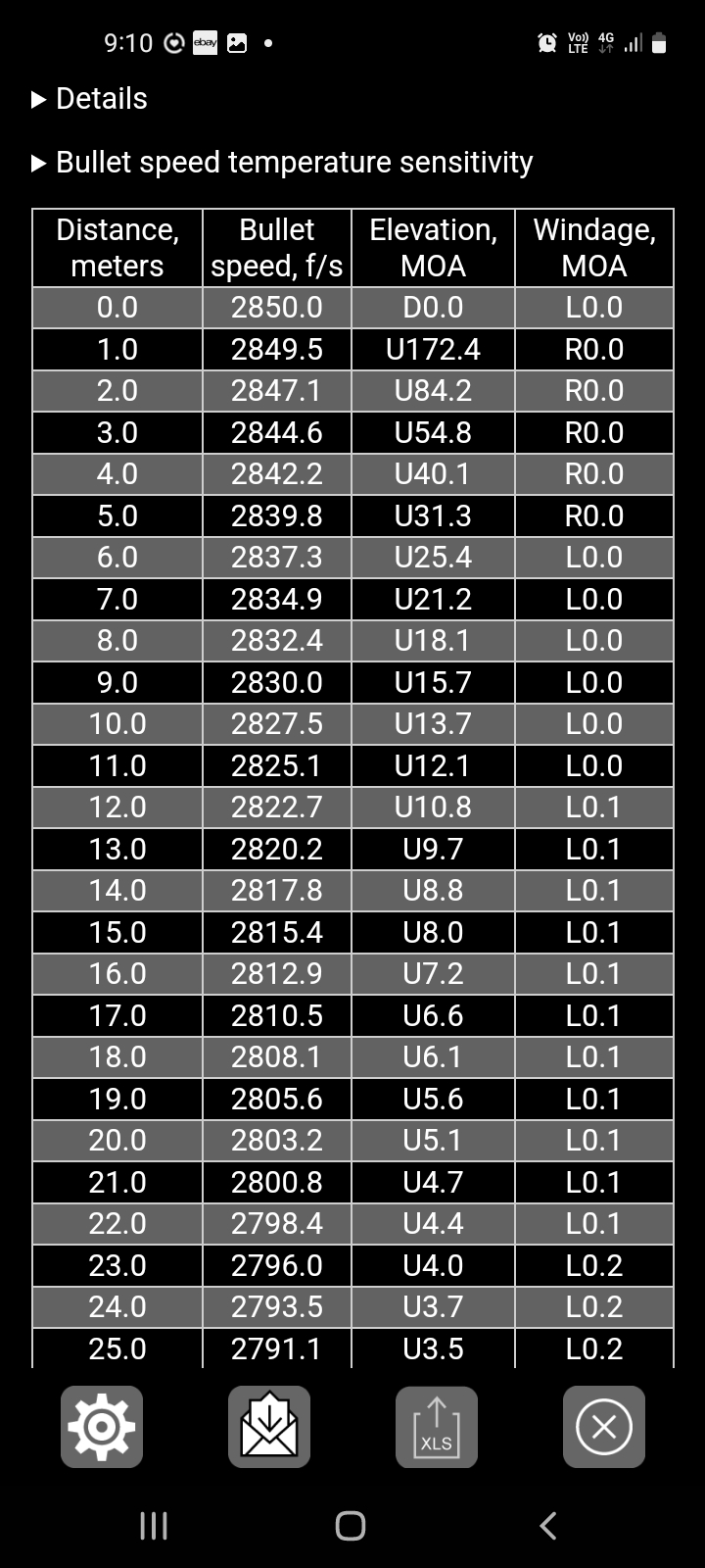

Post by on_one_wheel » 22 Oct 2023, 8:43 am
JohnV wrote: . However NO single BC can predict a full trajectory from start to finish . It takes a range of BC's in velocity steps along the trajectory path .
I'm not exactly sure what you mean,
Do you mean from zero metres to whatever with every meter calculated in-between like this ?
Screenshot_20231022-091004_Strelok Pro.jpg (295.97 KiB) Viewed 8203 times
Re: ballistic phone apps for an android phone
Post by JohnV » 22 Oct 2023, 8:43 am
Wyliecoyote wrote:John i agree with you about using the app on a device in the field. With Strelok i calculated my drop then printed out a range card incremented in 25 yards from 0 to 800 yards along with a 5 mph windage value. I reduced its size and laminated it and it goes with the rifle and in some instances attached it to the buttstock for quick access.
New generation range finders should have the ability to load and store this information in a more advanced way that current generation Leopold TBR range finders do with limited standard cartridge information. Burris does it with their digital scopes so it should be expanded more broadly to a handheld range finder.
Yes mate smart move , once you do a bit of that type of shooting you soon see the limitations of too much technology and too much wasted time . I only had an older model range finder it has no memory . That's why Military snipers have an offsider to handle all the calculations and target identification etc. and feeds that info to the trigger man so he can concentrate on the target in the scope and just move his turrets when required . A single shooter doing it all and fiddling with a ballistic app is too stressful and it can screw up the shot .

Post by JohnV » 22 Oct 2023, 9:13 am
JohnV wrote:
My comment about the range increments was to address the original OP's need to see his close range trajectory data of where the bullet starts to cross the line of sight . I suggested 5 meter increments in a ballistic program or app but 1 meter if it's possible would also work but you must give a far zero like 100 meters to see the negative drops from the muzzle to the zero and where it starts to flatten out .
The comment you linked to has nothing to do with that .
Most ballistic programs and apps only ask for one BC entry and one single BC at one single velocity boundary can not predict a trajectory that well . It's close but if a program can except 3 BC's and the velocities they occur at then that will give a better firing solution . When commercial bullet makers quote a BC on the bullet box or website it is usually the largest BC figure in a string of calculated BC's at different velocities . The largest number is more impressive for sales reasons . Some will quote an average for that string of BC's and that is a bit more real . Some will quote a G1 BC because the number is bigger and more impressive when the bullet is in fact a G5 or G7 drag function that gives a lower number on calculation but will in fact be more accurate in a program because the correct drag function for the bullet is being used .
If you model a bullet in JBM Point Mass program and select include BC's you will see the print out of all the BC's along the trajectory path . Real Military snipers use multiple BC's in firing solutions but they don't tell anyone .
I hope that clears it up I don't know what else to say let me know if it don't and I will try again a different way . Some ballistic programs have a custom BC function entry that usually allows multiple BC's and velocity boundaries to be entered but sometimes they only accept a single velocity entry not a high and low velocity so just pick the velocity in the middle of the high and low that is quoted .
