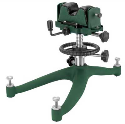

Post by SendIt » 21 Aug 2014, 2:07 pm
jennageit wrote:The target rifle was set up by the guy teaching me. He placed it in the holder (if that's what you call it), had a quick look through the scope and then got me sorted out. I used the lever on the mounting of the holder to adjust where I was shooting. I didn't touch the scope at all, and only saw my instructor take the cover off each end of it, he didn't adjust it.
That would have been ad adjustable shooting rest. Something like this, yes?
caldwell rock br 1,000
jennageit wrote:At one stage, when I looked through the scope, it was lined up way too high, and when I told my instructor, he fiddled with a dial at the front of the 'holder' to lower it down, asking me if that was okay, etc. At one stage he lowered it too much, so I asked for it to come up about half an inch. After that, with me using the lever to adjust it, I ended up with some pretty good shots, and my last two being two bullseyes on two separate target circles.
So there you're just moving the rifle around which has nothing to do with the scope. If the scope wasn't zeroed then you'd still not be hitting where the crosshairs appear.
From what you've said it sounds pretty clear to me that the scope just wasn't zeroed, and was half an inch to the right. It's hard to tell when you're only doing a single shot at each target because you have nothing to compare to.
Next time shoot some 4 shot groups. Not single shots. Assuming I'm right about the scope just being off, you would have got a 4 shot group about half an inch right of the target. Then you'd adjust your scope a few clicks to the left and shoot a new group at the next target. You'd have found the group was closer to the bulleyes. Repeat that process until the crosshair and the group lines up.
