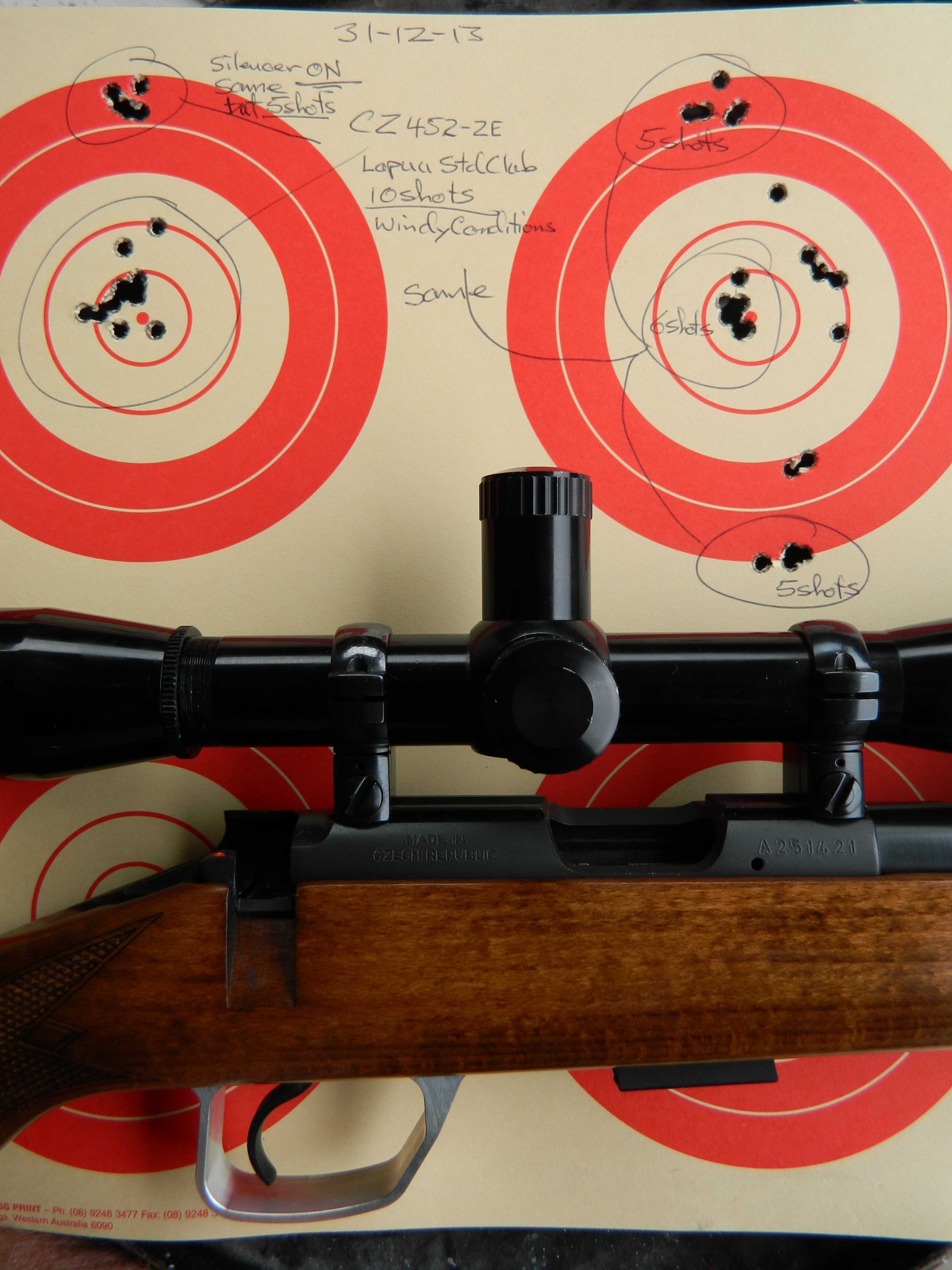

Gwion, before I shoot any group, I already know what the problem is and whats causing this problem!
Me!!!
LOL!
Homer
Homer
Posts: 337
Re: Analysing Small Bore Groups for Problems
Post by Homer » 20 Feb 2016, 6:26 pm
G'Day Fella's,
Me!!!
Here is just one example, see lower right group and the single flyer!
CZ 452-2E .22LR.JPG (1.87 MiB) Viewed 6517 times
LOL!

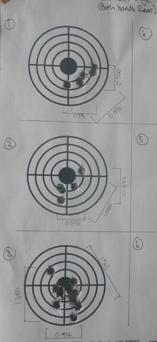

Post by Gwion » 21 Feb 2016, 8:39 am
Fair enough, Home-boy. But that's a touch over simplified, isn't it. I mean, obviously you are always the problem... :D
Is it your trigger control? Then what is it about your trigger control....
Is it your hold on the rifle? What about it?
Stance/positiion????
And so on, and so on....

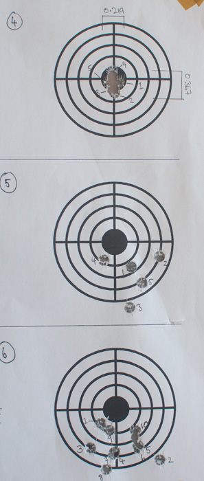

So, what was i doing wrong here???
And what did i get right on the first group of this trio???
Everything was the same, here. Same rifle, same load, same scope, same bipod, same rear bag. The difference was the consistency of my position, grip and pre-load on the bipod. These were my first ever groups shooting from a bi-pod at 100m; 223rem.
