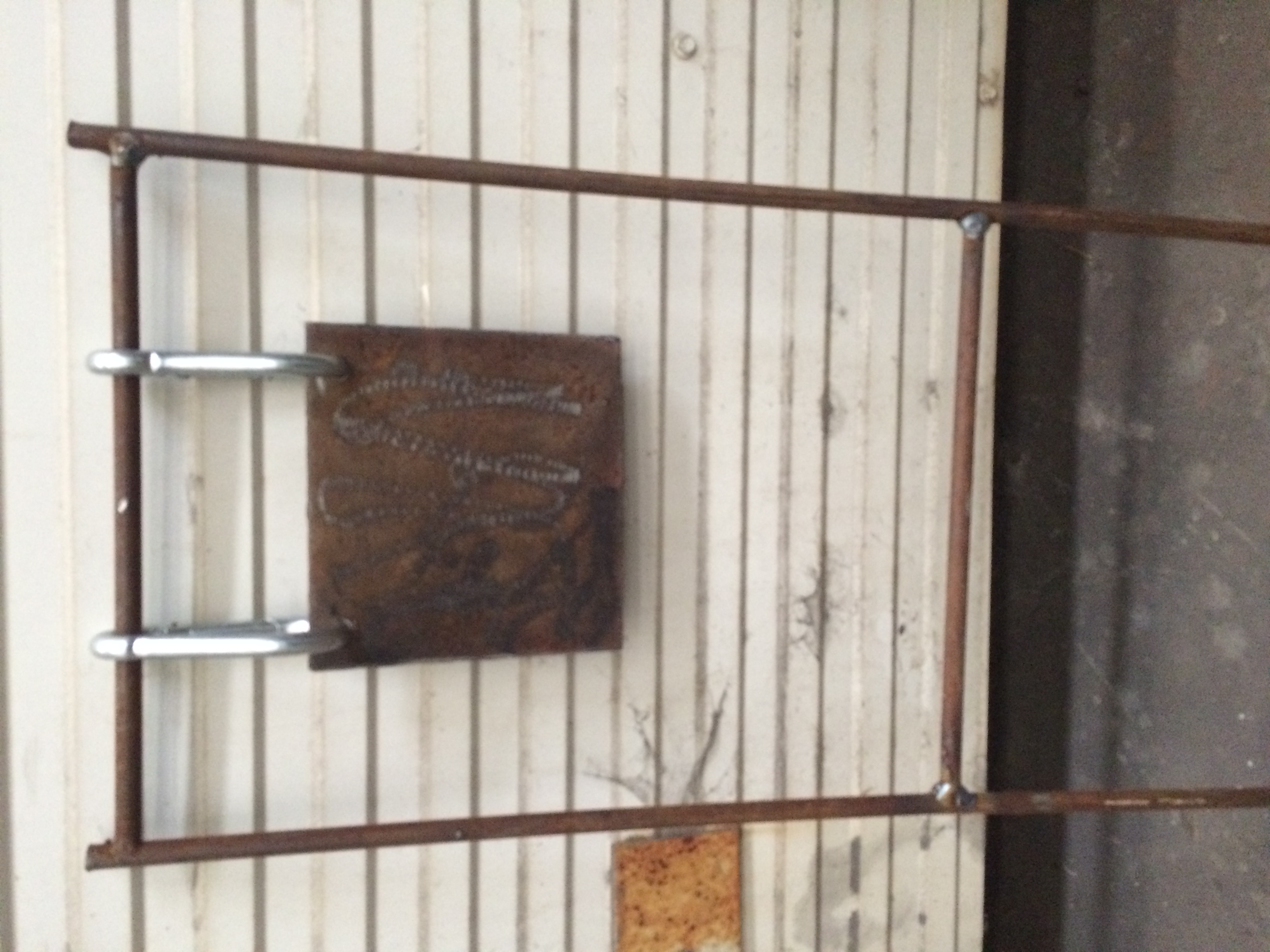

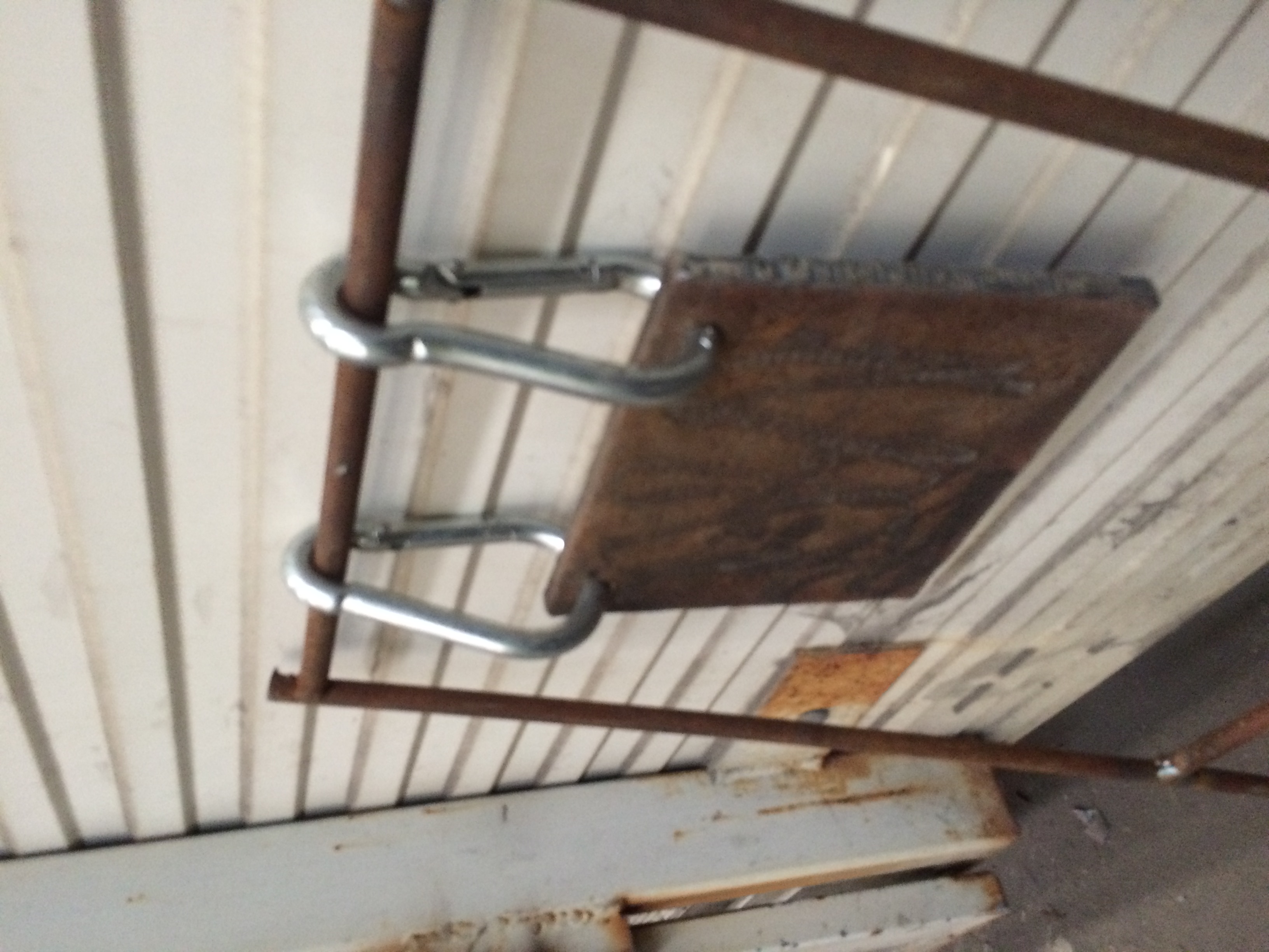

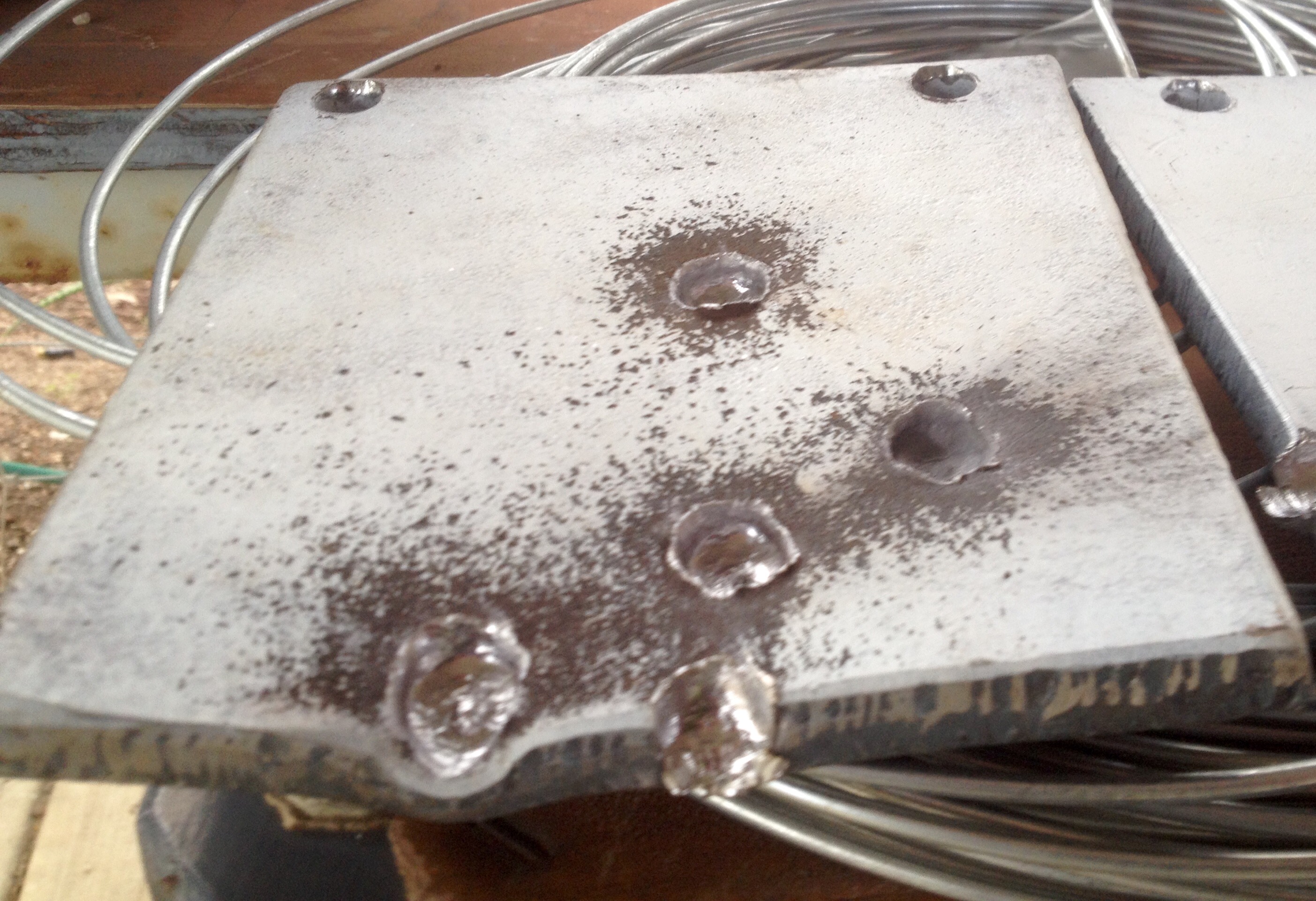

Going to the range this weekend. Got my mate who goes shooting with me to whip these up.
12mm, fairly hard steel. Going to spray paint them bright yellow or orange. Got 8 of them. Bit of an experiment with the carabiner clips, had a few floatin around.
150mm X 150mm

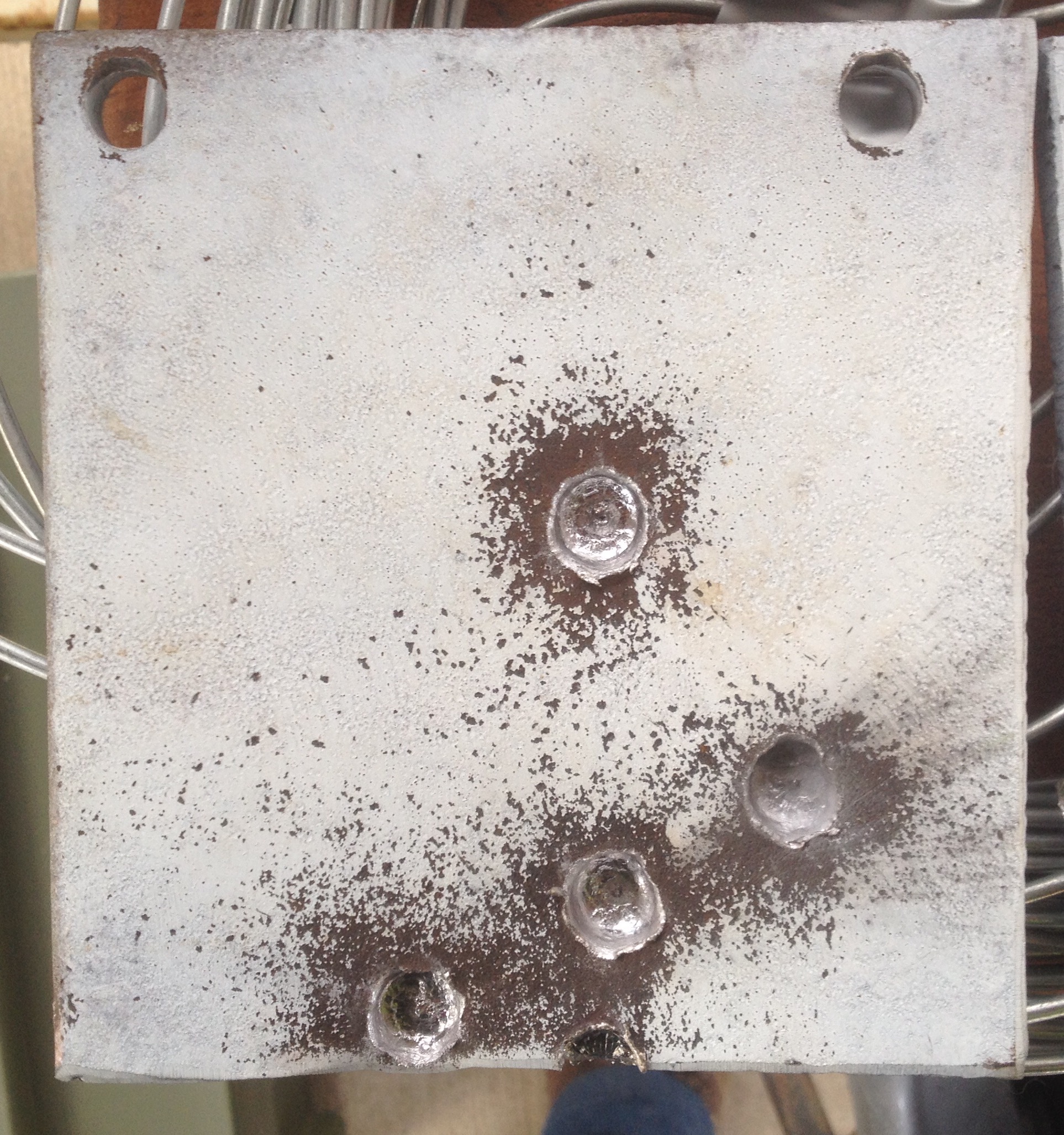

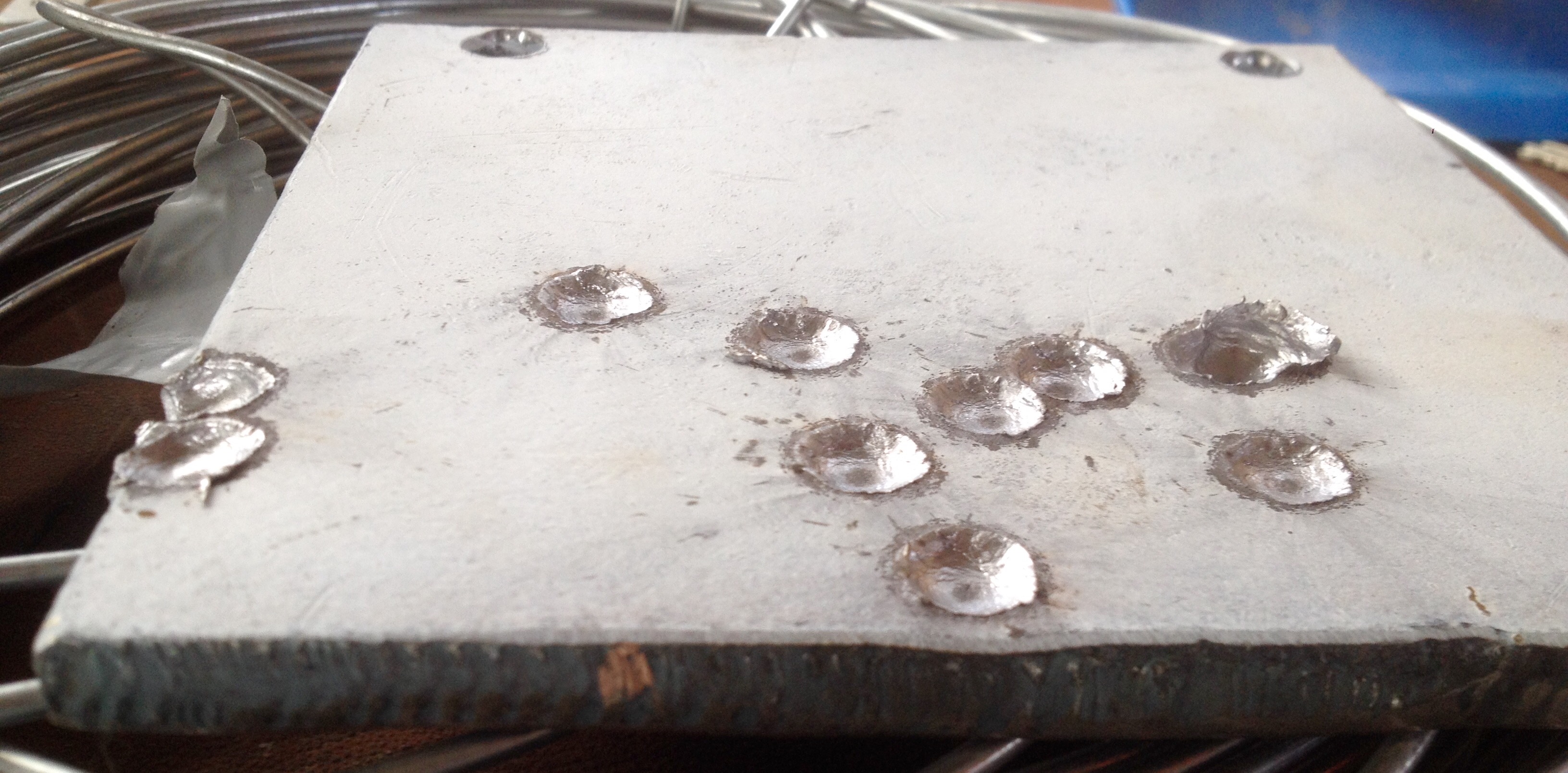

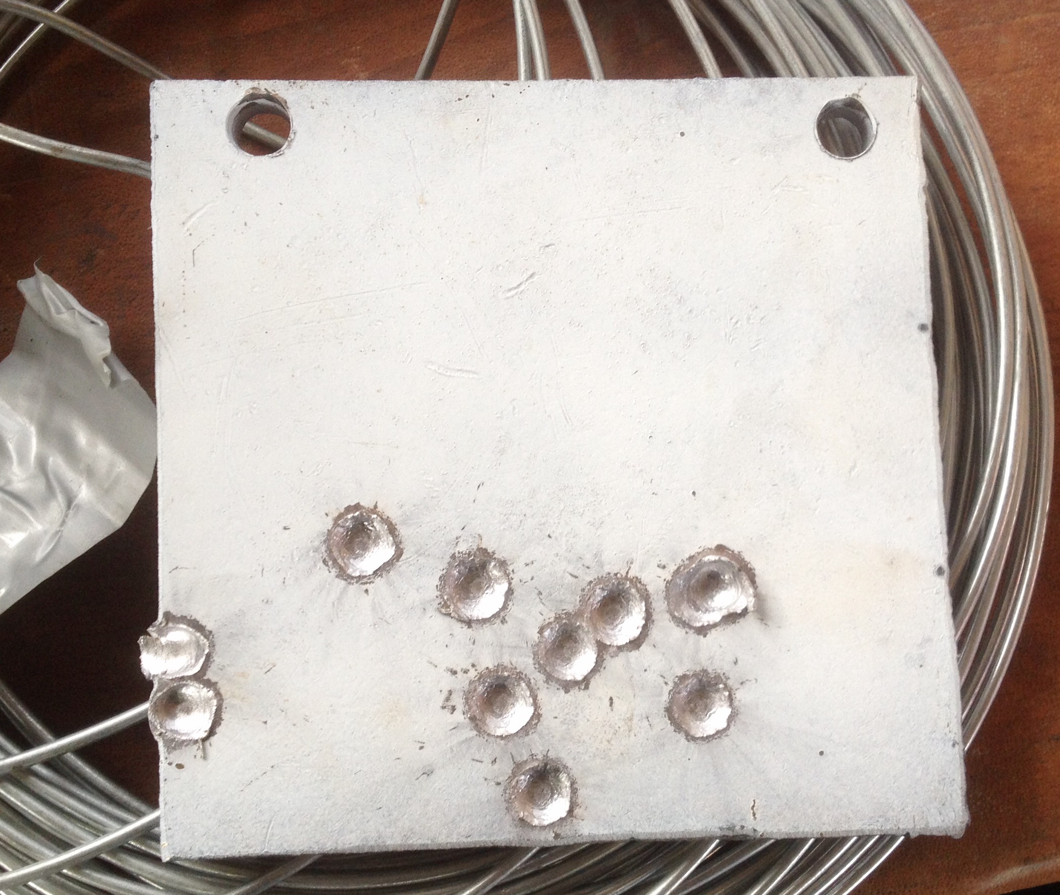

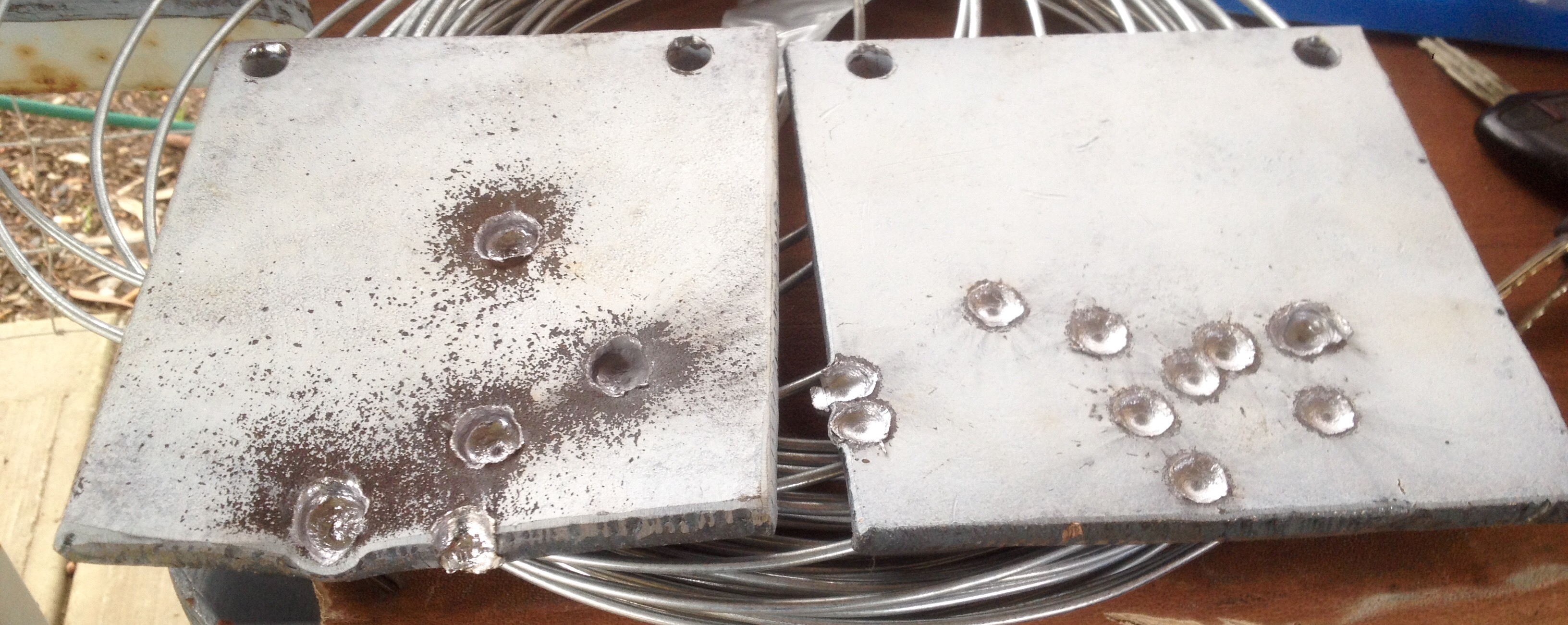

So I went to Little River range on Sunday. Weather was crisp and cool with very little wind, perfect day for shooting. Painted the gongs with white primer as suggested and they worked well. Set them up at 200m, 250m and 300m. They took a beating but held up well.
.223 at 250m
.223 at 250m , 55gr OSA blitzking
.308 at 250m 168gr Sierra MK's
.308 168gr SMK's
.308 left, .223 right
We continued to pummel them all day. Put over 50 rounds into each with zero penetration, I think I could safely get two or three sessions from each plate. More with the .223.
And tapping gongs with a .22 at 200m is great fun. Gongs in general are great fun at the range and highly recommended.
I didn't even have to be looking down range to tell if my mate had got a hit, very satisfying .

TBH they lasted better than I expected, mate has access to free steel so I'm happy if we can get 2-3 sessions out of them. I have a small STS target and it works well but they ain't cheap.
The carabiner clips lasted ok, certainly didn't take a direct hit too well though. Need to look at more durable mounting options.
The can of primer I got promised x2 coverage, it worked very well with one quick coat. As suggested the white was very easy to see and get on target.
