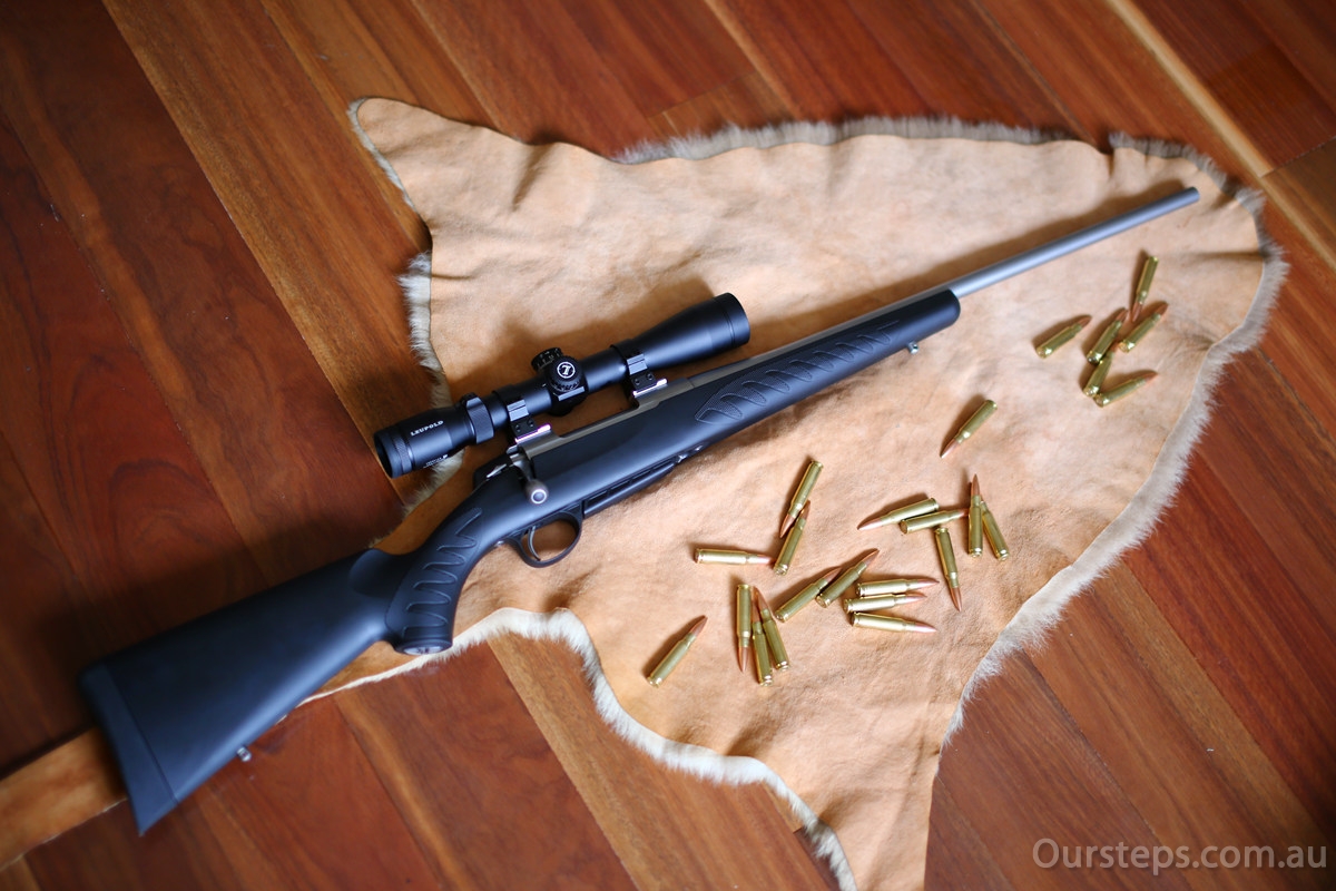

SAKO A7 LPS special, nearly tikka's price, it's light enough for hunting and I need a light 308 so why not? :D
I know it is not a "real" sako but the trigger, bolt, magazine and stock all a little better than tikka, it's good enough for me as a hunting rifle

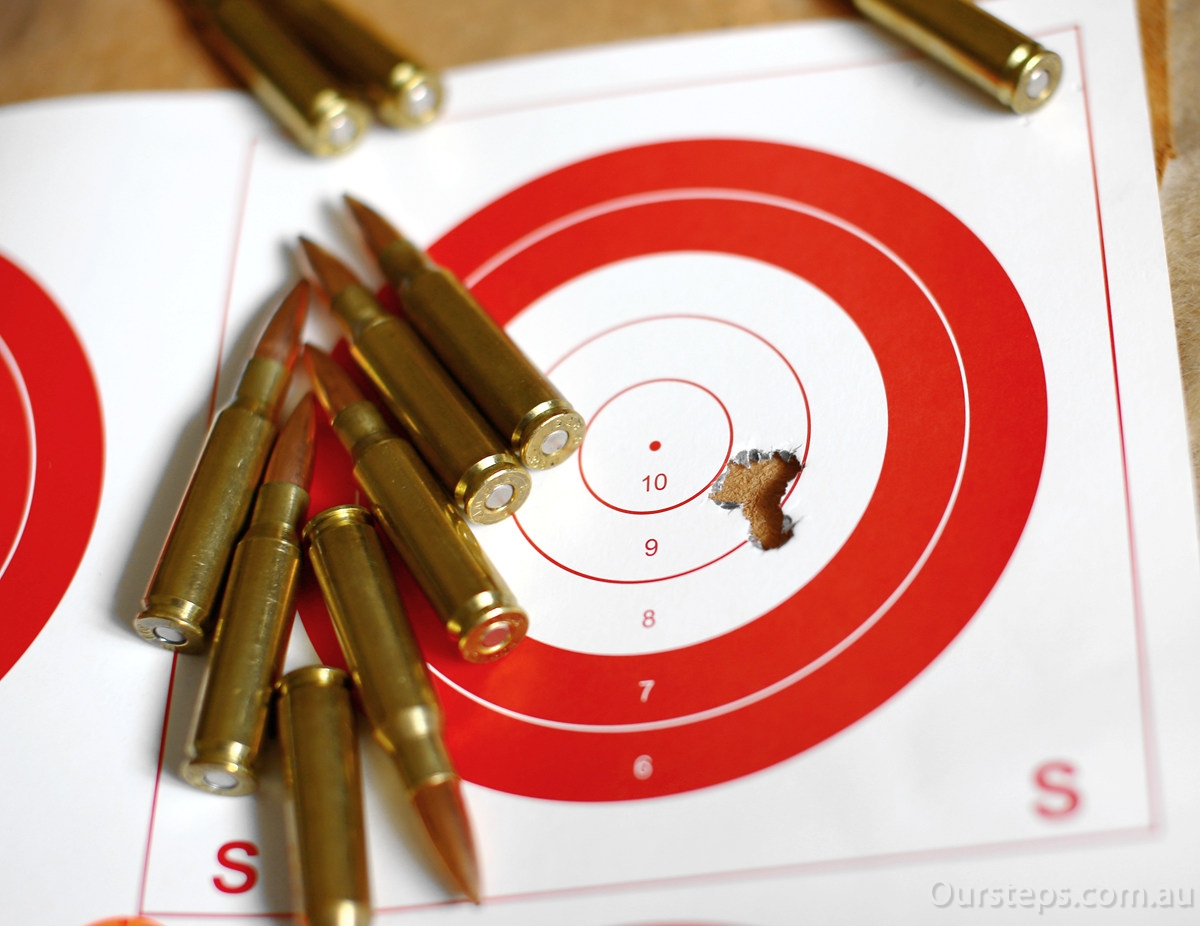

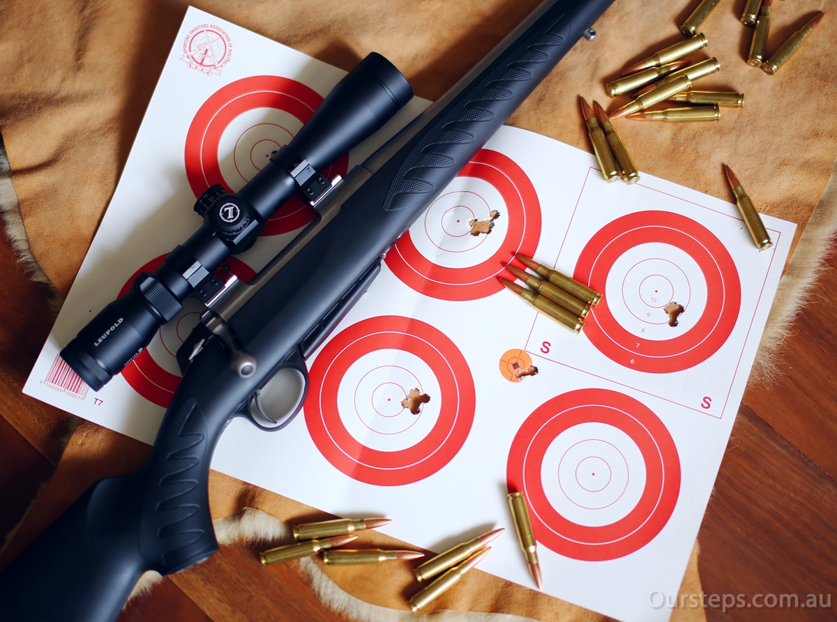

first time at St Mary's, clean the barrel, sigh in the scope and tried some 5 shot groups at 50 meters

Post by SHV » 26 Jun 2016, 11:44 pm
this one done by my friend, he loves the trigger too

Post by SHV » 26 Jun 2016, 11:48 pm
this one is mine, 4 shots are good but one fly :crazy:

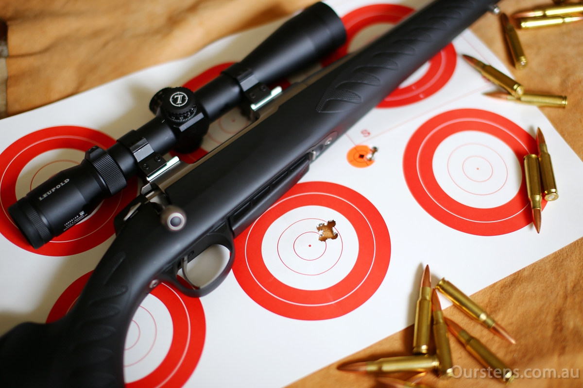

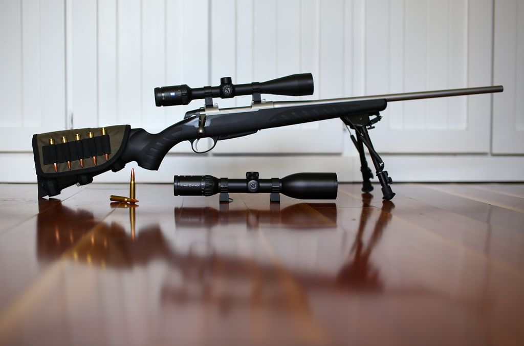

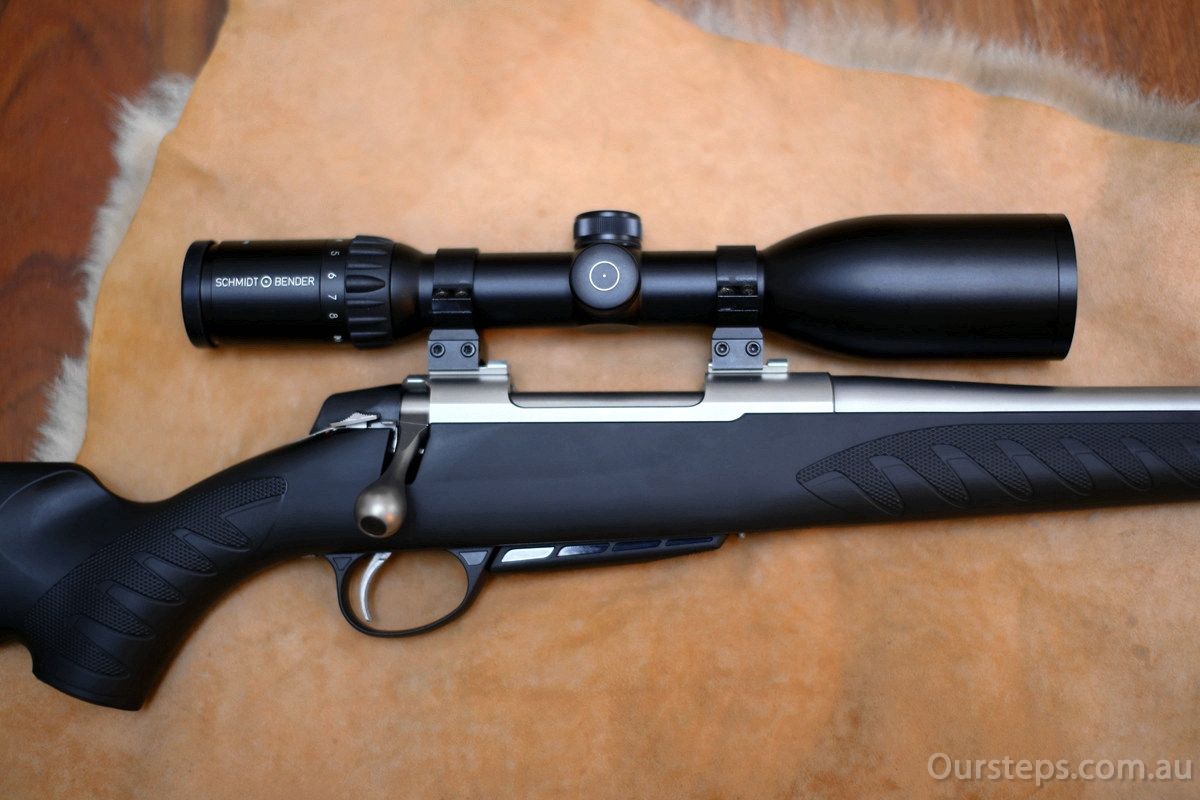

Post by SHV » 26 Jun 2016, 11:57 pm
looks like this rifle got potential and the 3-9x40 is not good enough for "target" shooting, so I bought a 3-12x50 for it, hopefully can see the target a little closer and more comfortable for long time shooting.
SHV
Posts: 1780
Re: SAKO A7 and range report

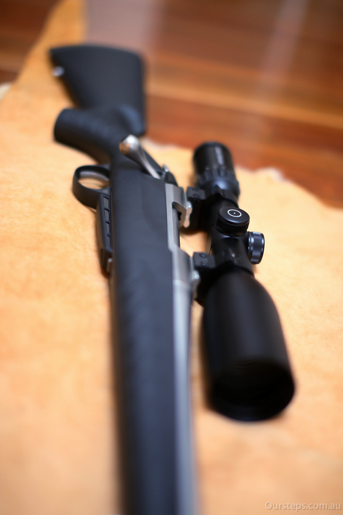

Post by SHV » 27 Jun 2016, 12:01 am
looks good on the rifle, not too big as I thought before
SHV
Posts: 1780
Post by SHV » 27 Jun 2016, 12:07 am
hopefully can get chance to try the new scope this week at range

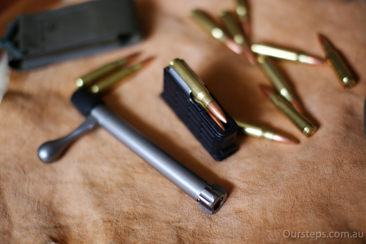

I like my Sako's, I have 6 of them. Haven't really looked at the A7, I know they were built as a budget line to compete in that market in the U.S.
Looks like the result of letting a "daddy" Sako spend some time with a "mummy" Tikka and you get "junior" ;)

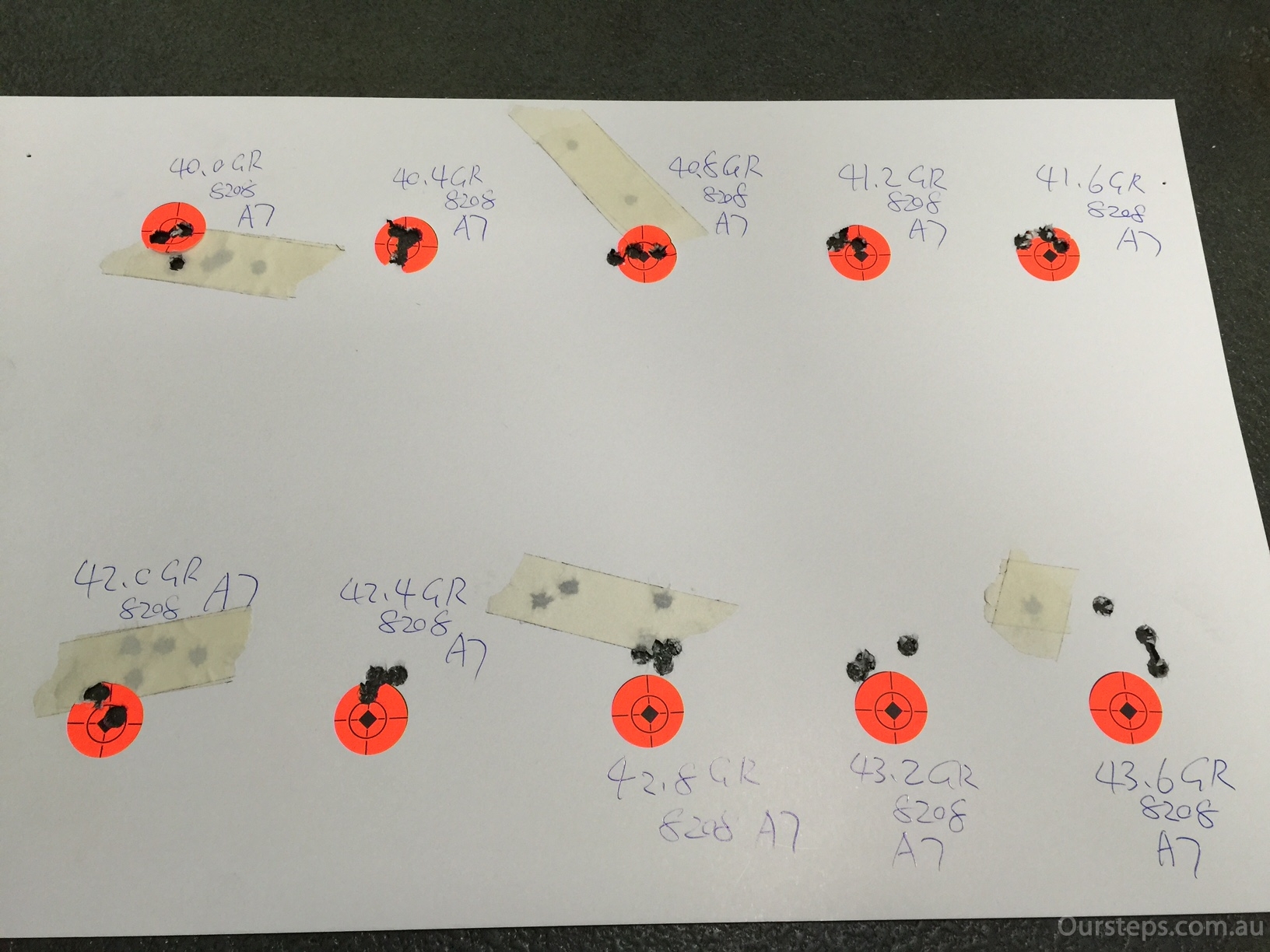

Post by SHV » 19 Jul 2017, 11:43 pm
BM8208 different load, no big difference, hope I can shoot 100 or 200 meter but the only place is St Mary's 50 meters....
SHV

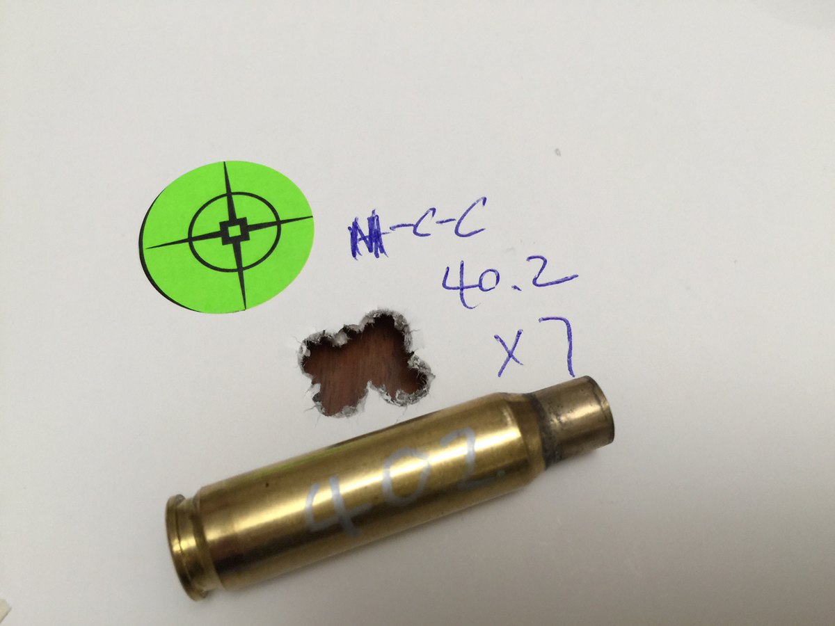

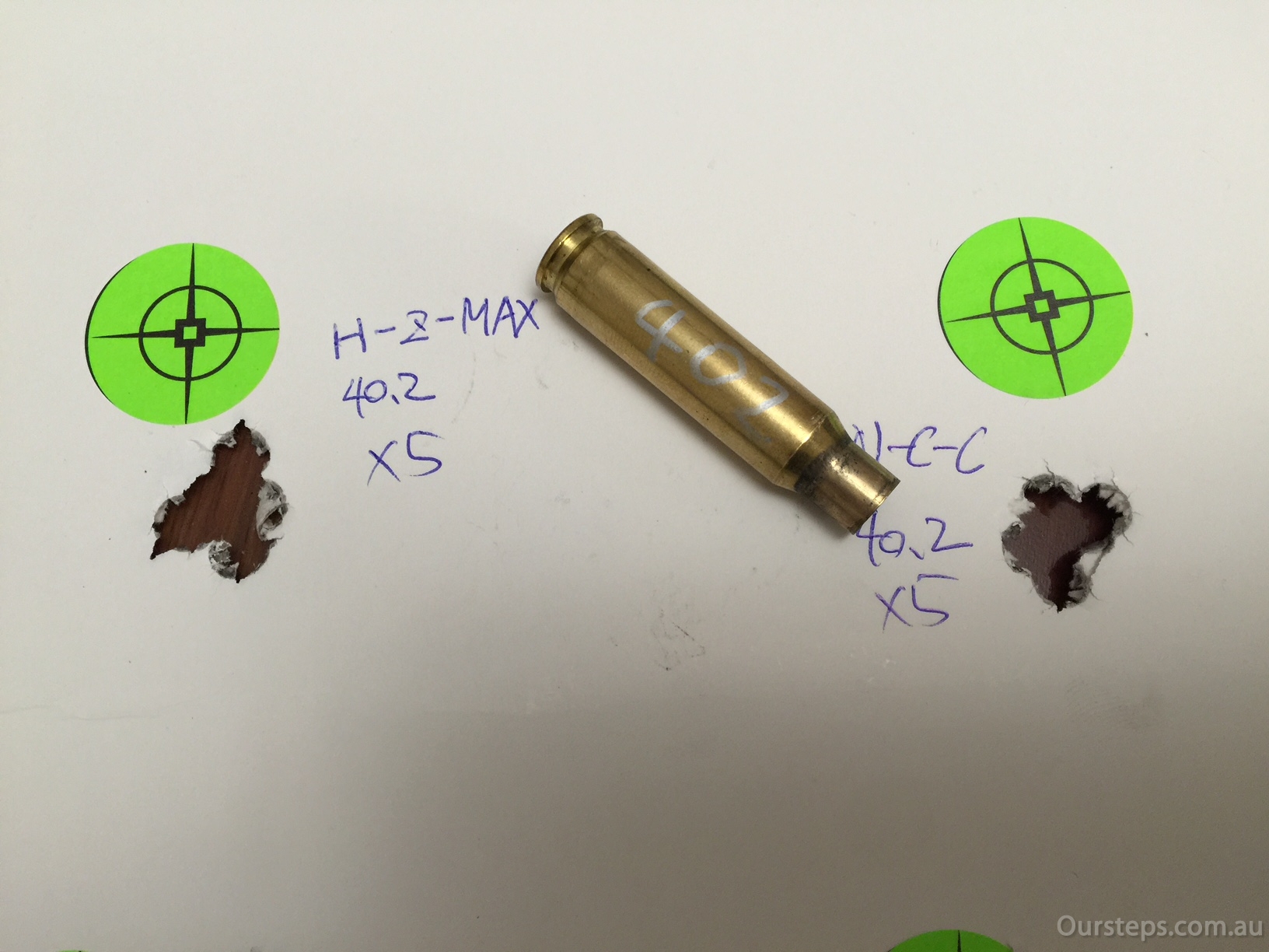

Posts: 1780
Post by SHV » 19 Jul 2017, 11:44 pm
two different projectile 5 shot each, 40.2 gr BM8208
SHV

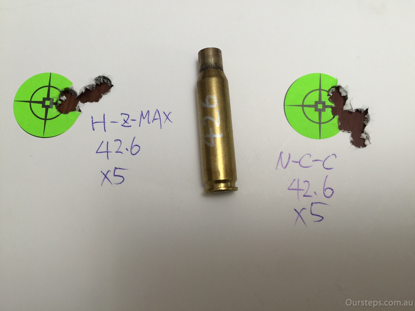

Post by SHV » 19 Jul 2017, 11:48 pm
two different projectile 5 shot each, 42.6 gr BM8208, feels close but not the best, next time should I try 42.1---42.3---42.5---42.7---42.9 5x5 or 5x10?
SHV
Posts: 1780
Post by Gwion » 20 Jul 2017, 7:11 am
Mate. At 50m, those loads in the top photo are showing quite a large variation. As you say, getting out to 100m would be ideal for further testing. Still, looks like you are on a winner with both of the 40.2 & 42.6 loads but i'd personally stick with the 40.2 as they look most consistent.
Good work. Get them out to 100m and shoot a bunch of groups to confirm.
What is your intended use for the loads? If you really want that extra velocity, i would actually give 42.2 a run as 42 & 42.4 both have a similar POI but 42.8 is high and ever so slightly to the right of the previous loads which may indicate why the 42.6 is displaying a little left to right stringing. It could just be you as the variable but it is hard to tell from 50m groups.
How far off the lands are you loading?
Post by SHV » 20 Jul 2017, 10:48 am
Gwion wrote:Mate. At 50m, those loads in the top photo are showing quite a large variation. As you say, getting out to 100m would be ideal for further testing. Still, looks like you are on a winner with both of the 40.2 & 42.6 loads but i'd personally stick with the 40.2 as they look most consistent.
thanks, will try 42.2 and around, maybe 41.8---42.0---42.2---42.4?
40.2 is good, I got 7 40.2 from last year, the 7 shot group is consistent too but this is for hunting so still want to find the best higher load
How far off the lands are you loading?---sorry out of new shooter's knowledge range :oops: you mean how far to the bullet touch the rifling?

Post by Gwion » 21 Jul 2017, 9:28 am
SHV wrote:How far off the lands are you loading?---sorry out of new shooter's knowledge range :oops: you mean how far to the bullet touch the rifling?
Correct!
I start off my load development with the bullet (ogive) touching the lands (the raised part of the rifling). Once i have a good load i tweak it by testing in .005" increments back from the lands. I used to start loads at 20thou (.020") off the lands but was reading an article that pointed out "which way do you go from there?" By starting on the lands, there really is only one way to go... backwards (although if you were a serious target shooter you may try a "jam" with the ogive into the lands).
Being the scientific type, this may interest you (two articles, same topic):
http://bulletin.accurateshooter.com/201 ... warehouse/
http://www.angelfire.com/ma3/max357/houston.html
Post by Gwion » 21 Jul 2017, 9:40 am
PS: I'd personally just load up about 15 @ 42.2 and test them because you know how the loads on either side shoot already. If this is a hunting round and it feeds from the mag well and is within the realms for the loads on either side after 3 test groups, i'd just call it good and load up 100 to go hunting with. The only reason i suggest even trying the 42.2 and not just going with the 42.4 is that it sits in the middle of two loads that look consistent. This should give you a window of consistency for slight discrepancies of powder load and temp variation. If you really want to, load up another 15 of 42.8 and test those again as it does look good but the load seems to start opening beyond that charge. Pick which ever of those two loads look best. Try to get to a 100yd range for these tests.
In short, stick a fork in it, you're done!
Good work!
