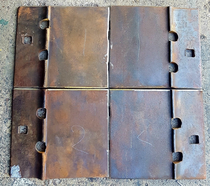

I'm just about to start building one from railway track plates. Going to weld 6 together in a 3 x 2 arangement to give me a 600 x 600 plate. They weigh 5kg each so it won't blow over in the wind here.
Going to make a frame to hold it at an angle to deflect the rounds downwards.
I'll post the results
The pic is 50gn and 70gn .223 from 100m

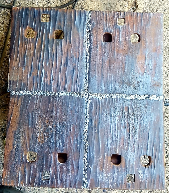

Post by Gaznazdiak » 26 Mar 2018, 9:01 pm
Started the steel target today, didn't get far, ran out of bloody welding rods and the ones I did have were damp but I got the deflector started, just have to fill the holes.
I'll start on the frame and target stand when I get new rods in town next week.

Post by Member-Deleted » 27 Mar 2018, 9:28 pm
Gaznazdiak , mate if the rods are wet and the flux is still on them just put them on a tray and put them in an oven on
medium heat for a couple of hours and they will dry out and return to usable rods
Just be careful whilst handling them while they are wet the flux may fall off

Post by Gaznazdiak » 28 Mar 2018, 9:11 am
Hi granddad
Yeah, I buggered a few by knocking off flux by being careless while it was soft. Never thought of sticking them in the oven. I left them in the sun for a few hours, I don't think it dried them enough though, as you can see from the dodgy finish.
That's my excuse anyway :mrgreen:

Post by Member-Deleted » 30 Mar 2018, 11:08 am
Well gaznazdiak don't worry about how it looks I've seen far worse from tradesmen and its held together fine
yeah mate they are pretty delicate when they are wet but still good when dry
cheers
