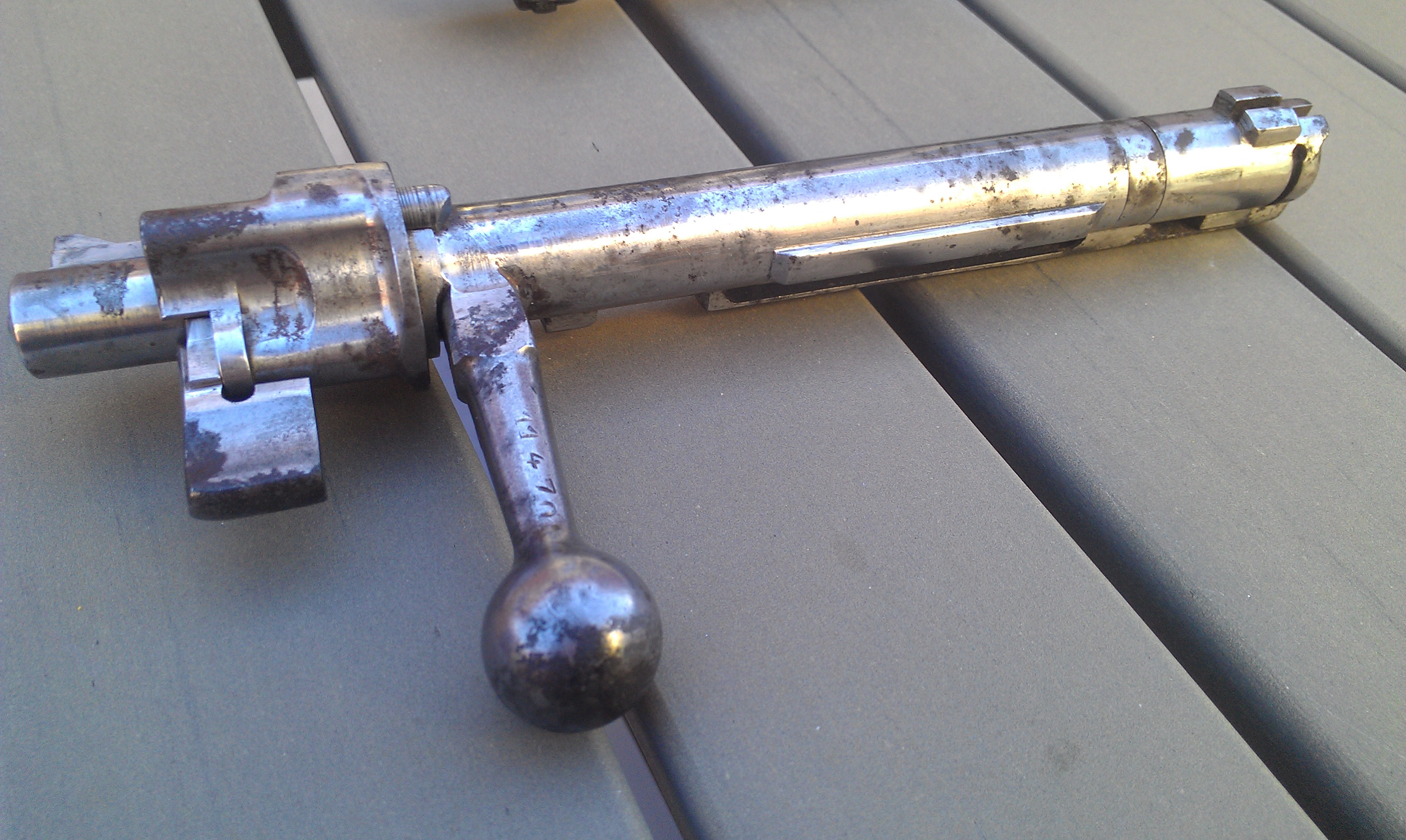

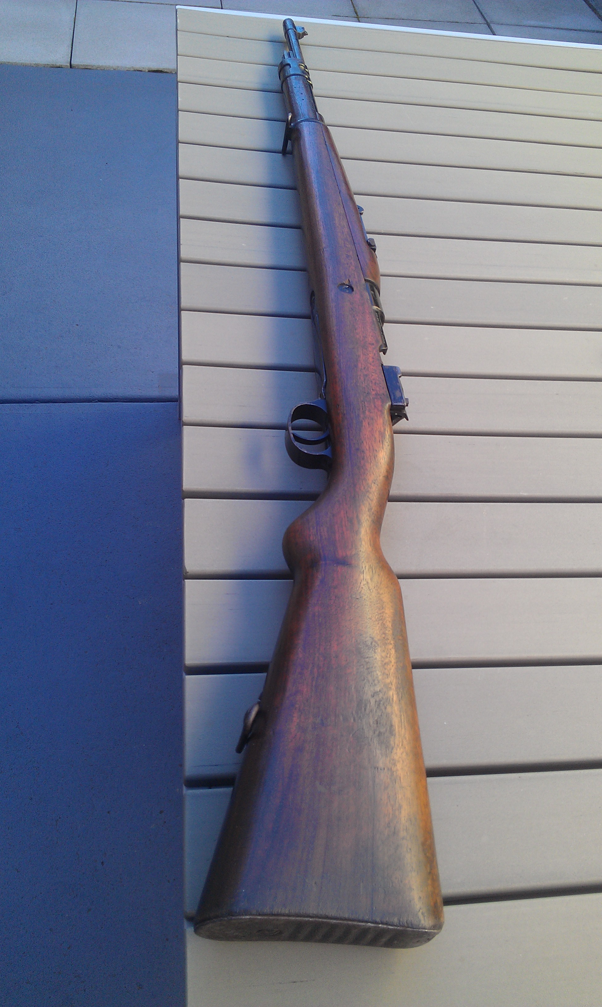

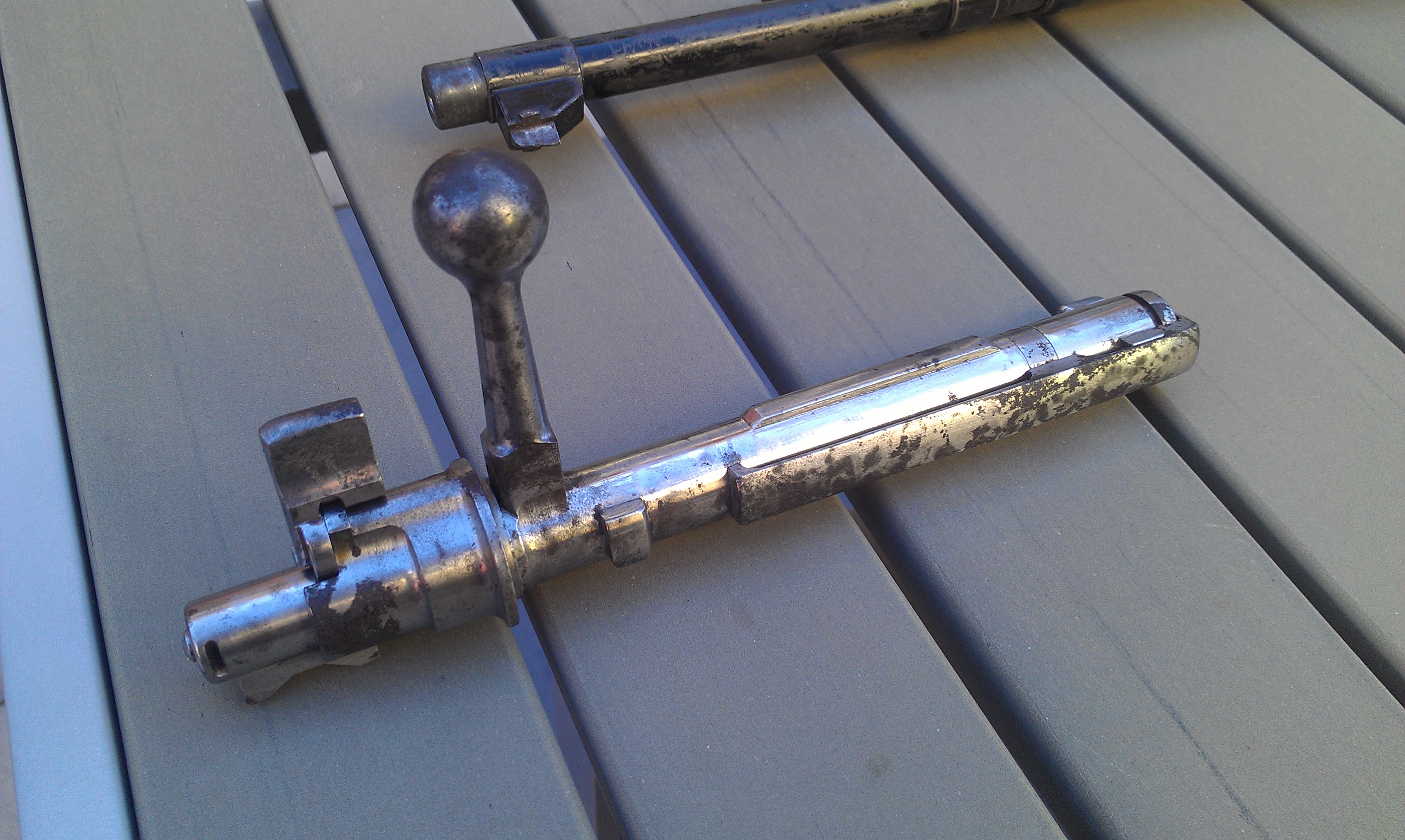

Now I've got a few questions for you guys regarding the rifle, and I'll attach pictures to give a better idea. I know these FN's aren't all that collectable in the Mauser world, but I'd like to turn it back into something half decent and keep it for a while.
- Do you guys think the bolt is too far gone?
- If not, what methods do you all recommend for removing the rust?
- Can anyone recommend a competent gunsmith who charges a fair price for a bore and head space check?
- What methods do you recommend to clean the barrel?
I've heard using oil and some very fine steel wool on the bolt will do the trick, but I don't just want to start going at it, especially around the locking lugs. And I've also heard stainless steel wrapped brushes work well to clean out old surplus bores.

Real classy choice for a first rifle. Depending how bad it is you may be able to get away with a regular old bronze brush just remember to get the right size. As for the bolt I've actually never had to do it (guess i've been lucky) so I never bothered learning.Some of the guys around here will for sure point you in the right direction though.

I suspect that Stainless Steel Wool would leave scratches. Try some out first, on a part that is hidden. The underside of the barrel for instance. To clean the bore, squirt lots of thin oil (eg Ballistol), or solvent, down the bore and wipe out with a loose patch at first. Get as much out as you can by oiling and wiping out, then start with a bronze brush. Buy a few. The solvent/oil acts as a lubricant. Keep patching out every few strokes to get the rough, abrasive stuff out. Do Not pull the patches or brushes back through the bore towards you. That will coat the bore with the stuff that you are trying to clean out of it. It will also distribute the stuff inside the action; the magazine, round the locking lugs.
That should clean the bore. Strip the bolt (look up youtube) and clean internally. Lube internally. Put moly grease on the locking lugs and cocking cam. Clean the locking lug abutments inside the action. By all means have the headspace checked. Before firing make sure both the chamber and bore is clean and dry. If it shoots OK, clean the outside and Good Luck.

0000 steel wool should be fine, check first and don't go crazy, autosol polish may help as well, for the bore just clean as normal but you may have to put the time into it to get it really clean. pretty much what wm has said :thumbsup:

Do I think the bolt is too far gone? Nope, for the most part it appears, to me, the rust is light surface and not really affecting the integrity of the bolt. The worse seems to me to be on the extractor, cocking piece, shroud, and the bolt handle itself. I noticed that the bolt's serial number matches that of the rifle so the odds of you having a proper headspace are pretty good, Do your best to protect/preserve those numbers when cleaning up the bolt. Matching numbers increase the value of any firearm.

Nice choice. I've got one myself. The bolt is made from really high quality tool steel. A little gun oil, some 0000 steel wool and a little elbow grease will clean that right up.

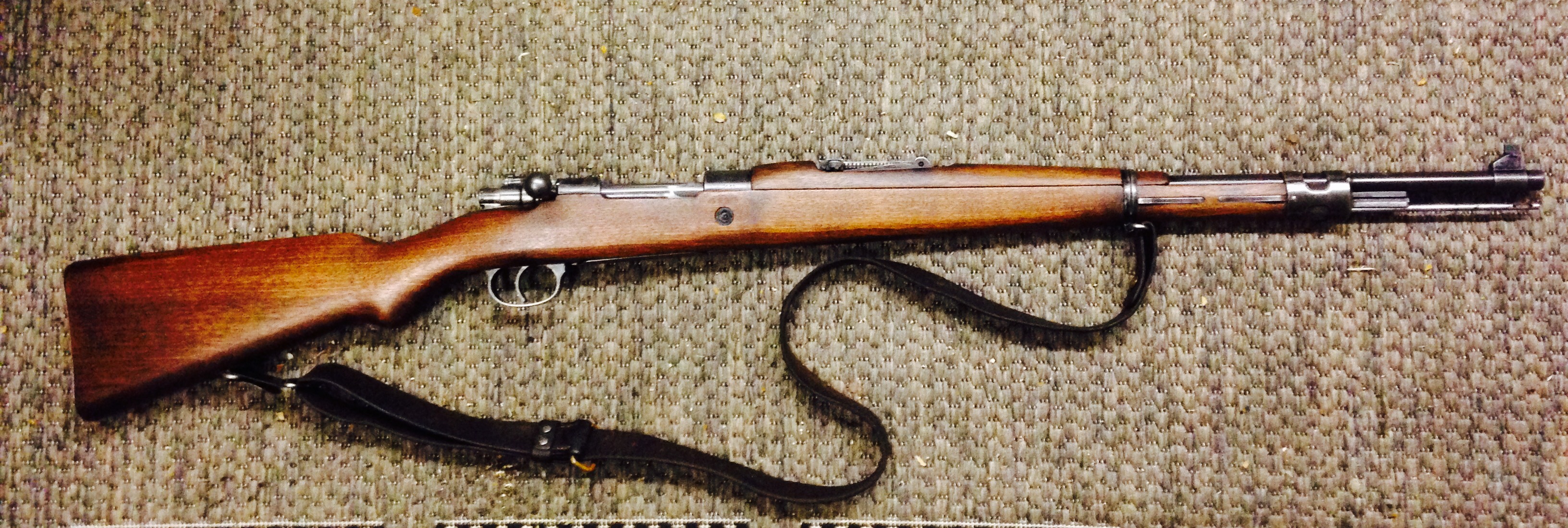

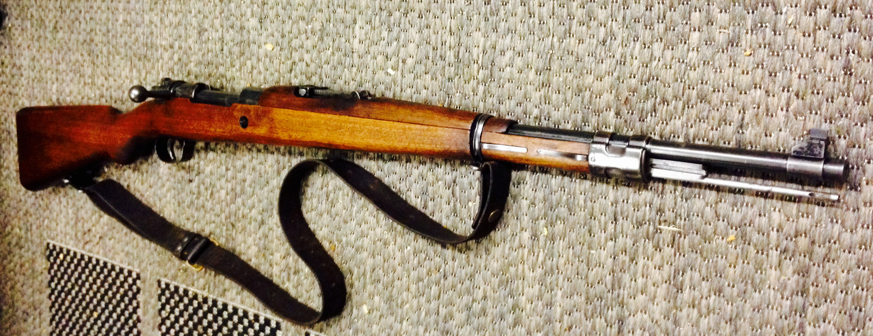

Here's mine
FN m1950
FN m1950
Enjoy it, they are great shooters and look really nice.
