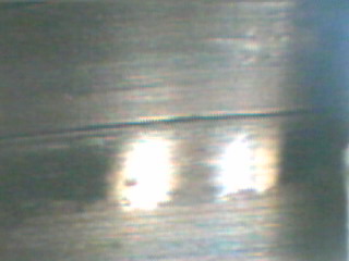

Like any topic, it's all BS without pictures so I downloaded the pictures from the bore scope as an indication of just how much crap can be left behind. Each barrel had been quite well cleaned using solvent and brushes and appeared fine to the naked eye. Bring on the bore scope....
Below pic is from a Colt Gold Cup 45ACP shooting 200gr Hornady XTP's. Gave the barrel a "good" cleaning with solvent, brushing, patching etc etc. It's "Clean" but still signs of fouling and copper.
After a good regular clean.

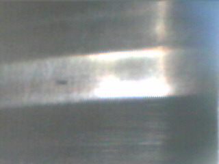

Same spot up close after cleaning with JB's Non Embedding Bore Cleaning Compound (just checked the name on the tub) - I love this s**t, guaranteed not to damage the bore and picture proves results.
After JB's

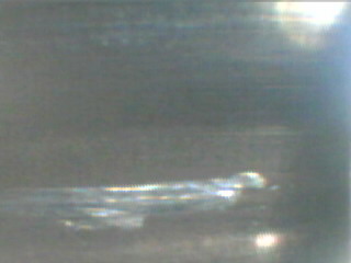

Approx 200 rounds of 122gr Coated LRN. Notice the thickness of the lead fouling, could have brushed it for hours and still not removed it all.
Walther Q5 Match after "Cleaning".

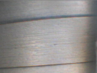

Oh so shiny :)
After JB's
