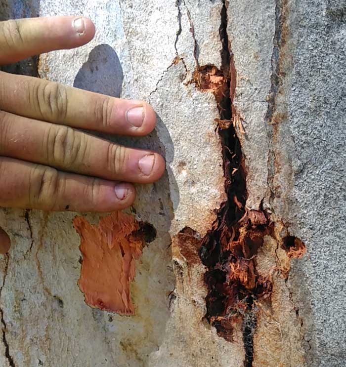

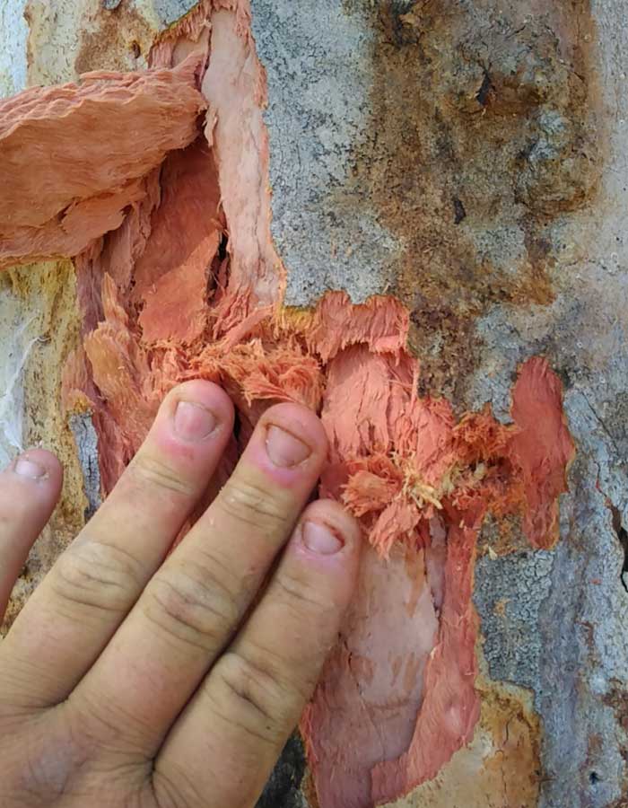

OK so I did a bit of playing with my .50 Hawken today. I cast a bunch of 360gn minies a while back that didn't shoot as well as my round balls so I put them aside,but I may be getting the chance to hunt camels and sambar one day,so I dug them out to experiment with.
First I tried 80gn of 3f with a ½" leather over powder wad under the minie. It printed around a 2" group at 50m but high and left.
Next was the same load without the wad. Ended up around 5" group but on point of aim.
Third was 97gn of 3f under the minie,just to see if the extra powder would get the skirt to engage the rifling better. Ended up around 10" roughly poa but it kinda looked like one minie tumbled in flight. Plus it kicked reasonably hard :-)
Gun is sighted in for .495 prb and shoots pretty consistent 2" groups with them. Interesting how the addition of a simple leather wad changed things so much !
