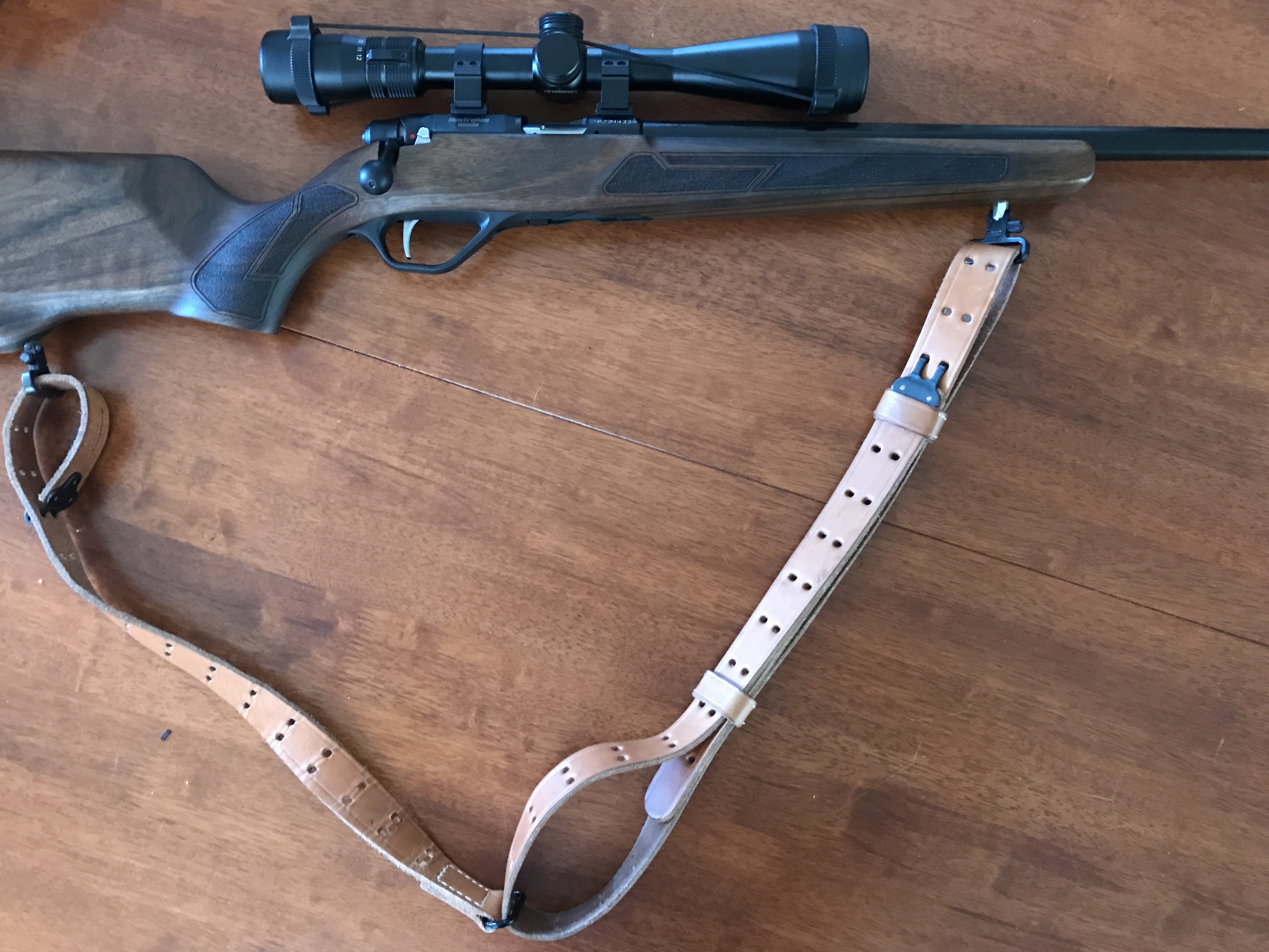

BACKGROUND INFO: I use an m1907 style loop sling on my walnut la101 22lr, therefore I'm forced to use extra wide (1 1/4") sling swivels attached to the studs. Using the sling constantly puts rotational changes on the front stud, and I can see the stud threading into the walnut starting to degrade. I want to put a halt to this.

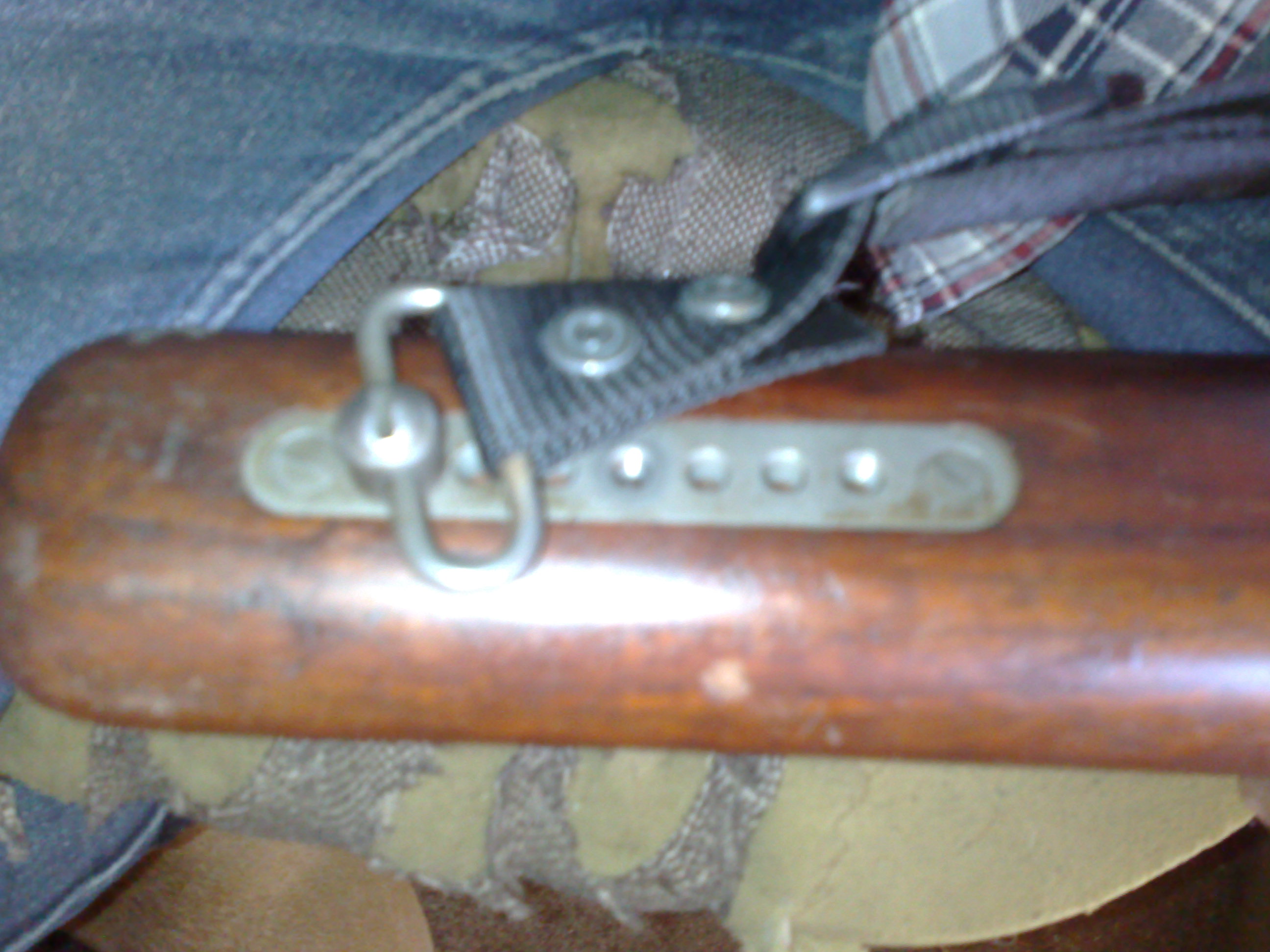

If you use the sling for shooting you might like the 513T as the swivel screws into a steel block inletted into the bottom of the stock. It gives you a range of positions to mount the sling.
I happen to be working on my 510/513 cross right now.

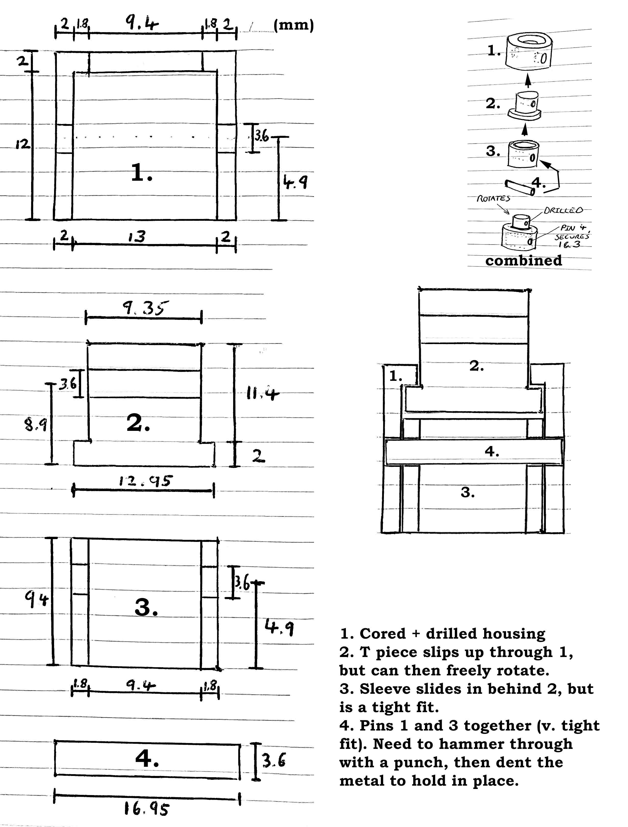

Post by in2anity » 07 Mar 2017, 11:54 am
Actually I'm working on trying to get something machined, here is the spec I came up with:
I'll keep you guys posted if it comes together.

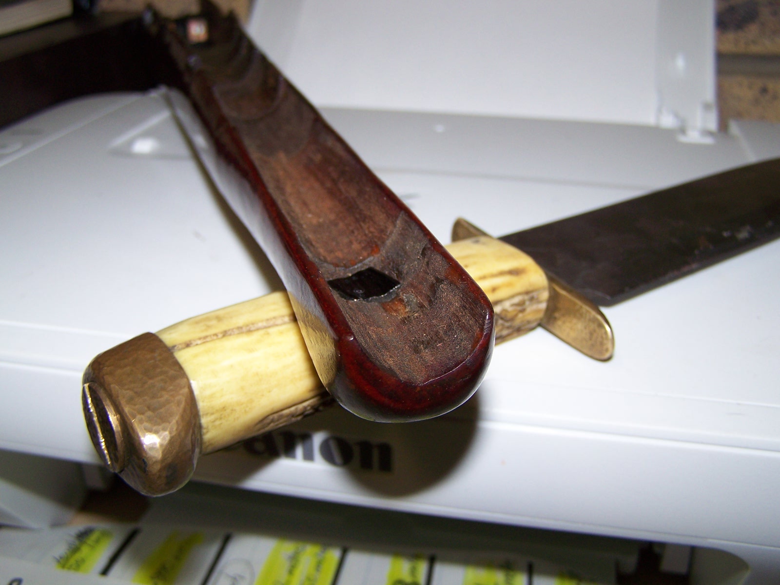

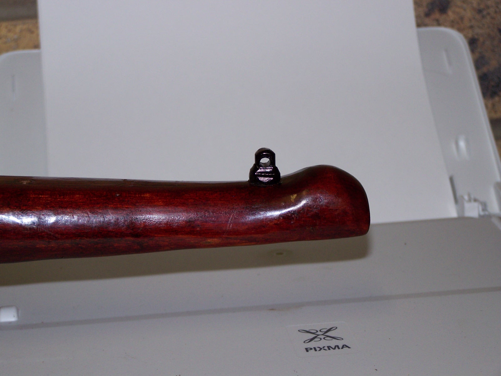

Post by Die Judicii » 10 Mar 2017, 3:35 pm
The one that I intended to take the pics of with the nyloc nut used, is not with me at the moment, it's at the g/smith.
So, instead I took a couple pics of the very 1st one that I did.
It's on my old .303 and the timber wasn't thick enough to allow a nyloc nut.
Instead I used an ordinary nut, and then ground it concave so not to interfere with the barrel, then applied locrite.
No where near as neat or pretty as the Howa with the nyloc nut,,,,, but the same general principle applies.
So you can see the method.
Posts: 4406

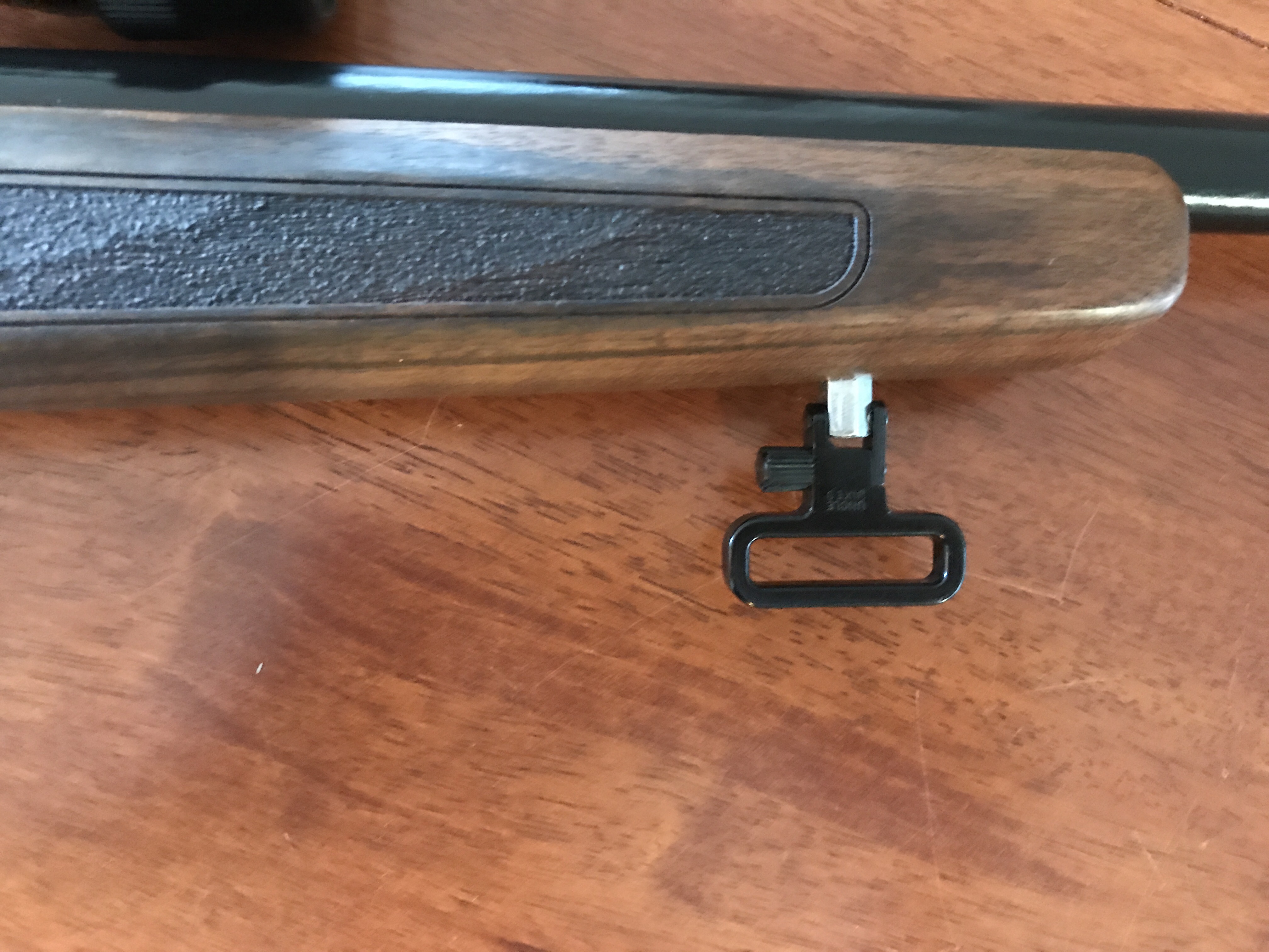

Thanks for the photos / tips Die J. much appreciated. So I had some great success myself:
After many failed attempts I ended up using a longer coupling nut cut down to around 15-20mm. I then drilled near the end of the nut for the swivel clip. This meant the integrity of the bolt of was not compromised (i.e. plenty of solid thread below the clip hole for the bolt). Loctited it on, Bob's your uncle and Fanny's your aunt! Very happy with with the result, thanks to all for contributions :drinks:
