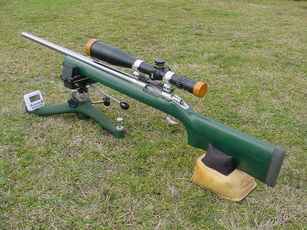

Okay, I'm pretty sure my 500m Fly / F-Class Rifle is longer than the one Chronos has pictured if that's what you refer to. I can measure but at present my rifles this long are stored in a Buffalo River Silver Series 14 Gun Safe. I have about 25-30mm under the wooden shelf in the top part, BUT, the shelf is removable which would give another 200mm plus room if for say I had a 31" barrel rather than the current 28.5". If you want some measurements and perhaps some photo's I can do that for you when time permits and not so late/early in the morning.
The really long Rifle's are the Full Bore Class and those chasing maximum velocity that shoot 1,000 Yards plus... typically 31" or maybe better, the longest I have seen was 31.5" but it looked like it was a mile long. ;)

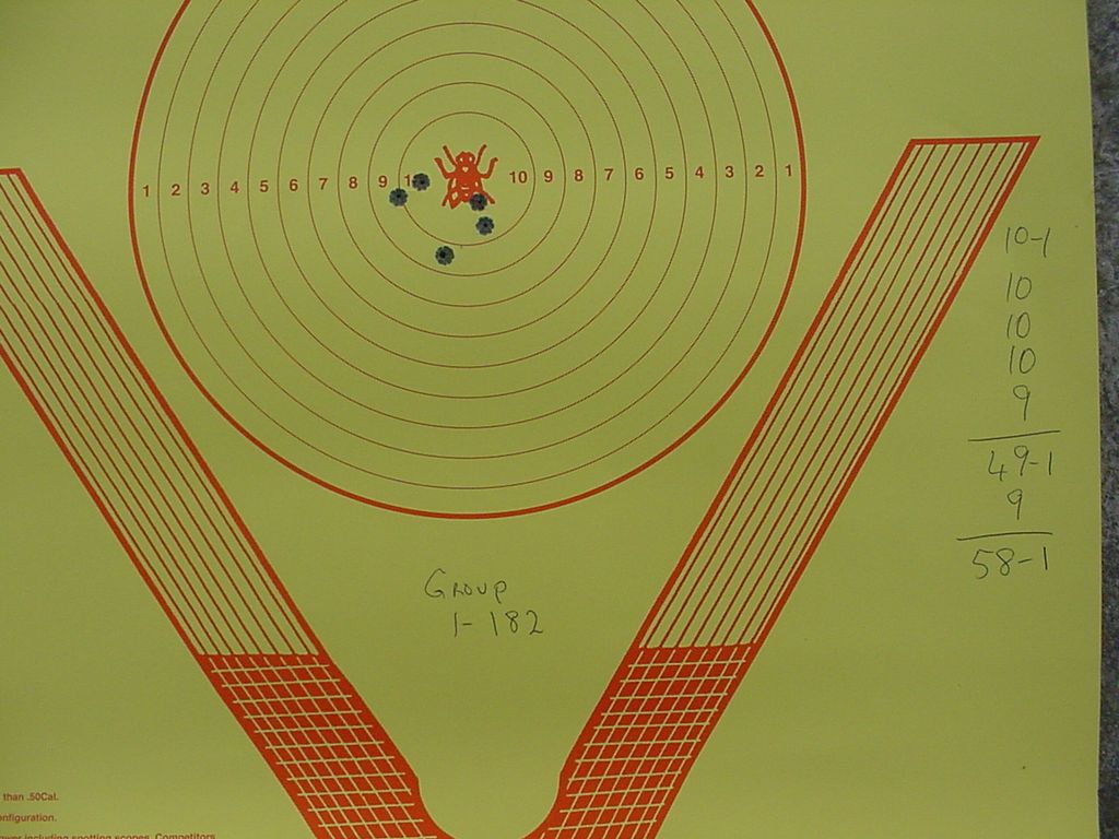

BTW..this is my 500m/F-Class 6.5x47 Lapua Stolle.
And the best I've done at 500 Metres in a National Competition was a 1.182" 5 shot group. I haven't beaten it for a few years.
tn_Picture 007.jpg (106.56 KiB) Viewed 8320 times
tn_Picture 037.jpg (229.22 KiB) Viewed 8320 times
