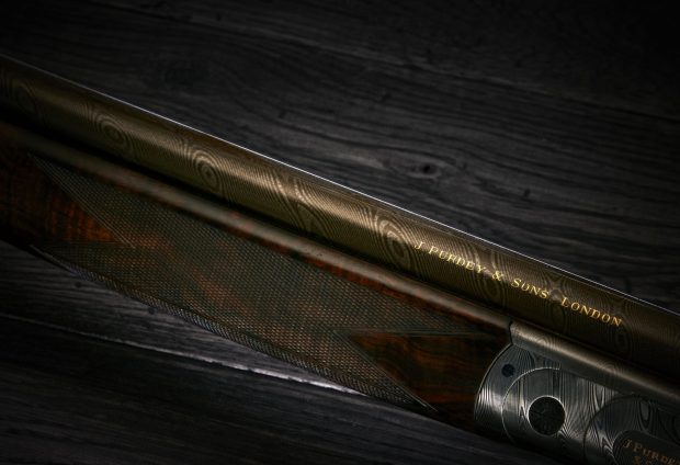

You blokes decrying the strength of Damascus barrels are way off track. I once owned a Mannlicher-Schoenauer rifle with set triggers in 9.3x64 Brenneke that had a Damascus barrel. Made around 1930, it was fabulous. While the majority of Damascus steel rifle and pistol barrels you will see are from muzzle loading arms, many top class European and English big game rifles were also made with them, Purdey will STILL make one for you ($$$$$$$$$$$$$$$$$$$$$), and from Czech Rebublic,
Posts: 2333
Re: Damascus steel rifles
Post by No1Mk3 » 21 Sep 2017, 12:38 pm
Initially said Holland & Holland in my post, mea culpa, had to edit it, it is Purdey. Still the same small nation GDP to buy it though,

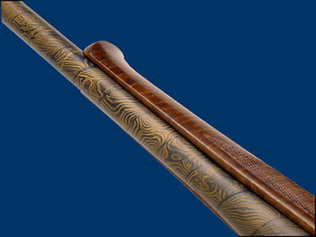

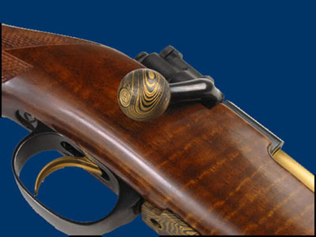

This isn't damascus steel, its' damascene - which is a completely different thing - but if you do like your guns with serious bling...
https://www.youtube.com/watch?v=4KM7ySNWuqU

Damascus always has a potential for weaknesses due to it being different steels welded together but done with full industrial processes and inspection and testing, I can't see why it wouldn't be useable in a rifle (as illustrated above). It would be horrendously expensive, though.

The Brno is almost certainly Damascene, but my Mannlicher was not. The Purdey on the other hand, uses a steel process called Damas, which is neither "original" Damascus twist forging over a mandrel, nor is it Damascene inlay. It is a process of sintered steel, hot rolled and then twist forged in a similar method to Damascus, but not shaped over mandrels, rather hammer forged like modern barrels but having a surface finish like fine Damascus. Price starts at $100 000, then heads North quite rapidly. Cheers.
