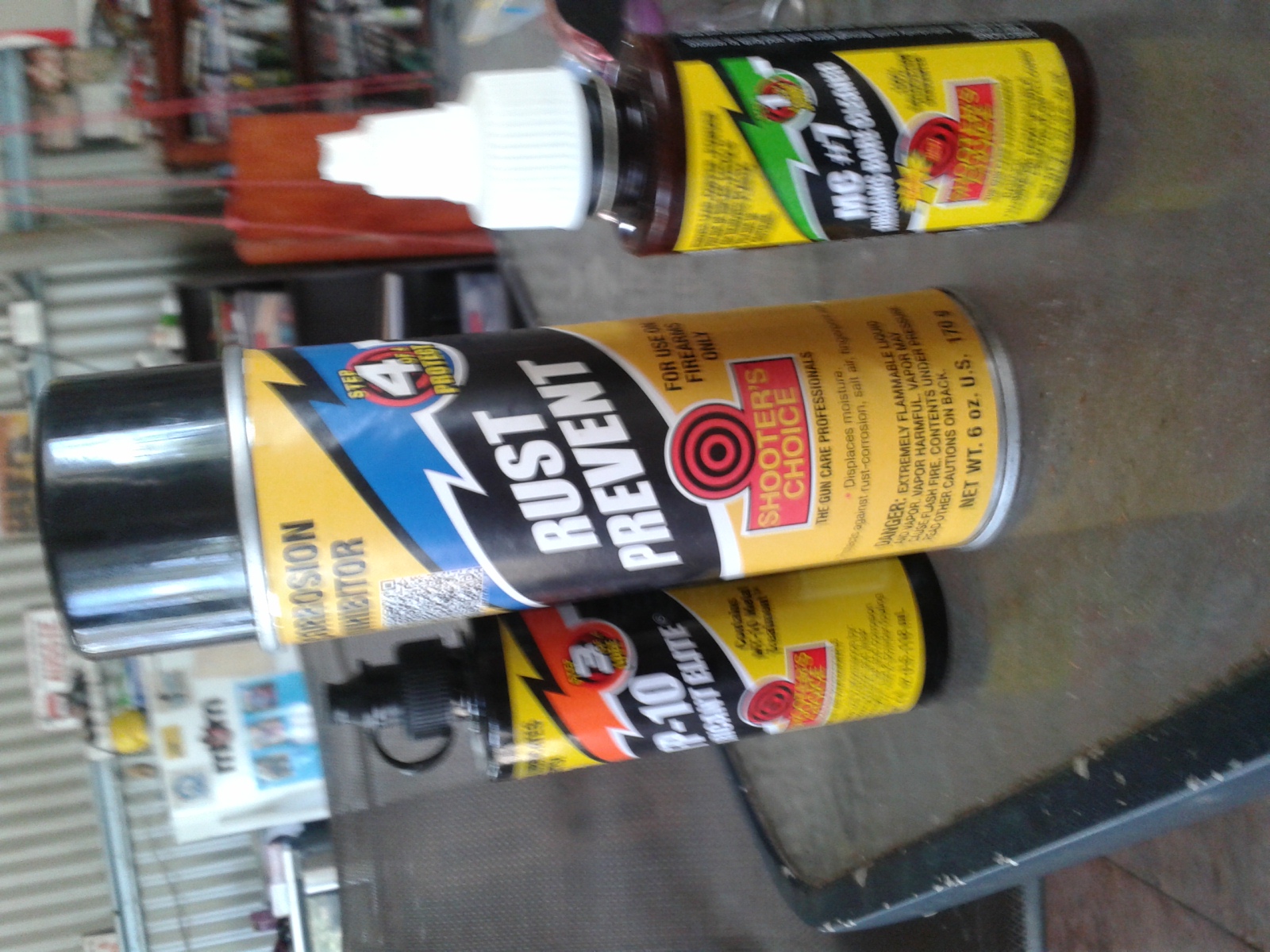

Post by Daddybang » 29 Sep 2017, 11:10 am
I use this stuff on my cf's and inox on my rfs. At 70 bucks for the three it's a little expensive but I get about 12 months use. :drinks:

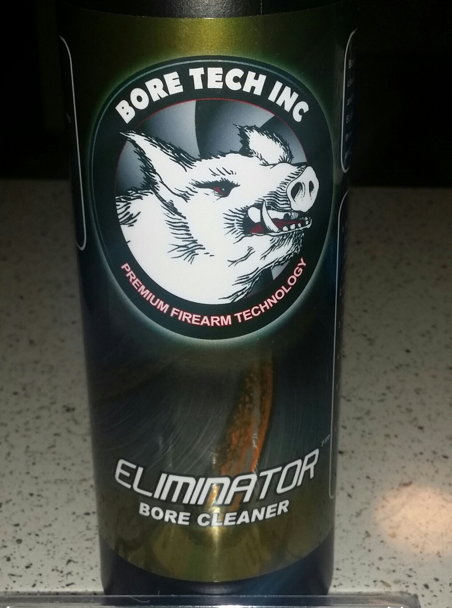

Post by albat » 03 Nov 2017, 7:13 pm
Ok fellas after listening to you blokes i thought i should start getting serious on the crud so was passing the q store in brisbane today and being one of the few places who have boretech in stock i grabbed a newly arrived 16oz bottle for $56 and a nylon brush afer a couple of bottles of the amber stuff im ready to attack the bore :lol:
16oz boretech
