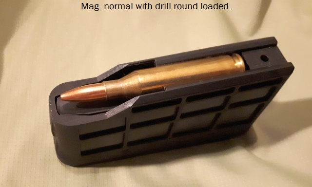

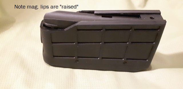

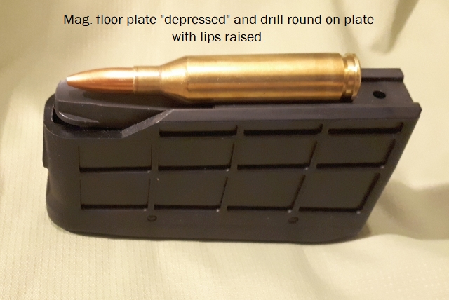

Post by RoginaJack » 13 Feb 2018, 9:19 pm
I've got a Tikka T3 in 243w. and have found in hard to load single rounds dropped in onto the mag sometimes. I think its to do with the bolt not picking up the round and aligning it up with the chamber correctly.. All i've done is used the 3 round mag. and depressed the floor plate so the lips come up as per photo 4. I think the photos will explain it better. Also, see the inside cover of your manual page 4 items 7, 8 & 9.

Re: New Tikka T3 bolt/feed issue...
Post by Stix » 14 Feb 2018, 5:03 am
Hi rj...
Maybe im a bit slow, but Im not exactly sure i follow what you mean in regard to your mag...
But i dont think its a mag feed issue mate...
Its only at the end of the forward motion of the bolt throw i get resistance...
Once the bolt has the round there is no problem--ie; can work the bolt with no resistance...
