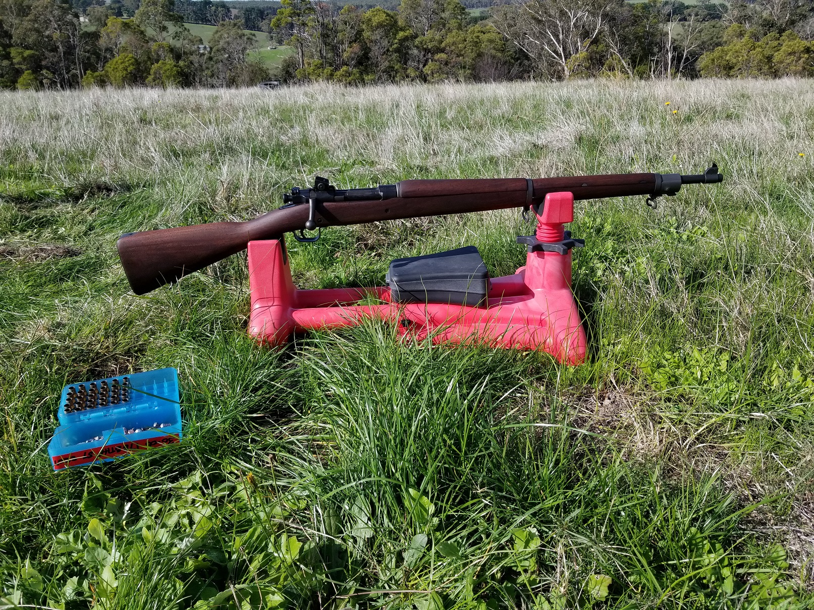

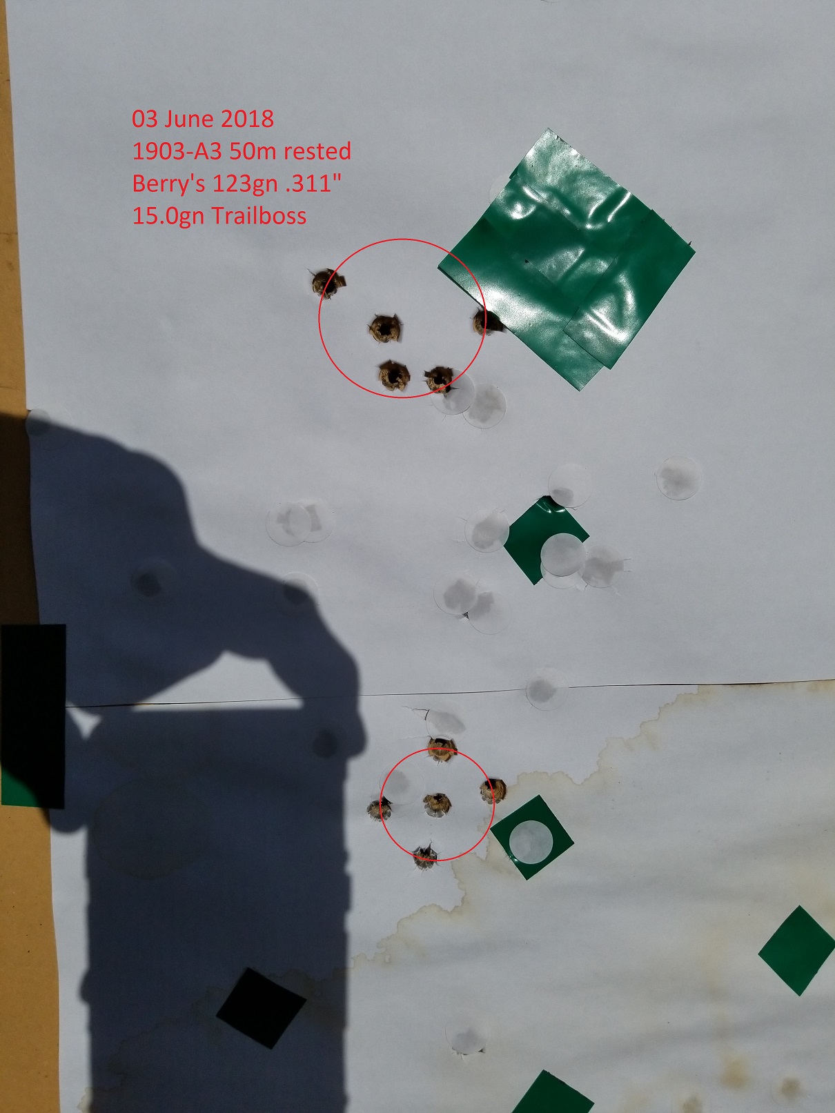

Just tried a lighter plinking load in the '03-A3.
Berry's 123gn .311" copper plated on 15gn of Trailboss.
At 50m 5rds into 33mm and 50mm groups.
The 50mm group was at a 19mm diamond of tape that I could barely see anyway, but was completely obscured by the front sight. The 33mm group was at a 50mm target, much easier to see.
I'll make up fifty rounds for more testing. I bought these to try in the .303/7.62x54R but they're too small for both, work well in the .30-06 though.
I also tried cast Lee .309" 150gn bullets with terrible results, most of them keyholed over an area about 600mm square at 50m.

You must have good eyes to see that tiny green thing at 57 yards :mrgreen: :thumbsup:

Not at all, it's mostly a matter of having a rough idea of where the mark is on the paper and just pointing in that general area :-)
I do like the smaller aperture though, I think that helps a lot.
