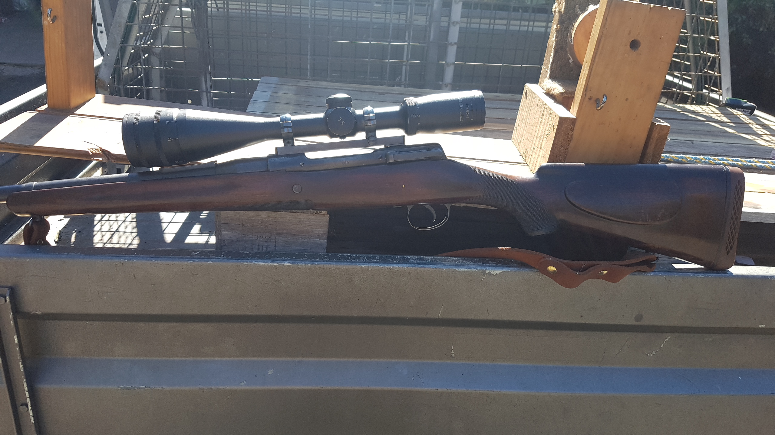

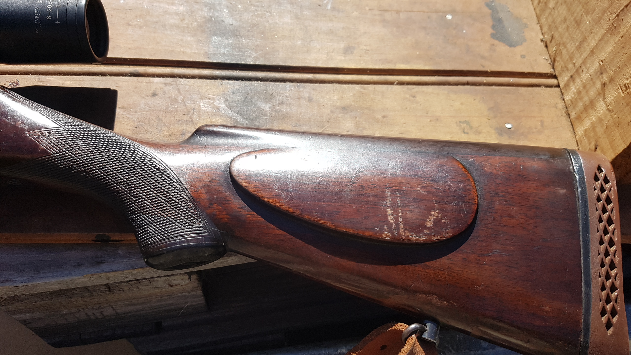

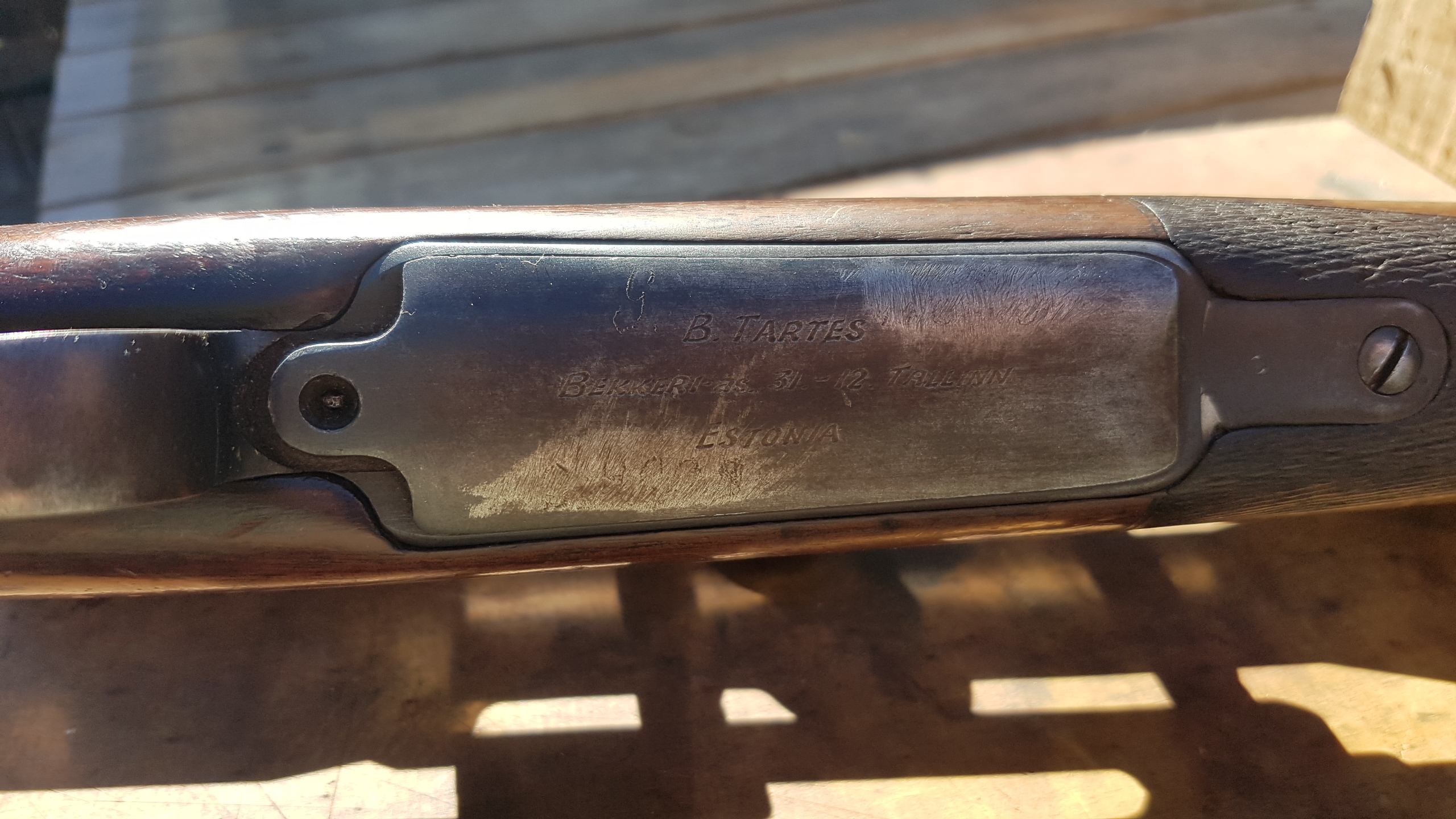

Hi there guys and gals , I'm wondering if any one can help me with a bit of info on my p14 chambered in .270win .. I've ran the serial number thru eddystone and it says it a 1917 model I think( was a while ago I did it ) but its not original any more it has had stock work and been sporterized ... has some weird markings now like huntmaster model 2 and a guys name from Estonia and a little port side town there .... you can see the stock has been chequered and a pistol grip cut in as well as a new comb and cheek piece... I'm just lost as to what or why it is I quess... shoots like crap (possibly the crap scope ) but seems solid and only set me back 600 bucks lol

First off, according to your post it is not a P '14 at all but a US M1917 originally chambered in 30-06, which explains the current 270 chambering as the cases are the same bar calibre so no bolt head work needed to be done during conversion. Why it is? In many countries after the war, military calibers were banned for civilian use and hunting rifles were scarce, so a large industry began converting ex-military rifle to sporting configuration such as Parker Hale's 303 Enfield sporters. Yours looks to have been a fairly high grade conversion and would be a good restoration project to clean up the stock and re-cut the chequering, as for it not shooting well, I would re-cut the crown and see if it helps, Cheers.

If you do a search on Wikipedia for 'Pattern 1914 Enfield', you will find a photo of 'Conscripts of the Estonian Sakala Partisan Battalion with P14 rifles in 1939 or 1940'.
As No1Mk3 said, your rifle is not really a P14, but the US modified copy; the M1917.
Are you happy with what you paid for it? It seems high for an ex-mil rifle thats heavily modified from original, and not grouping well.

Like the other blokes said, its probably an aftermarket conversion, I'd hazard a guess that the name on the floorplate was a previous owner..... its wasted as a 270, convert it to 375 whelen or put a P14 bolt in it and convert it to anything up to 505 Gibbs

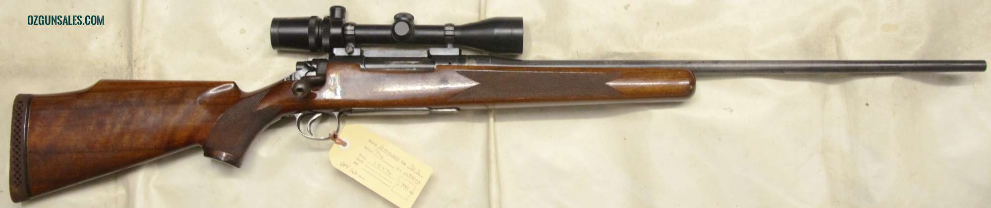

This is a mates P14 in 405 Winchester
