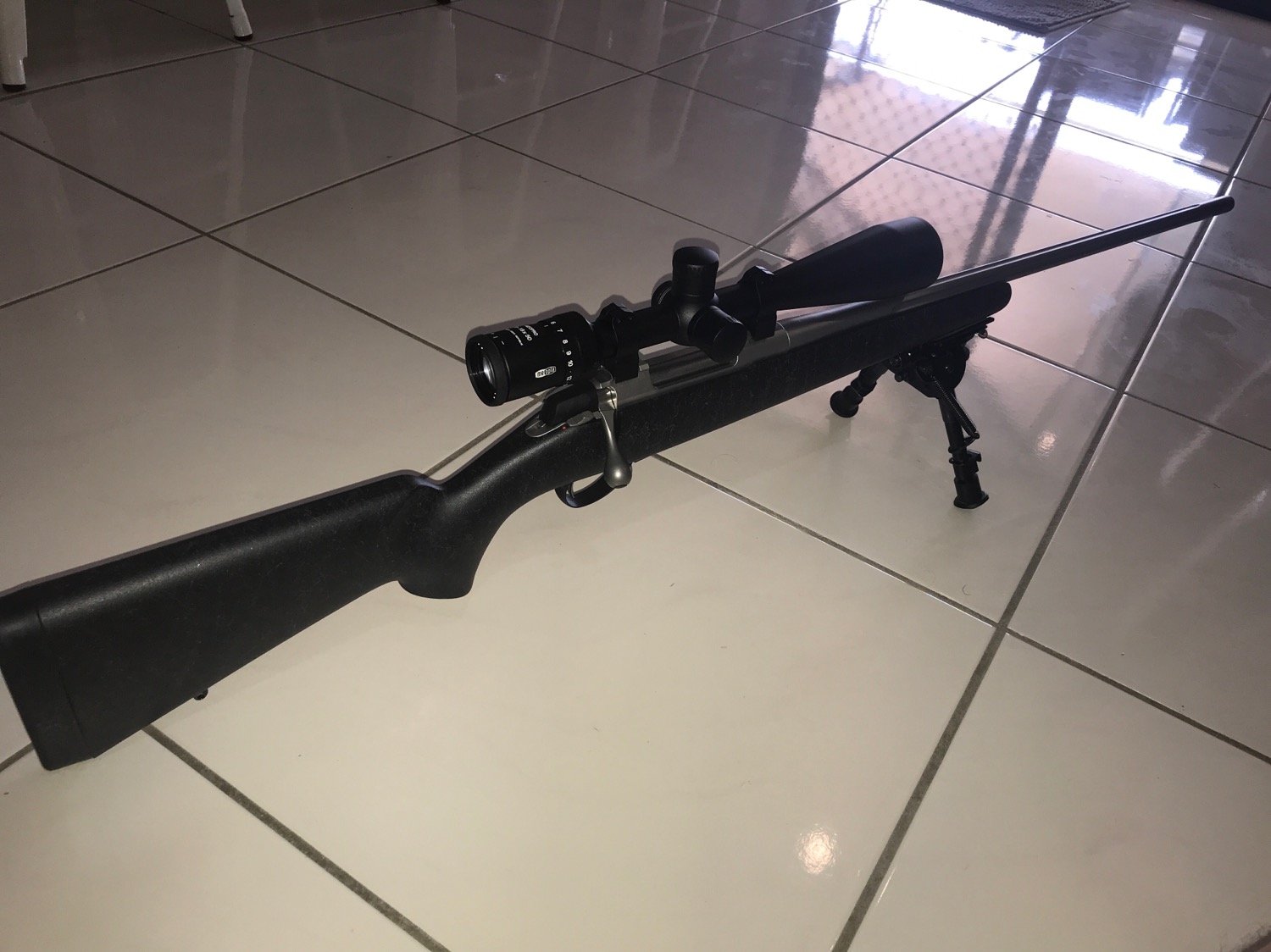

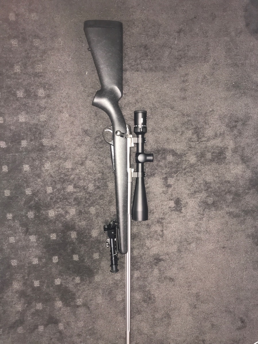

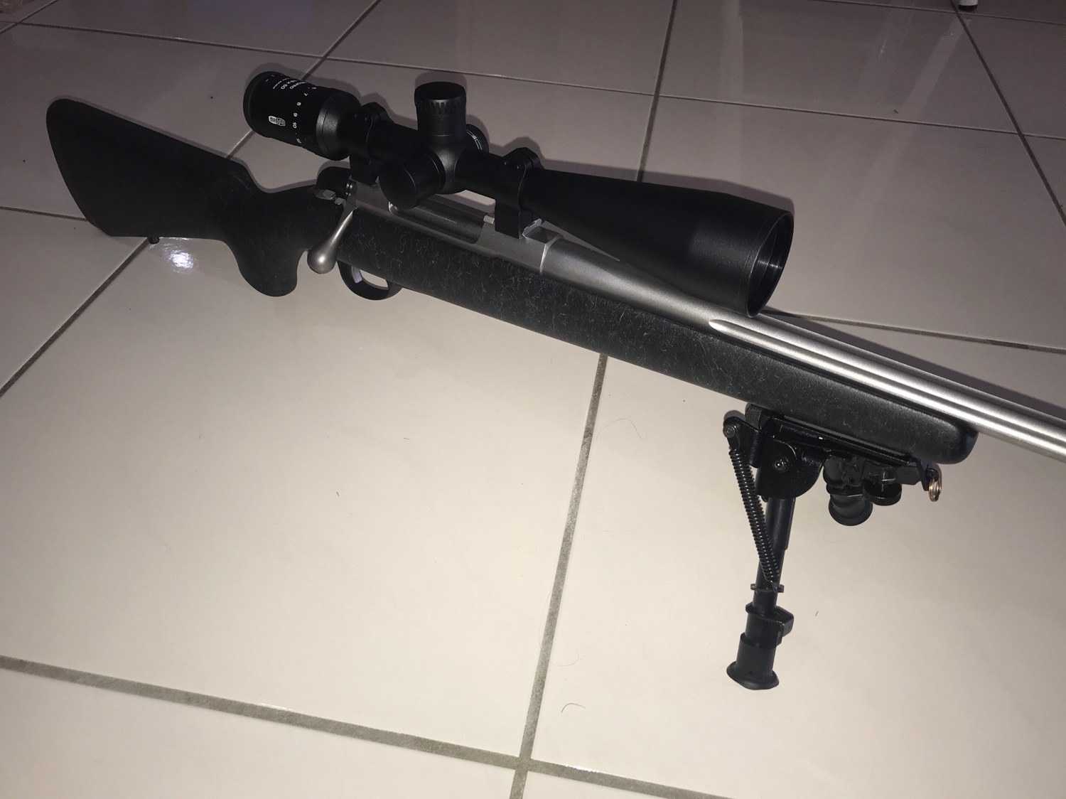

I’m not much of a photographer but here are a few.

I ended up ditching the Leupold PRW2 rings. Seems something wasn’t quite right with the alignment of the screws. I asked the local and he said there were some defective rings and they would be replaced. Unfortunately I got mine online from Brisvegas and have lost receipt etc. To much admin to worry about them. Got a set of the vertical split Warne mounts. I have them on my 308 already and although they take a bit to get used to aesthetically they work well.

very nice setup :drinks:
Re: New Sako in the safe
Post by JimTom » 28 Sep 2018, 5:14 pm
Thanks mate. I can say with some certainty that it’s the nicest setup I have owned to date.

Nice bit of kit JT! :thumbsup:
That second photo down make's it look like it's made completely from metal.. Its a good look!!

Post by Flyer » 01 Oct 2018, 4:26 pm
JimTom wrote:I’m not much of a photographer but here are a few.
Haha - looks familiar! Is that a Meopta Meopro scope? I've got a Swarovski Z5 5-25x52 on mine with Burris Signature Zee rings, part# 420521. If you're looking for something close to Optilocks, with plastic inserts, low profile and half the price, these fit a 50-52mm objective scope really nicely on the supplied A7 mounts.
And yeah, the mag is designed top top mount - I never remove the mag on mine.

Post by JimTom » 01 Oct 2018, 5:51 pm
G’day Mate
Yep I went for the Meopta Meopro 6-18x50 on top of the A7.
Took her out today and she shot 5 shot sub MoA all day straight out of the box. Thinking the trigger could use a little adjustment, nevertheless it’s a good rig straight up.
I tried the 143 ELD X today and had the best results with 41.5gn AR2209.
Will head back out towards weeks end and confirm those loads. Will seat projectiles a little linger this time to refine the accuracy. Absolute cracker. Love that A7 to bits.
Mate can’t thank you enough for the recommendation.
