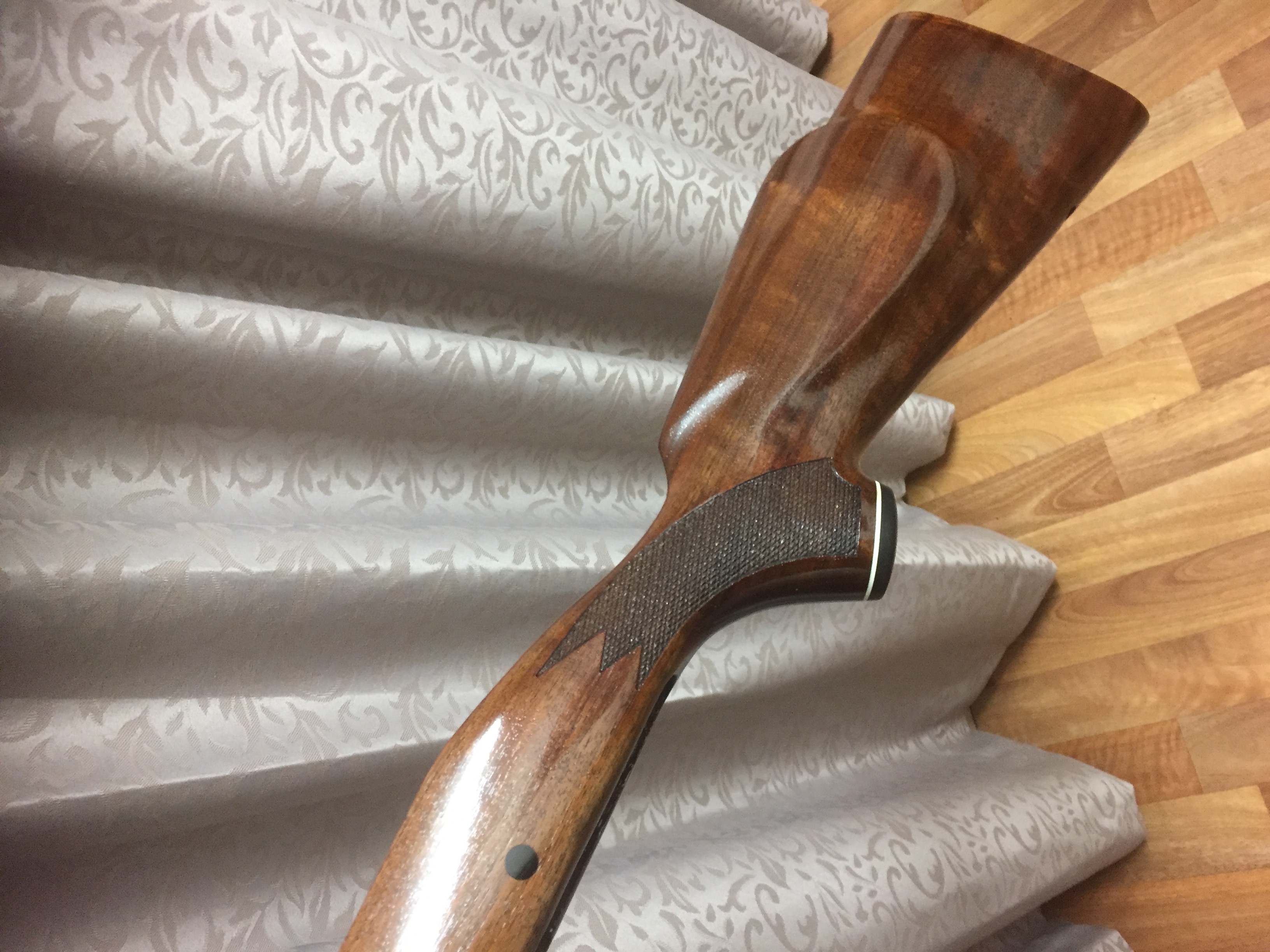

yup when i first got it, it was shooting one hole with 40 vmax. i stuffed it by cleaning. pulled the copper out and ended up with pitting in front of the chamber and a loose spot 6 inches from the end of the barrel. i could still get consistant 1 inch groups at 100 with 50 gn, but i know a 222 can do better. i think i remember you relating a tale about cleaning a old 22-250 that shot great and then went to crap after cleaning. ya win some , ya lose some.i've given the stock a birthday with some tru-oil. it came up not too bad :drinks: :thumbsup:
a bit of sanding and 7 coats of tru oil
