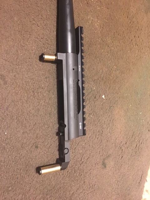

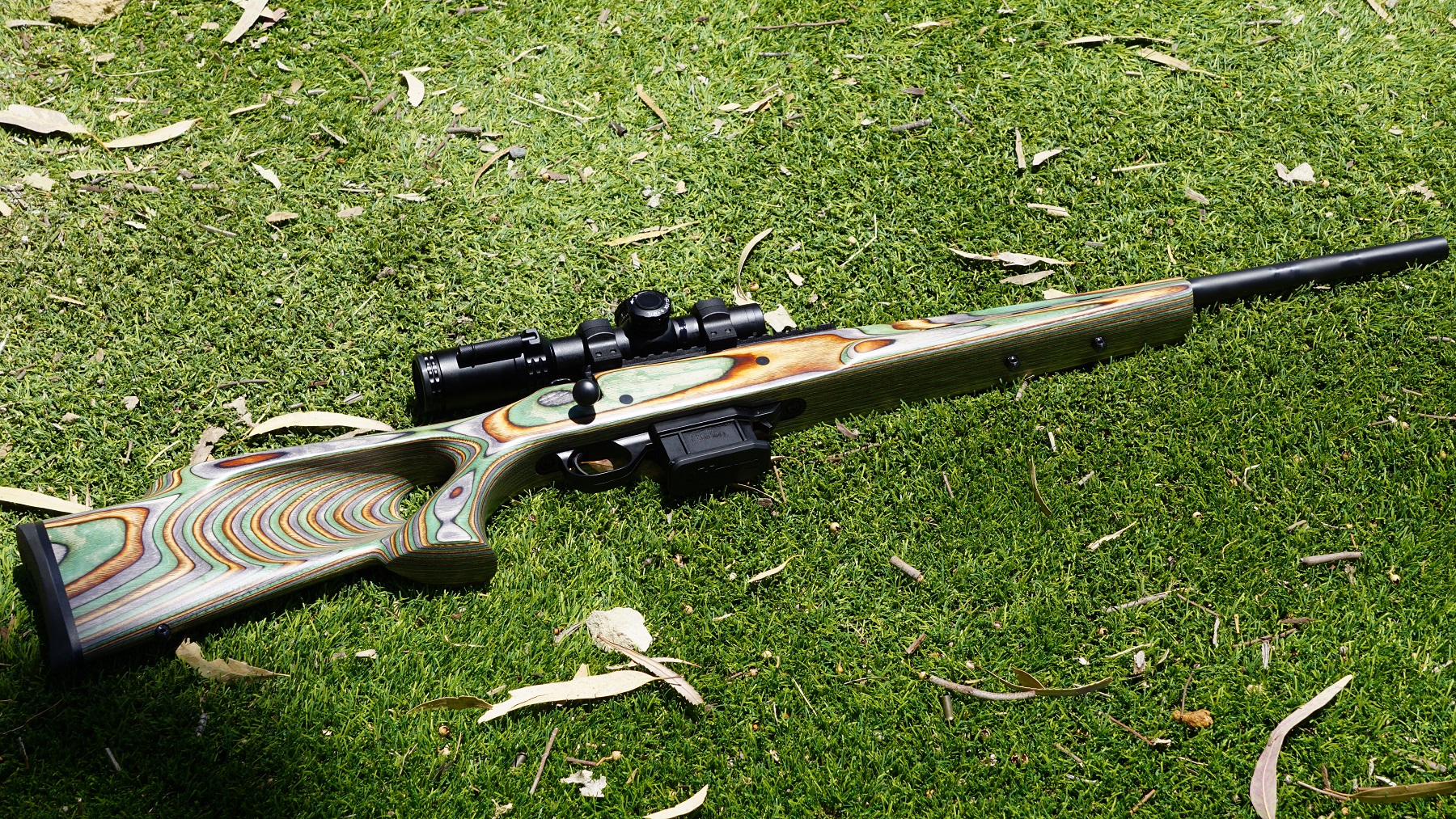

So picked up my New Howa last week took it for a little range time
Very fun little rifle to shoot ,, low recoil super short action
They action is so sort that you cannot short stroke it even a little bit or you wont pick up a round

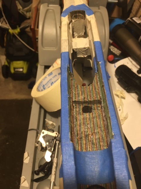

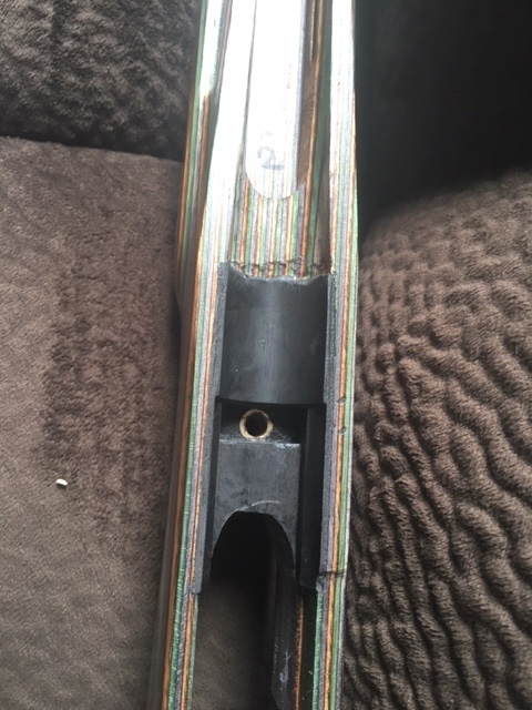

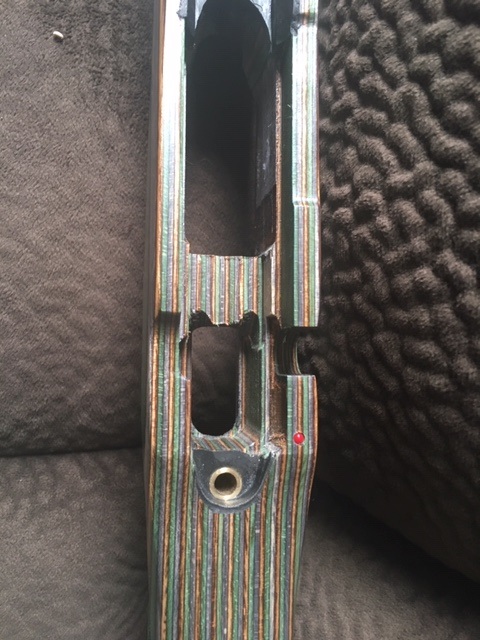

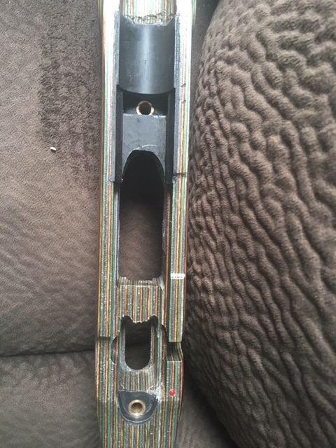

Is in A boyds thumbhole stock
with a 1-4 FFP 300BLK bushnell optic
the boyds was sitting hard left so i decided just to pillar bed it so made some pillars out of brass on the lathe and mixed up some 10110 devcon for the bedding
howa pillars.jpg (122.69 KiB) Viewed 10538 times
Come up quite nice
will take it to the range and do some testing and let you know how it gos

Re: New Howa Mini Action in 7.2x39
Post by pomemax » 15 Dec 2018, 7:49 pm
i bought the same last month hard to get used to the stroke
pomemax
Posts: 1153
Post by Cooper » 15 Dec 2018, 7:54 pm
I’ve put two mini actions in Boyd’s stock now. The 223 wouldn’t even pick up a round and the 6.5 Grendel which I’ve put in Boyd’s At-one won’t pick the last round from the magazine unless I push the magazine up with my hand.
I’ve fixed the 223 now.
I didn’t experience the same problems in the factory Houge stocks.
Cooper
Posts: 542
Post by AZZA'S HJ47 » 15 Dec 2018, 7:58 pm
Did the same thing to my 308 in a houge stock i was gob smacked with how much better it made the rifle
Post by eddahenry » 15 Dec 2018, 8:45 pm
Cooper wrote:I’ve put two mini actions in Boyd’s stock now. The 223 wouldn’t even pick up a round and the 6.5 Grendel which I’ve put in Boyd’s At-one won’t pick the last round from the magazine unless I push the magazine up with my hand.
yeh the bottom inletting can suck
im lucky i have a mill and a lathe so can sort them out pretty easy

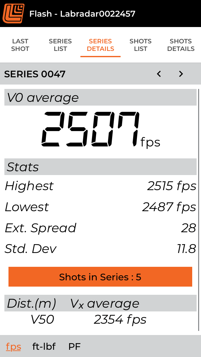

all group sizes where similar through the powder range for both SSt and Zmax , best group was both the Zmax 27 Grs and the SSt 27 grains (pictured above) most groups where around the inch ,, biggest being 1.5 inchs
all loads where 40tho off the lands
i did this test buy loading 5 shot groups of
ZMAX 123 Gr 25Gr 2207 AVG FPS 2331
SSt 123 Gr 25gr 2207 AVG FPS 2324
ZMAX 123 Gr 25.5Gr 2207 AVG FPS 2372
SSt 123 Gr 25.5gr 2207 AVG FPS 2379
ZMAX 123 Gr 26Gr 2207 AVG FPS 2399
SSt 123 Gr 26gr 2207 AVG FPS 2423
ZMAX 123 Gr 26.5Gr 2207 AVG FPS 2478
SSt 123 Gr 26.5gr 2207 AVG FPS 2482
ZMAX 123 Gr 27Gr 2207 AVG FPS 2507
SSt 123 Gr 27gr 2207 AVG FPS 2503

Very interesting to see your data. I know nothing of this case but it is similar to the 30 BR. With that case you can stuff 34 grains into it and get velocities around 3,000 fps with a 125 grain projectile. Are you able to get much more powder into your cases?
I see what you are saying about the .310 bullet from Hornady. The ZMax is half the price of the SST so I wonder where they save the money. In a .224 the 50 grain ZMax has a cannulur but the Vmax does not, not sure what Hornady was achieving putting it there.
Post by eddahenry » 24 Dec 2018, 8:36 am
SCJ429 wrote:Very interesting to see your data. I know nothing of this case but it is similar to the 30 BR. With that case you can stuff 34 grains into it and get velocities around 3,000 fps with a 125 grain projectile. Are you able to get much more powder into your cases?
Not with 2207 ,, i am not showing Pressure but there isnt the case cap left to get to 34 , i dont think 2207 is the powder to push it with.
Buy all the data flowing around CFEBLK is the powder to try , its a ball powder so will stack nice , and makes the best on paper velocities the big problem is there isnt any in WA
but just resizing some cases than ill trim than get a average Water capacity for the cases (starline) than i can get some data flowing in Quickload
