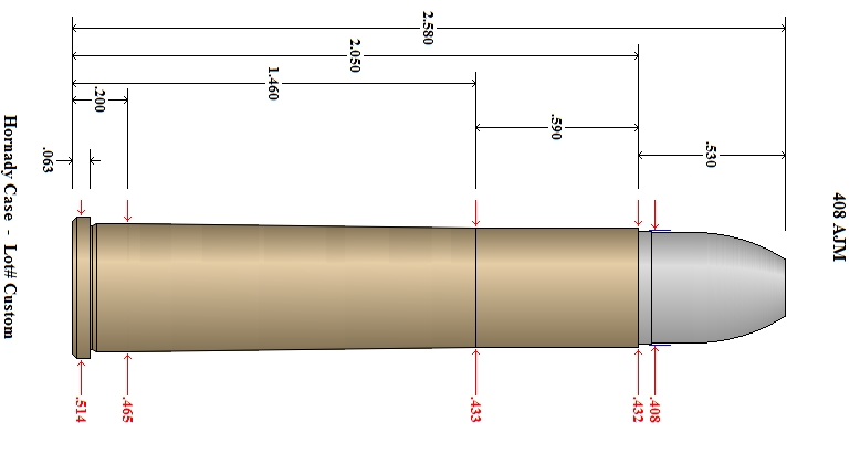

Hi guys, I am considering doing a .408-444 wildcat.
I am thinking that the case would be based on a 444 marlin necked down to 408, but tapered, like a smaller 40-65 and 2.04" long. The rifle would be a Win94 big bore.
What do you think?
The barrel twist available 1:13 length I am thinking 26", what size bullet would you guys recommend?
Yes I could just get a 40-65, but I want something similar in a Win 94 platform.
I was thinking the RCBS 40-300 or 40-350! ?
This is roughly what it would look like.

I'm sorry, it must be limitations in my mental capacity, but I just can't grasp the rationale behind this proposed wildcat.
What is it that makes it more desirable, for your purposes, than just a straight 444.
You are of course aware that model 94's were at one time offered in 444 and thus some of the problems you may encounter in your proposed conversion will have been dealt with but with your proposed tapered case you won't be able to approach 444 pressures in a relatively weak action like a 94.

Just to say, I have the barrel and the reamer and dies, and will be getting this project done next.
It turns out that someone had done this before me (not a surprise) it also turns out that this cartridge was done long long before the 444 in fact in the 19th century its called the 40-63 Ballard, luckily I found this out before I got a custom reamer or dies made and the off the shelf reamer and dies ran to $300 USD. The only reason had it done early is because I had a 7 month wait for a slow twist 408 barrel and other projects have be higher priority over the last year, that's how long all the bits have sat in my shed.

Post by andym79 » 26 Feb 2019, 12:02 pm
The 411 JDJ is pretty much what I will have, with a bit less capacity, because it tapers to the neck rather than bottle necking!
The Ballard is 2.250 not to 2.05 as my original drawing.
