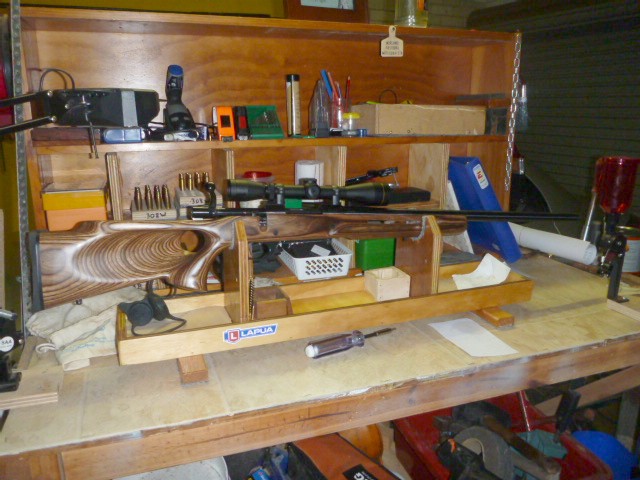

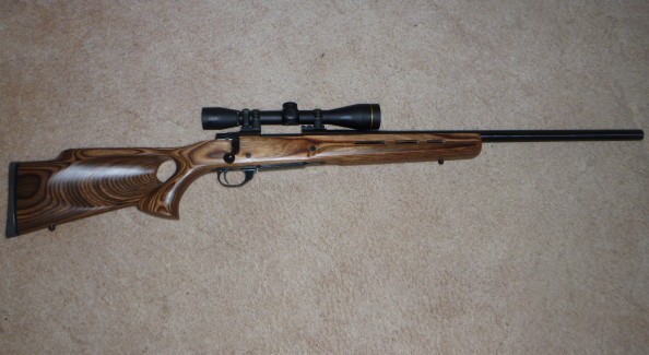

I've been having a grizzle about how long it took Aussie Post to get my new Boyd's stock to me, well it arrived today, almost perfect drop in fit. Look 100% over the old boat paddle.

looks very nice, i am looking to get one in the near future, what did you have to do to it? just a light sand? how much was postage if you don't mind me asking?

Mine didn't shoot as good as the plastic one, until I bedded it. They look real rice and give you much better trigger control.

It was just a light bit of sanding mate, one side of the barrel channel was a bit closer than the other side so I relieved a bit of wood and while it's still a little close you can run a $5 note right up the channel to the receiver.
As far as I can see the only thing that may need attention is the recoil lug.

That looks really nice, love it.

Looking good!

Yeah mate. Looks good.
