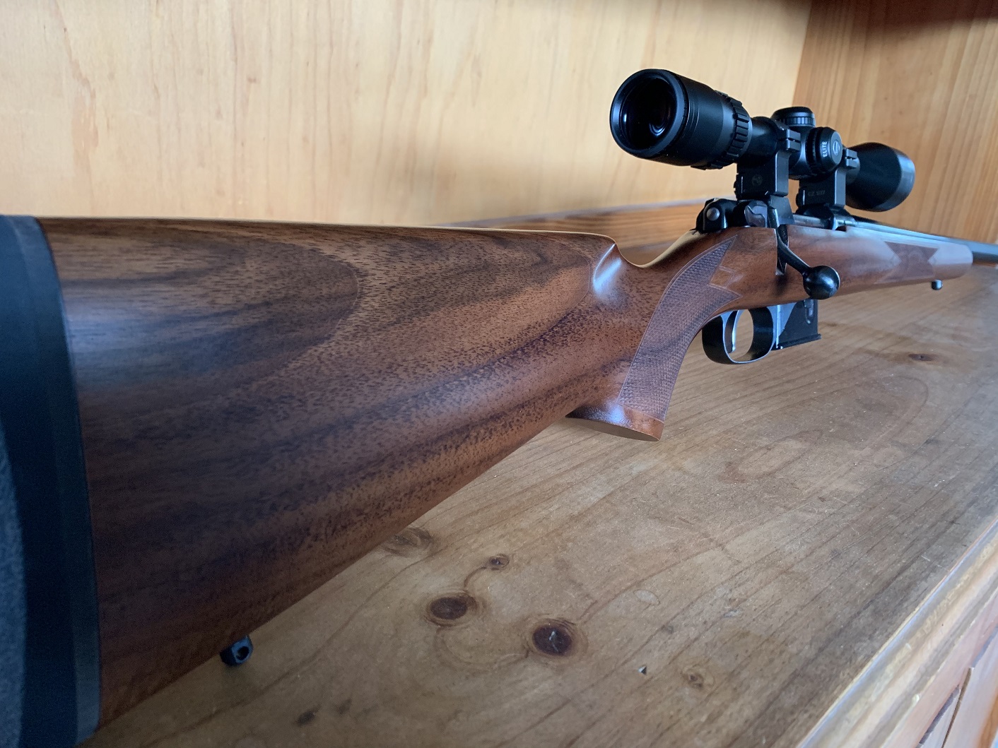

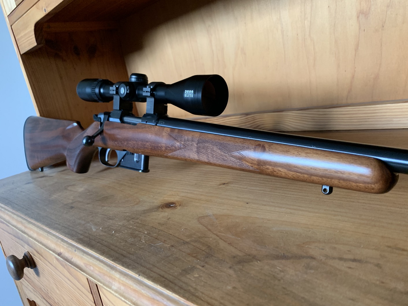

Post by Kumaabear » 29 Mar 2019, 8:31 am
Picked up this beautiful CZ 527 Varmint in .223
-24 inch cold hammer forged varmint barrel, threaded with a recessed crown
-Micro-Mauser controlled feed action, beautiful milled receiver with large integral recoil lug its like someone grabbed a Mauser 98 from the 30's shoved it into Photoshop and pressed *shrink by 70%* then added a removable mag.
-3.3 kg pretty incredibly light for a walnut stocked rifle with a heavy 24 inch barrel, a large amount of weight is saved by having the extra small .223 sized action
-Fully free floating, checked with a $5 note all the way to the action.
-Fully metal construction, not one bit of plastic on the whole rifle including the magazine.
-Lovely single stage trigger from the factory, fully adjustable for creep, over travel and weight, I adjusted it for a 3 pound pull with no perceivable creep or over-travel. + Set trigger, press it forward first till it clicks and it turns into a <1 pound target hair trigger
Will hopefully take it out to sight it in next week. The rings look high but for me it shoulders perfectly, scope comes up naturally in line.

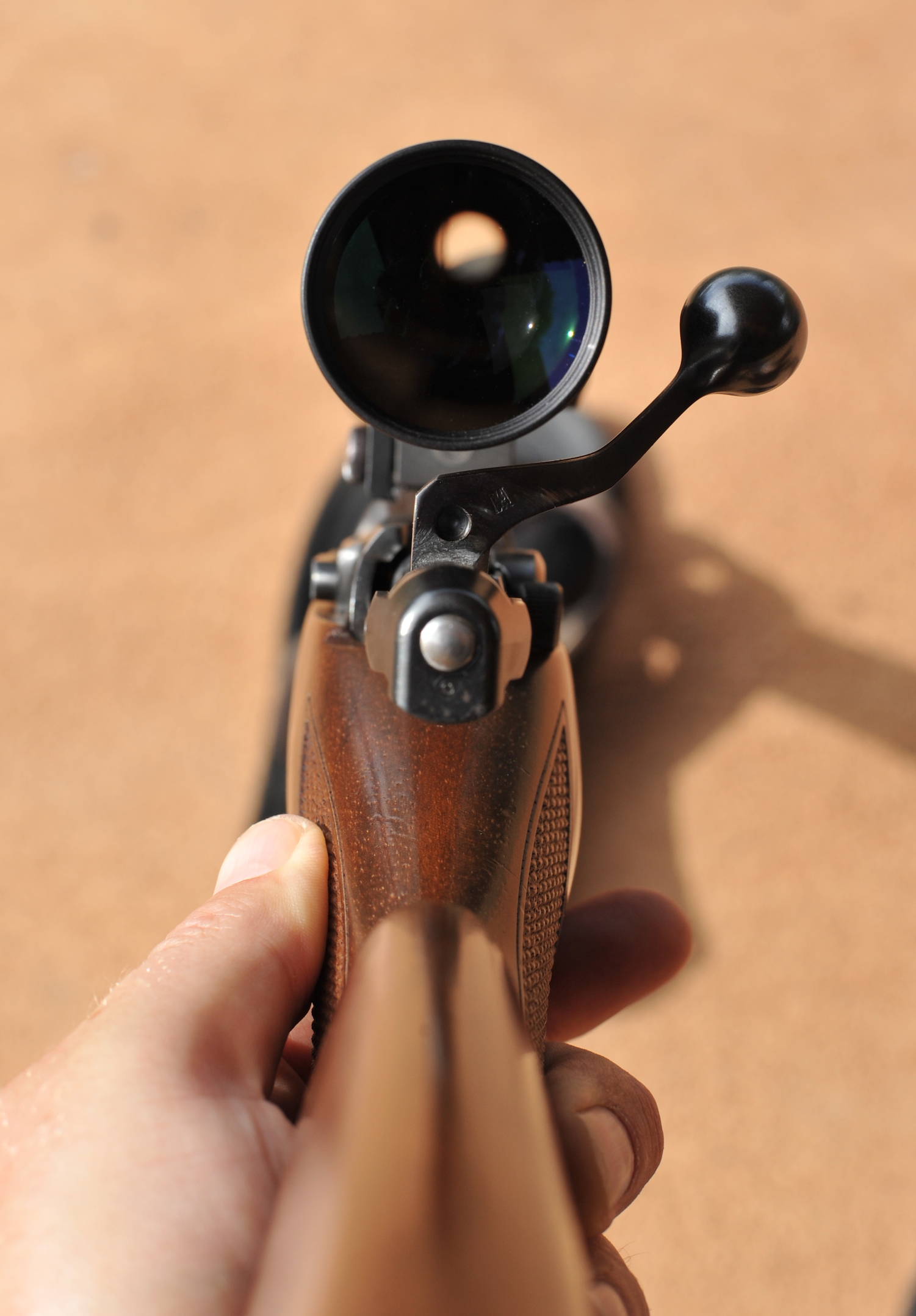

I've owned a couple of these - including a full wood version that was a lovely shooter, but ultimately made way for a Sako.
The problem is in the bolt tolerances of the Mauser design. CZs are renowned for it.
There's a lot of slop built into the action on purpose - it makes them indestructible in the field (they can be filled with dirt, mud and other muck and still keep working), but will give you grief if you do not cycle it smoothly, especially those first couple of rounds out of the mag that are tighter under spring pressure.
What happens is, as you push the bolt forward, it rocks to the side and gets caught inside the action. This is the result of not pushing the bolt forward exactly in a linear fashion. As we cycle the bolt with our right or left hand, there is a tendency to push the bolt with more pressure on one side than the other - and that is what causes it to jam. It will get a little better as the bolt wears in, but will always be there.
As a consequence, a lot of CZ 527 owners have developed a new technique where they push the bolt with their thumb directly on the back of the bolt - not on the bolt handle - to help it move forward in a straight line and not wobble to the side.
Give it a try if you can, as you will notice the difference.
Hold the bolt with your fingers, and put you thumb directly behind (silver part of bolt) and push forward - that will cure your jams.
