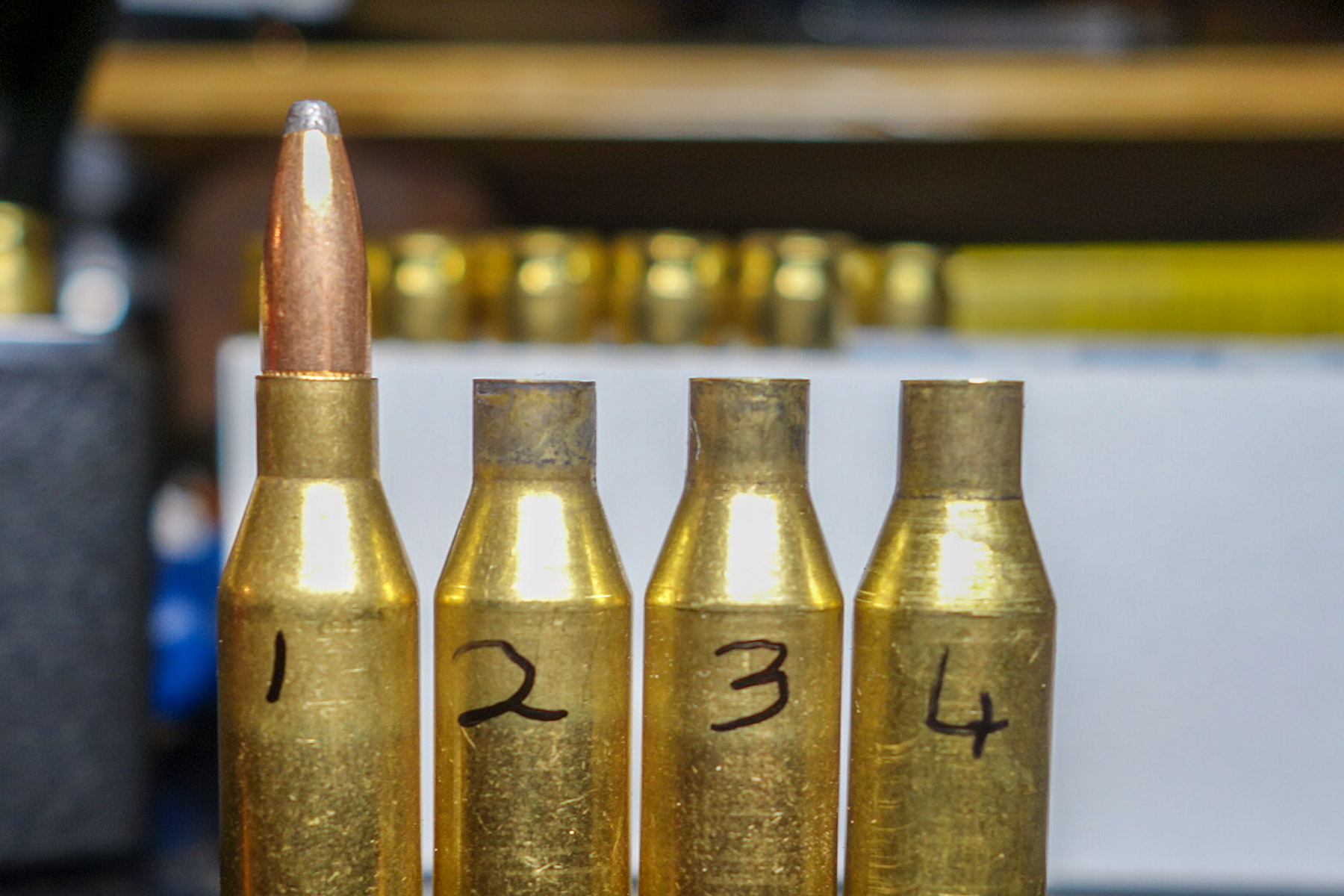

Post by Jakethefake » 07 Sep 2020, 8:51 pm
I think the problem is more with the PPU brass than anything else. The reloads that I have fired in the rifle and full length resized chamber fine. I'll neck size those ones from this point on.
I took a picture of a few cases.
1. Unfired factory PPU. A bit stiff to close the bolt.
2. Fired factory PPU. Chambers easily.
3. Fired and full length sized PPU. Very difficult to chamber.
4. Winchester case from one of my reloads. Has been full length sized and chambers easily.
3 and 4 are longer but still within spec. I'll probably trim them anyway.
The PPU cases seem to have a longer shoulder and a shorter neck than the winchester and others.
Full length sizing the PPU appears to have brought the shoulder forward even further.
I think the solution for now will be to only neck size the PPU brass.

Post by marksman » 08 Sep 2020, 10:40 am
they do not look to me like they are mushrooming at all
l have seen in the past that PPU cases will be tight on first firing in good tight chambers, eg... tikka chambers, l think you have a good tight chamber
but after first firing the PPU cases are ok because they will form down to the chamber shape
l can clearly see what is happening after you size the case, its has bought the shoulder forward like you say
why its happening is that the PPU cases are thicker so as the case is being sized the extra brass is being pushed forward filling the die, the winchester cases not having as much brass are just sizing down
l assume the die was setup the same so l think just sizing the neck would be the go as well, PPU cases are a good case
you can use this die for neck sizing by putting a washer between the bottom of the die and the shell holder when you set the die up and do not lock the die, let it wobble
