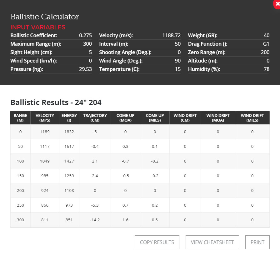

Post by in2anity » 08 Oct 2020, 12:02 pm
animalpest wrote:But you don't get a .204 for its laser like ballistics to use as a scrub gun.
Generally speaking no, but it's all relative isn't it? A 204 carbine will still shoot measurably flatter than a similar length 223 carbine. Let's take an extreme example, i.e. going to the shortest legal end of the spectrum.
In a 223, going from a 24" to a 16" sees around a 300fps reduction in velocity, i.e. approx 3200fps down to 2900fps, for arguments sake let's call it a 10% reduction in velocity.
Apply roughly the same reduction to the 204 shooting 40grainers at 3900fps out of a 24". Rounding off, a 10% reduction yields approx 3500fps.
Now, presuming i'm sorta correct, plug that into your computer of choice.
Out of the 24", with a 200m zero, it'll print 2.5cm high at 100-150m.
204 Ruger, 24" barrel, 40gr VMAX

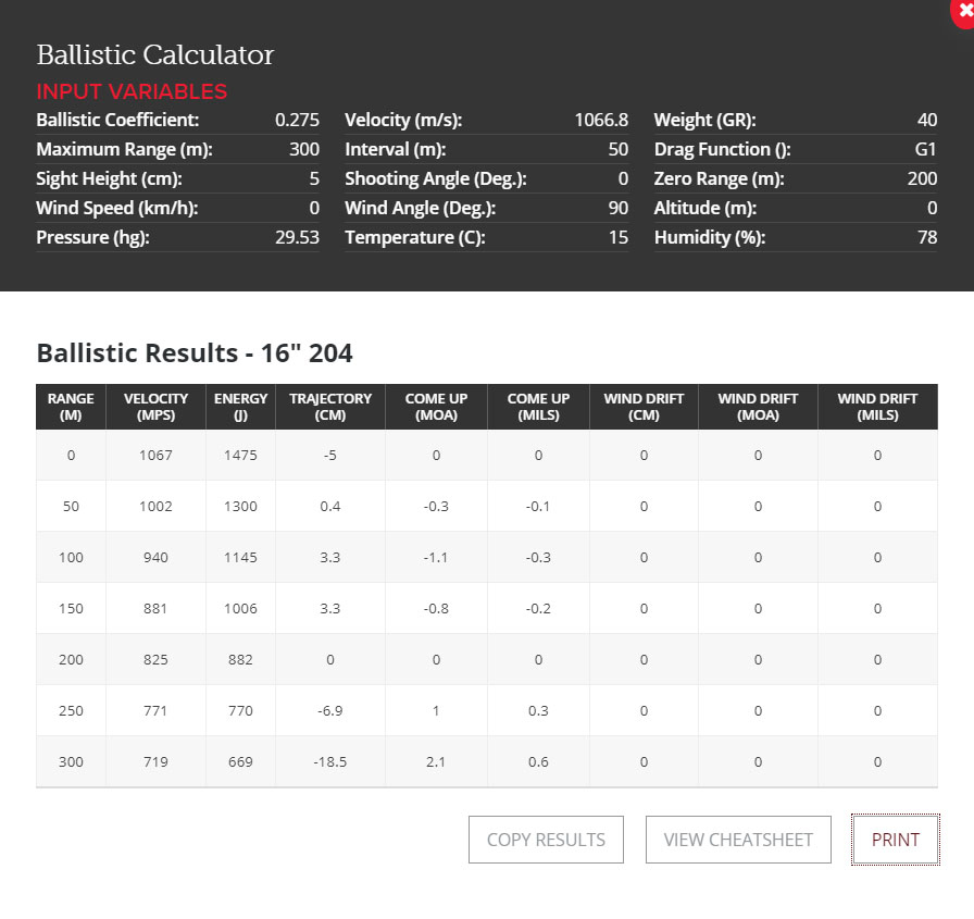

Now, out of a 16" carbine, with a 200m zero, instead, it'll print 3.3cm high at 100-150m:
204 Ruger, 16" barrel, 40gr VMAX
Comparing the two, that's a difference of less than 1cm at the peak of the trajectory at 100-150m (if shots are kept under 200m). Not much considering shooter error, and any inherent inaccuracy of the rifle itself. Just sayin.
This is all highly theoretical, and there's a good chance my data is off, but it does illustrate the point that shedding a bit of length doesn't hurt as much as many hunters presume. Of course there are other factors at play, such as muzzle blast. As a "left-of-field" build a 20" 204 might be a good compromise length :unknown:

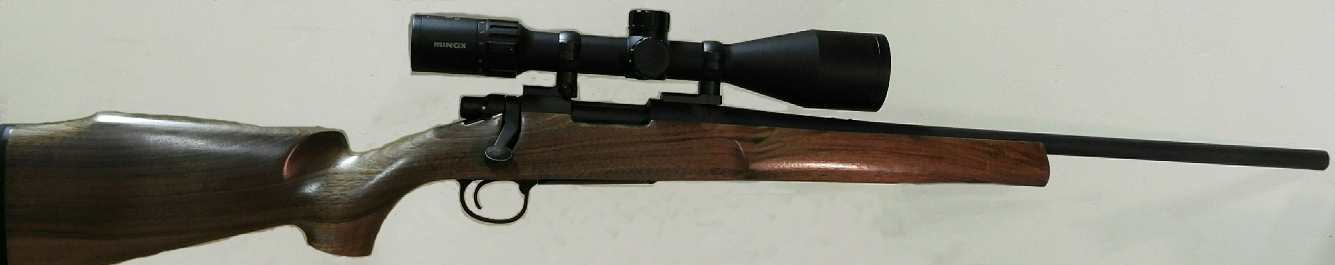

Post by madang55 » 08 Oct 2020, 1:30 pm
This is the current rifle in original 223 sport wt barrel. It can shoot, but as I said I have a 2nd 223, a CZ 527 Ltd Ed with a faster twist and heavier barrel. The Rem was always going to be re-built. Just had to choose into what. Thank you for the info on barrel lengths and velocities etc. It makes a big difference when you can get calm, informed info

looking at the style of stock you are using you have plenty of forearm so should be able to open up the barrel channel to suit a heavier barrel
do you know who made the stock?

Post by madang55 » 08 Oct 2020, 5:41 pm
marksman wrote:looking forward to see the results of this build, l have not used any of swans barrels or his work myself and am interested in what it will be like
l have heard good and bad reports about them but you will hear the same about any maker
l thought there would be more people posting up with their experiences about the swan barrels eg... BR has had a few and from memory was pretty happy
I have a "thing" about plastic stocks. So I searched around and was told to give a guy called Ken Noye a go.
He usually does bench-rest work etc and I was not given much chance, the worst he could say was sorry, no. But, I must have caught him at a weak moment. He fitted the recoil pad and did the bedding. The stock wasn't finished so I did that. I used very fine paper and finished with 0000 wool, then applied about 7 coats of "wipe on poly", 0000 in between each coat. Its due for a touch up, but I will do that after the re-barrel. It's based on a Sako Varmint profile I think. He even lengthened the stock to fit my gorilla reach. Very happy.
My wife knows me well.
madang55
Posts: 451
Re: 204 Ruger
Post by marksman » 08 Oct 2020, 7:00 pm
l actually thought it was a walnut copy of the rem VLS stock? the sako is a little more rounded in the forearm?
its a very nice stock, it would be a good one for steady shooting IMHO and well worth doing a build on
