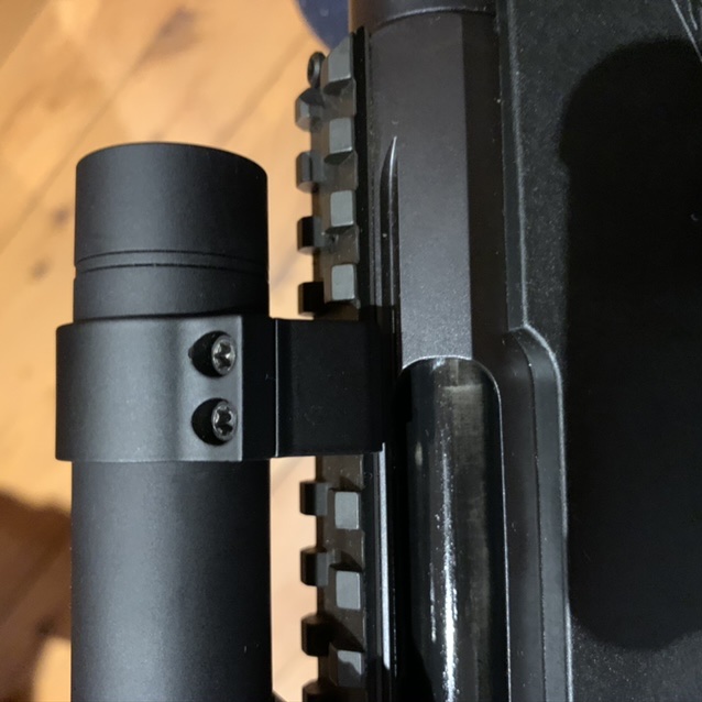

I never had a tikka , prob never held one either. But I’m surprised to hear it has dovetails in the reciever...I tend to think of dovetails as something for 22 rifles or air rifles. I just did a quick you tube and I saw the top of the reciever is drilled and tapped. If it were me , I would consider a full Notched pic rail , Or a set of bases For rings to attach to. I pretty much have pic rails on all my rifles. It’s much easier Then for me to attach a thermal scope or a conventional scope And the rail just stays On there Permanently no matter what I’m doing

I do currently own "LEUPOLD RIFLEMAN 1" RINGS" which are compatible with my scope they just dont fit straight onto the dovetail so im thinking I actually need a pic rail. Would you mind if I send you a message asking some questions Blr?

Mount the pic rail, then use lower rings. Very common setup. The pic rail opens a tonne of doors for you.

Full rail gives you many slots to choose from , and the available spaces on your Scope tube at both ends gives a Good range of movement allowing you to set up eye relief that accommodates your most likely shooting positions , remembering it’s nice to have a millimetre or more clearance between your barrel and the fat part of your scope ( I might also call that the objective lense Or the bell house ing if I had more confidence in my ability to use the correct terminology ) .....bulky scope knobs on the right hand side of the scope can Sometimes possibly interfere with your ability to get your fingers into the action when u need to
