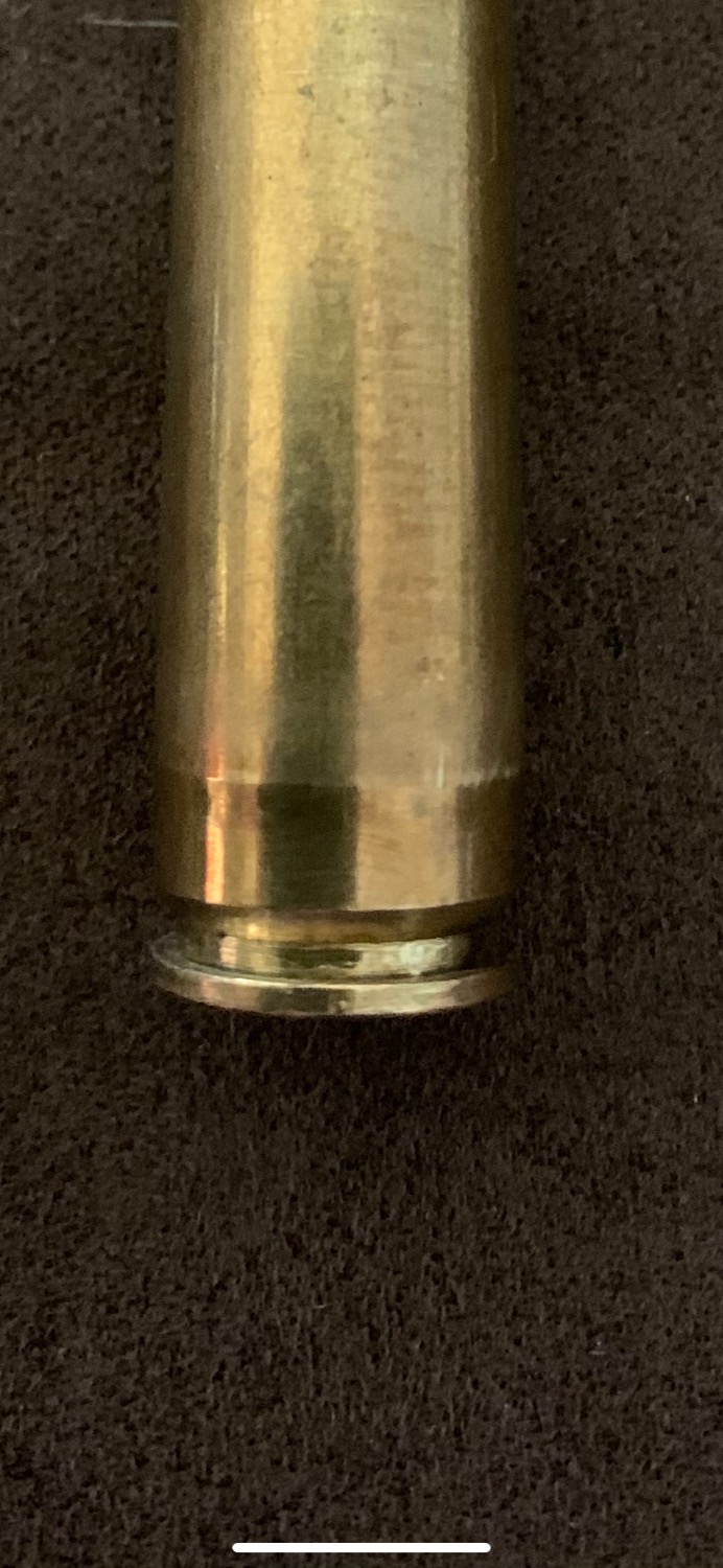

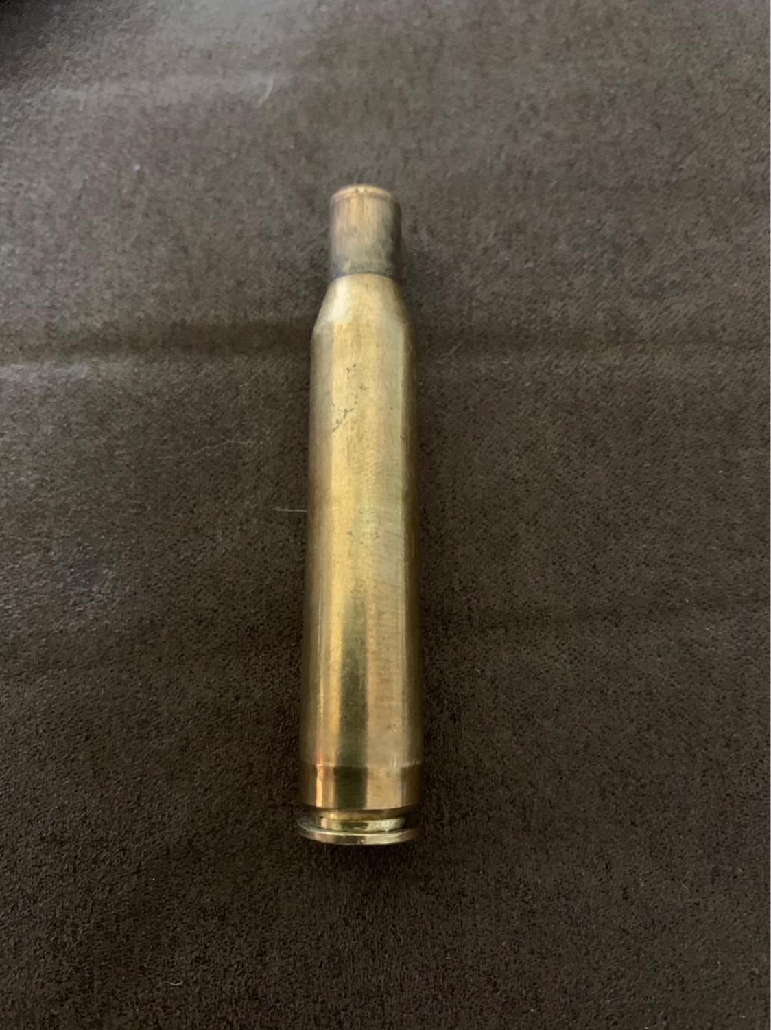

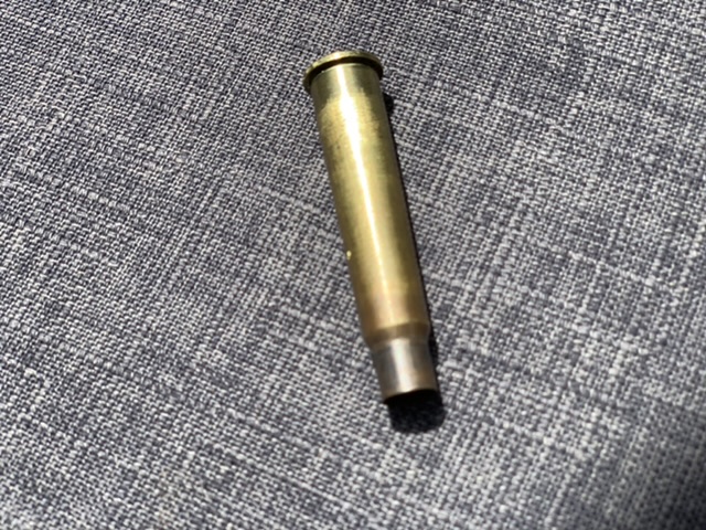

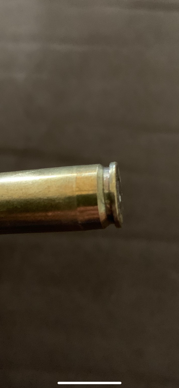

Post by JimTom » 07 Nov 2020, 5:39 pm
G’day Gents
Fired a few rounds out of a mates rifle the other day at the range and noticed this band around the bottom of the case, which coincides with a slight deformity commensurate with what I would think is impending case separation. Rifle is quite old circa 35years, and exhibits all the signs of being used . Brass is of an unknown age and number of firings.
Headspace issue perhaps?
Over to the brains trust for discussion.

Post by Strikey » 07 Nov 2020, 6:14 pm
They're the marks from the FLS die and can probably use a bit more lube when sizing.

That looks like the bottom of the FLS die, not separation.
If the brass is fire-formed to the chamber headspace won't matter, as long as you are not sizing it right back to OEM spec.

That is caused by a sloppy factory chamber that is the intersection of the case wall and the web part of the case nothing to worry about but if you keep full length sizing you're going to run into trouble .

its a sloppy sammi chamber :thumbsup:
the chamber is bigger in diameter than the case is
the problem he will have is that when using cases that are thicker on one side than the other, the thinner side will have more bulge making the case offset in the chamber so the bullet will not be in line with the bore causing inaccuracy from shot to shot
your mate would do well to use some PPU brass as its made a tiny bit larger in diameter and to check for lopsidedness in the case after firing in his chamber then only neck sizing the case to keep consistency
or FLSing and reloading with the bullet jammed so the bullet starts off in line with the bore :unknown:
this is more common in older rifle chambers than people realise but is not dangerous just inconsistent

It’s where the chamber ends, making way for the bolt. Very common in old service rifles. Eventually the case will fail with head separation, you should aim to chuck em before that point. Still, case head separation on the mound is common - there are tools designed for extracting a separated case. I haven’t had too much personal experience behind old mausers, but fwiw 303s also exhibit this strongly. The case starts to bulge at that fail line after many reloads, especially if you are FLSing all the time. That’s why neck sizing is very popular among service rifle shooters.
Moral of the story, if you want to squeeze the most out of your brass, avoid FLSing as much as you can. Do the paper clip trick to determine the condition of your brass.

funny enough l have a barrel off a parker hale M98 so l can show you guys that the case fits up to the extractor rim on a mauser 98
remingtons dont they have +/ .150" of the case head out of the chamber, that's why they have to have the 3 rings of steel they glorify in advertising
mauser 98 dont need the three rings of steel
for a case head separation to happen the case brass moves forward when fired until it thins out enough to snap off at the web, brass only moves one way when fired
in the case of this one the cases are bulged from a larger sammi spec chamber and until the brass has moved forward it will be safe to use
this is a very common thing in factory sammi spec chambers
and if you have a good look at the 3rd photo JT has posted up you will see it looks to be bulged more on the bottom of the case than the top of where the bulge is happening that will cause the case to be offset in the chamber :drinks:

Post by pomemax » 08 Nov 2020, 1:41 pm
Do you have any rounds that were not fired and were the marks on them . to me First impression was FLD not caming over

Post by JimTom » 08 Nov 2020, 10:33 pm
pomemax wrote:Do you have any rounds that were not fired and were the marks on them . to me First impression was FLD not caming over
Mate I fired some brand new factory loads this arvo and the cases are exactly the same, so not related to FLS. At least I have ruled that out so one step closer.

Post by GojiraSteve » 09 Nov 2020, 7:57 am
I have seen it almost universally on unfired S&B 100gn .243 ammo, and here and there on other stuff. Best guess so far is that the brass is annealed to that line as part of the manufacturing process (and then presumably re-tempered). But neither me, nor the bloke who made that guess are any kind of expert.
Pre-firing it seems to be more apparent/visible on rounds that have started to tarnish a bit in the box. But tarnished or shiny its really obvious once they've gone bang.

l just saw this photo which l will attach that shows the bulge that l am talking about, with a yellow line pointing to and the mark of a head case separation ring forming with a red arrow pointing at it showing the headcase separation is very apparent from the inside of the case but not the outside because the outside of the case will form to the chamber , l thought it might add to this thread to show it :drinks:
